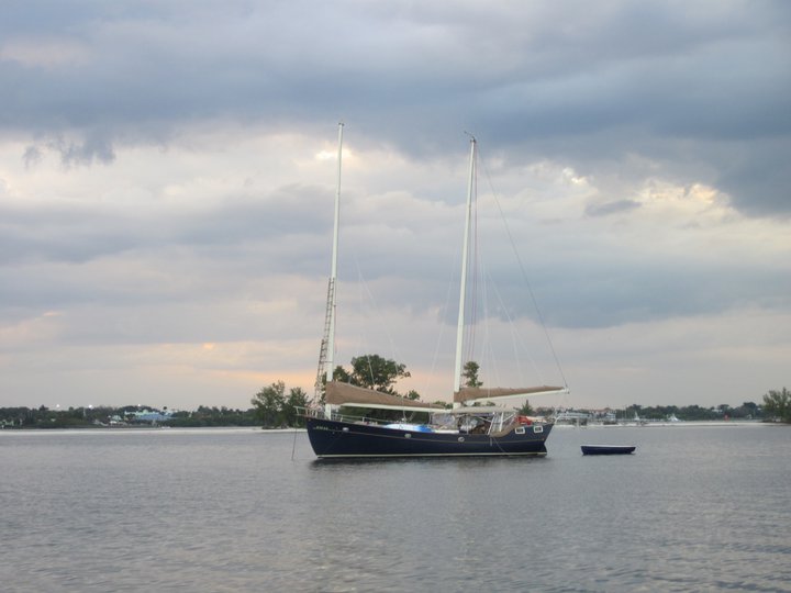

I screwed up and lost both our halyards off of the main mast. Looking at the bare pole I actually investigated the tie-your-feet-together style of climbing coconut trees… briefly. I borrowed a 24 foot extension ladder that is lashed down to the sprit and lashed laterally to the mast. While standing near the top of this arrangement I’m less than 30 feet from the masthead and have two 15 foot boathooks duct tapped together with a clip at the end. I have a drill bit taped to some string that I’m trying to fish into the pulley up there. So far, wind has kept me from success. I’ve had the drill bit into the slot, then pulled down on the pole to release it but unfortunately this tilted the bit down on the string end and that caused it to simply fall back out. :confused: Once the wind calms again, I’ll give it another shot, this time with the clip arranged for an upward motion release. Wish me luck.
All this is my long way of wishing I had mast steps. But it has also born some interesting design notes for steps that can be deployed and retrieved, even on masts such as ours, without drilling a hole. Unfortunately we are far from my shop. Maybe this spring I’ll have some show and tell for the group.

I had the drill bit into it again this morning, but couldn’t get the release right. Next calm, I might just put a loop of webbing up there with another block on it that has a line through it already and hoist my self up the rest of the way. I still have plenty of other stuff going on so I’m only working at this when it’s calm and then only taking a couple tries at it so I don’t get too aggravated.

Ah, Gotcha Phil,
Well, my way worked today finally. I had a calm 15 minutes this evening and was able to perform the nautical version of pin the tail on the donkey.
Sorry to take the thread so far afield. I am still very interested in the original question and possible solutions.
George
