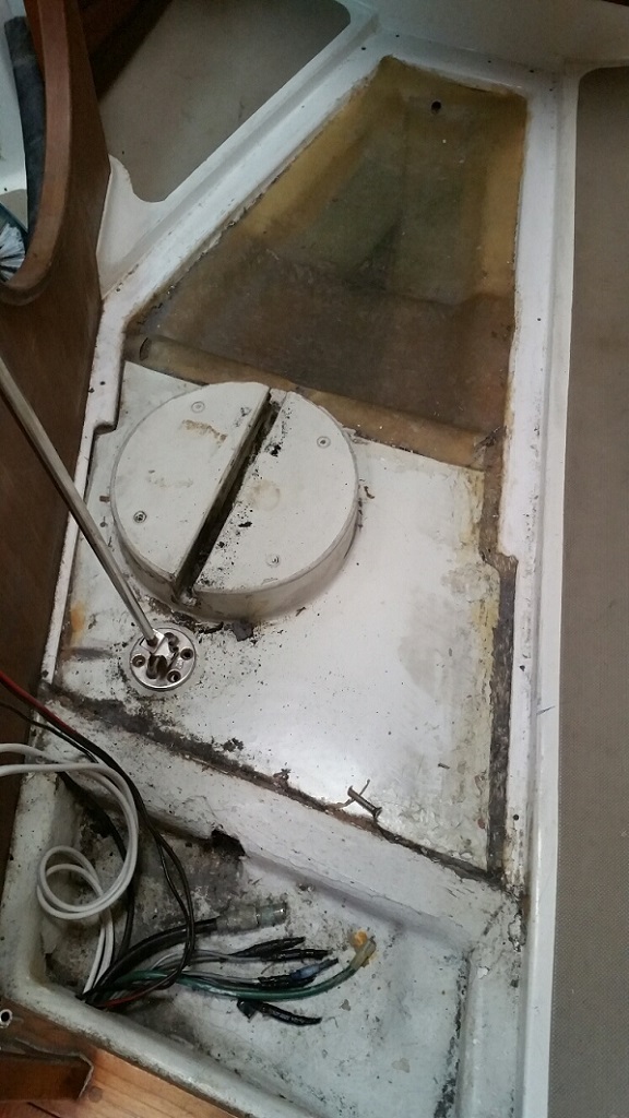

Upon re-installation this spring they are concerned about a small gap between bottom of mast and the mast step. You can just get the edge of a fingertip in between, less than 1/8th of an inch. They tried repeatedly to get it to seat fully without success. The bolt did install properly.

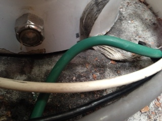

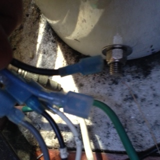

Top photo below with wires connected (IMG_1590) is how the original yard installed it last year. Clearer photo (IMG_1973) is how it looks now. Both images are looking down the mast towards the step.

Bob, even though the gap is toward the bow and seems counter intuitive (to me anyway), I am pretty sure this is the channel for the drain if water comes down from inside the mast although that area looks a bit different than in my F38. There’s a drain tube running underneath the top hat and this seems to be the only way for the water to go. It can’t go aft of the mast because there’s a “dam” built on that step where the wires are located. And speaking of those wires, I’m going to be routing them to a junction box adjacent to and above from where they exit the mast and then above the door and around the side rather than through the bilge because wires + water = not such a great idea…

Thanks, Gamayun.
Your theory makes sense, the water needs a way to escape.
I agree the wires in the bilge is not ideal. I never get any water standing in this section which tells me my mast must be pretty well sealed up, and/or it drains rapidly aft.
Thanks for your input.
