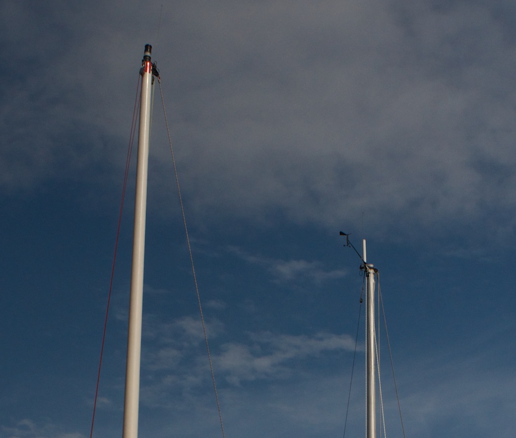

Rather poor quality picture of the mast heads on Castaway; it’s cropped from a nice picture of the whole boat moored up. As you can see, the wind instruments (B&G) project forward of the mizzen, about 4m (12 feet+) aft of the leech of the main at that height, so there is little effect of the mainsail on them. The mizzen also carries the radar transponder and a spare VHF antenna; used for AIS. They are below the line of the masthead lights, unless you are close up astern.
