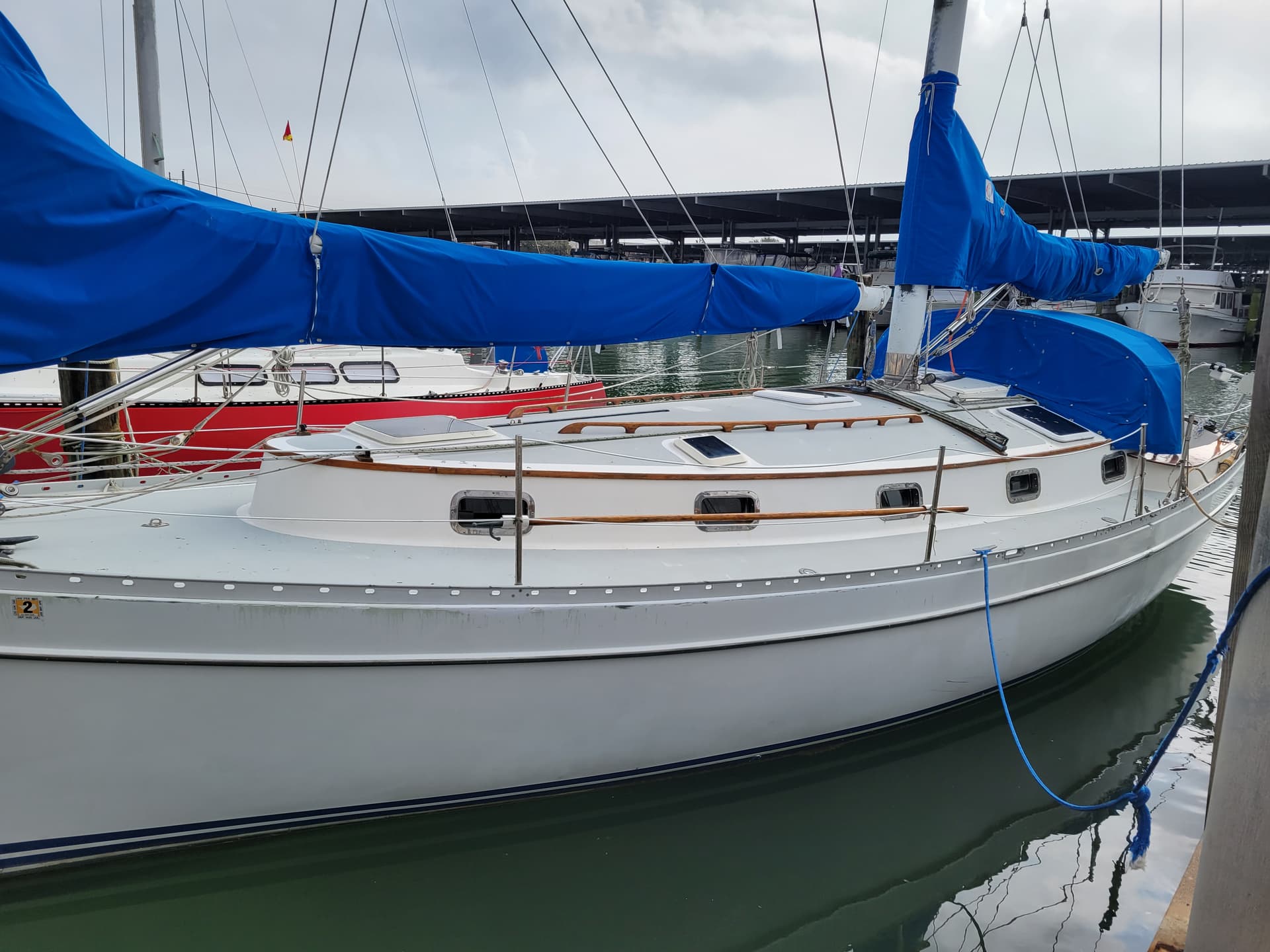

Thank you for all the responses. Great looking boat Guero!
