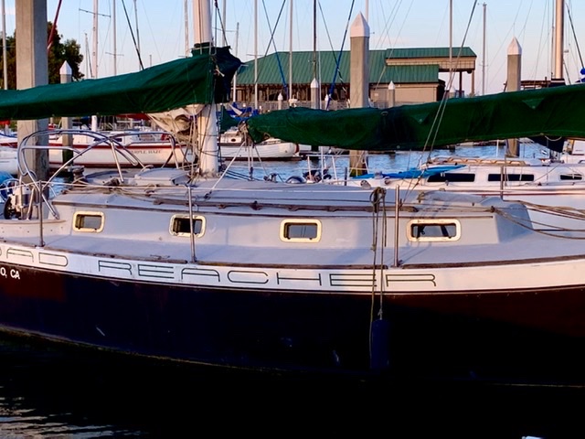

+1 on the butyl. Three rolls so far as I complete my many-month port replacement. My tip: Store it in a ziploc in the fridge and bring it to the boat in a cooler with a cold pack. It’s gets hard to work with when it’s warm.
I notice I get additional turns on the mounting screws for my ports almost every time I go to the boat. Stuff definitely works it’s way in. Not a speck of leakage.
RE The boat: Not pretty, I know. But she’s getting there (very) slowly. Now that things are water tight I can do more cleaning. Teak rails arriving next week!
