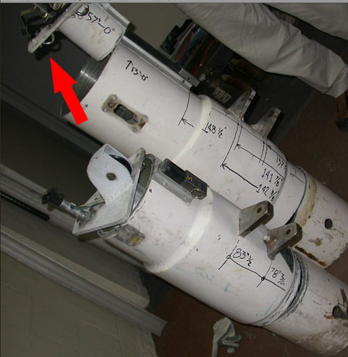

I had my 2 masts replaced on my 39PH after meeting hurricane Jane in 2005.
I measured all dimensions of the broken masts and kept the main parts to draw plans of the replacements
I asked several carbon spar builders for quotes, and Ted Van Dusen http://www.vandusenracingboats.com/spars.html had the best product and price (17.000$ for the main and 12.000$ for the forward mast). The new masts are significantly lighter than the original ones.
The construction technique is quite sophisticated when compared with the original mast: the new masts are “woven” in one piece, put in an autoclave for a while, etc. No circular cracking as on the original masts (I previously owned a F33 wich masts had circular cracks all the way up; this was strictly cosmetic… Same with the original 39PH masts)
I have more details (VISIO CAD files) if you want to join to your quote requests. if you are interested, let me know. Good luck!
