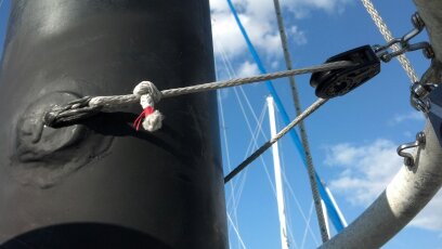

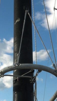

I opted to keep the wishbone rig. “Rope Eyes” made from carbon fiber pads with “Dyneema” Loops were epoxied to the carbon fiber mast to hang the booms and hold it tight to the mast.
