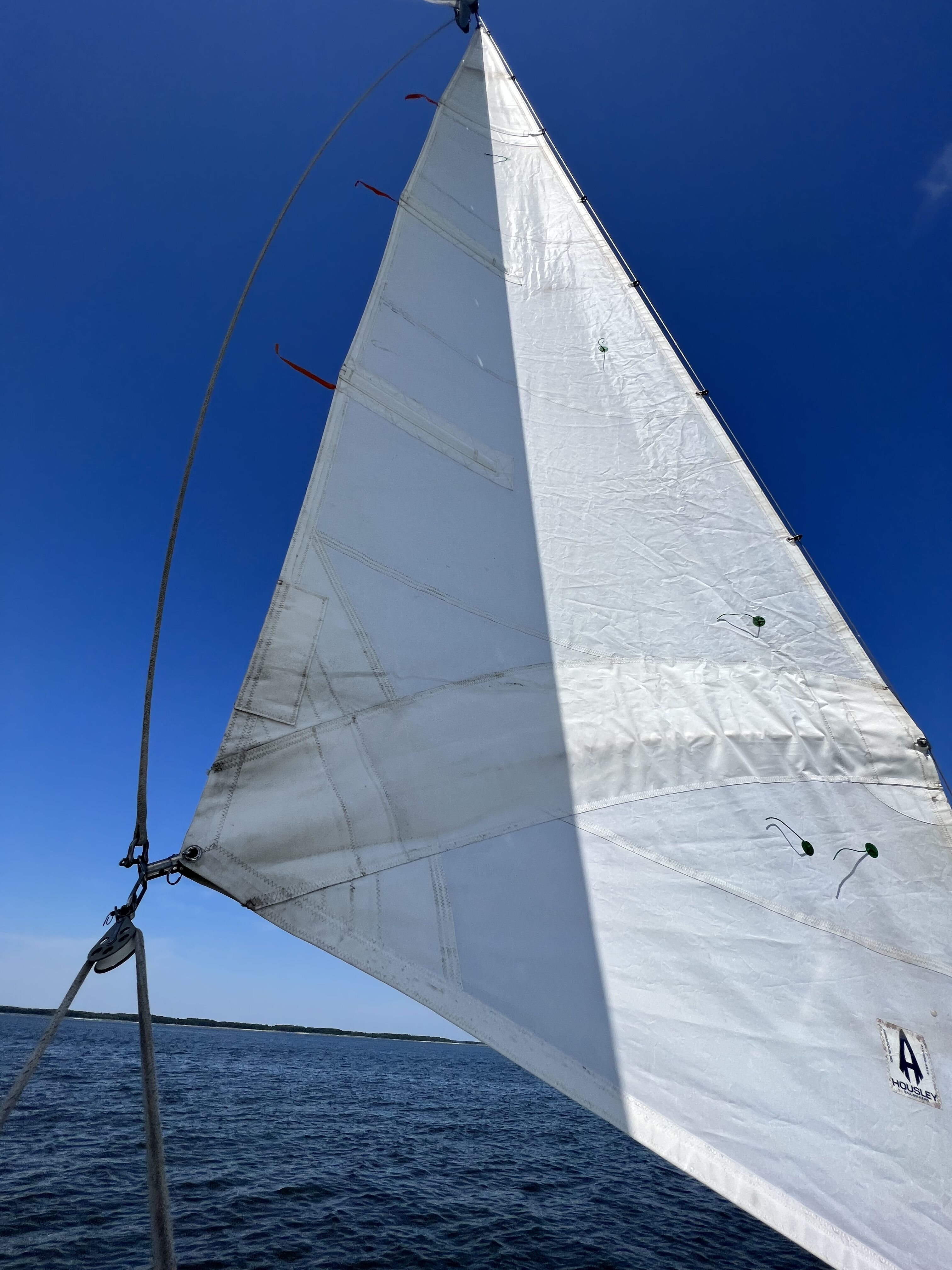

The wealth of knowledge here has been invaluable. I was given the original manuals with the boat. Unfortunately, the pages with the rigging diagrams were missing. I got the main on without issue. The prior owner never used the reefing lines. They are just tied off to the mast. His thoughts were “if it’s too windy to sail with a full main, I’ll just motor, or stay at the dock”. I’ll be dealing with those once it’s in the water. I was reluctant to raise the sail completely while the boat is on stands. I was challenged to the point of four letter words by the jib and the camber spar. I finally managed to get the grommets on the horns and wrestle the roller on the forestay.
My question for the group, and apologies if my terminology is not perfect, I’m new; is what should the camber spar be attached to at the mast? I have a spare halyard as well as a line that appears to be shackled off at the top of the mast. At present I tied a bowline in this static line to the yoke at the end of the camber spar, and the other hole in this yoke is shackled to the block, sheave, roller
on the control lines leading back to the cockpit. Is this correct, or should it be connected to the halyard? As far as I remember, this is the way it was set up last fall, but no guarantees it was correct then.
