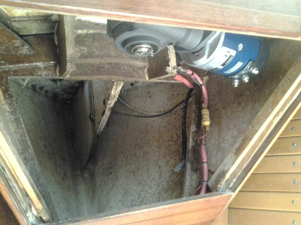

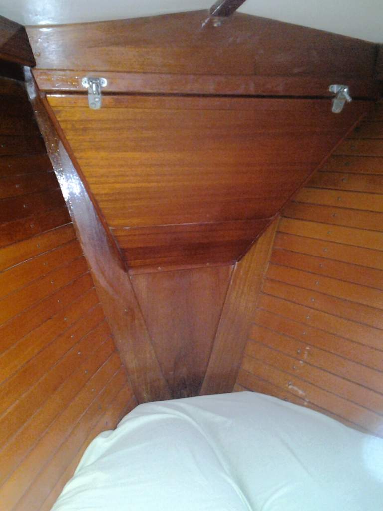

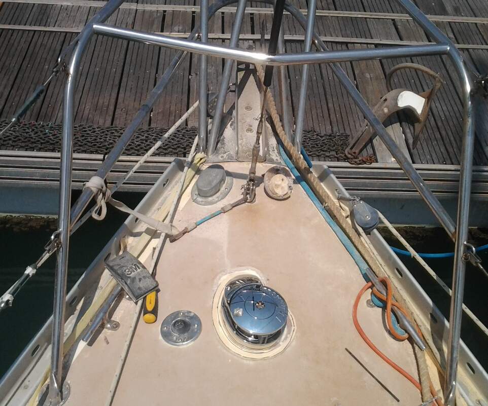

Hi all, ive just got the new Maxwell in place and to my relief it just fits ( motor has approx 5mm clearance in one spot ) the 1000w motor is larger than the 600 or 700w on my last windlass. The hardest part of the job is compensating for the curve in the deck and the slight incline, i made a polyester bog base that compensates for deck curvature and enables the windlass to mount flat. I snapped a few pictures, keep in mind the job isnt finished, tommorow i fair and paint the base. The modified locker door has a sheet metal plate attached that the chain falls on and slides down to the bottom of locker ( not always ). The locker modification dosent effect sleeping room in v berth at all. Ive been asking around and chain piling and having to be knocked down is very common even on boats with large lockers. It suprises me how many wifes have to be down stairs at the chain locker while the husband pulls the anchor up, as i regularly single hand this is unacceptable for me. I accept with my smaller locker the chain piling issue but i need to be able to solve this quickly and from up on deck. Also carrying alot chain up front is alot of weight thus one of the reasons ive decided to reduce the amount i carry but keep in mind the F32 is designed to accomodate a extra 200 litres( 50 gallons? ) optional water tank right up front under the V berth which i assume most of us dont have. In regards to the Manson Supreme i have the 25 lb. I brought it with me from my last boat. I thought about going the next size up but it has never given me a reason to. It has been tested fully over the last 3-4 years specially through Indonesia when sometimes your anchoring on the sides of volcanoes!
