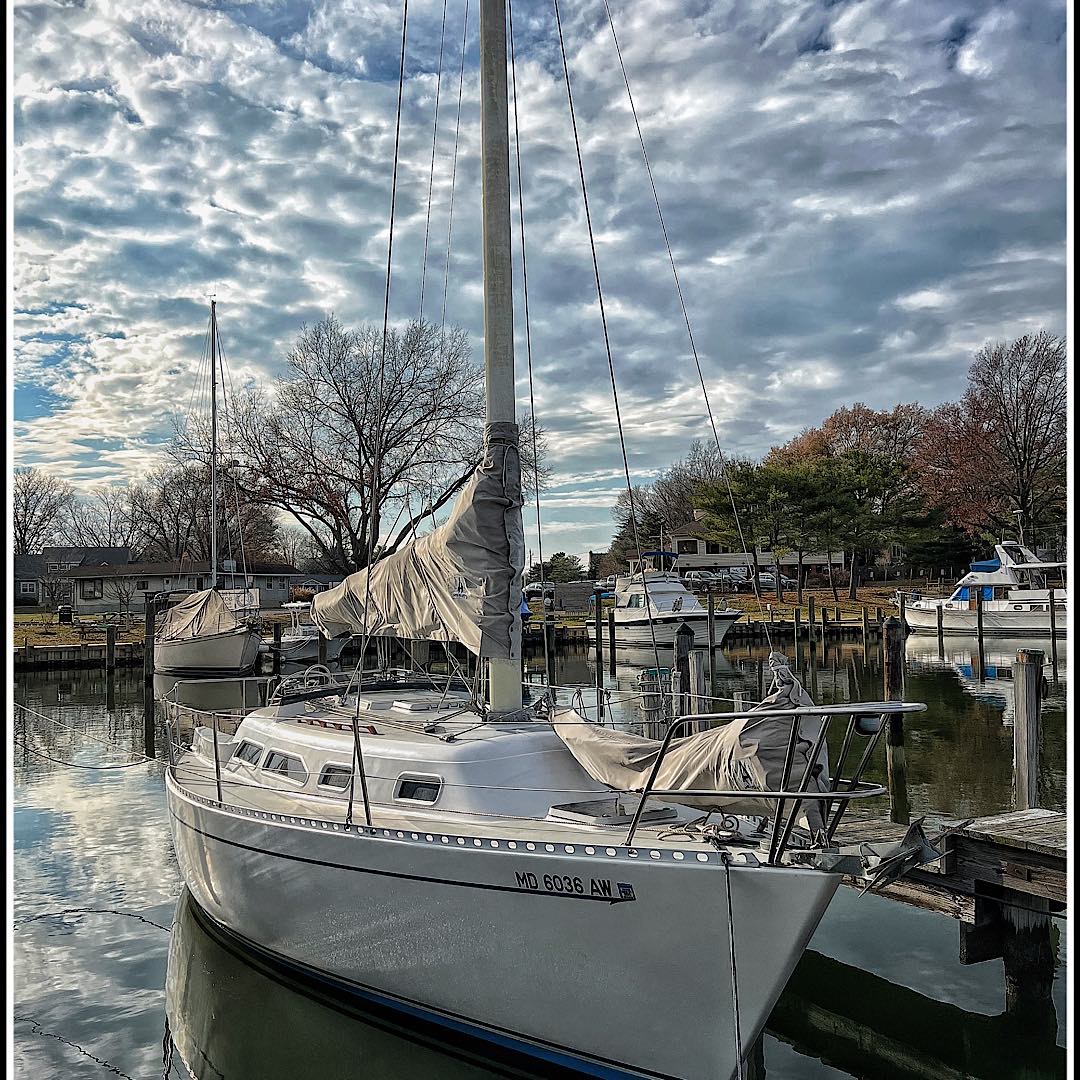

I am interested in building a sail bag for my standard F-21 Staysail. I’m thinking of a long and narrow bag attached forward at the bow pulpit near the gun mount tube running down and along the deck under where the pole runs along the lifelines and feathered to the first stantion along the port side. I would leave the sheets rigged. To fly the sail I would unzip the top of the bag along its length and leave it teathered on the deck. Launch the sail right out of the bag. Has anyone done this and do you have any diagrams, pictures, specs, etc that could help flesh out the idea. I think I would use the sail a lot more if it was on deck ready to go. I am on a mooring and want to protect the sail from UV if left rigged. Thanks.
That sounds pretty much the way many of the larger Freedoms are set up normally, although I’m not sure you really want the bag lashed to the foredeck while sailing, nor would you necessarily want it to open from the top. The camber spar does keep things more rigid and easier to bag.
