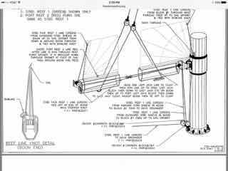

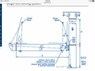

Just spent a very frustrating weekend trying to sort the reefing system, on my Freedom 35, I should have studied more and taken more photos before the Masts came down for transportation. Do you have any drawings / Photos you can share before, Would be of great help, Best regards,
John.

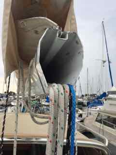

John - both drawings below are from on-line and are not exactly how my f35 P was rigged - what is not shown is the out-haul configuration - pic with the lines pouring out the boom-end shows 1 blue spectra line - I removed the original line tied to the outhauls aft block’s becket and replaced with the blue spectra. Both of my outhaul blocks could only be reached through the outhaul boom slot near the mast. It took me a long time to untie the original line and tie in the spectra to the becket, working through that little slot. My outhaul had 2 blocks - pretty sure this is how it went: forward block has one becket facing forward - line from becket secured to boom-end near the gooseneck - I could not get to that tie off point as it looked like rivets were holding the pad-eye secure point. That line is probably 6’ to the becket of the first outhaul block. Second block’s forward facing becket has line tied in and going to the sheeve in the first block, around the sheeve and back to the sheeve in the second block and then passes out the boom slot as the outhaul line. Second block has an aft facing becket where the blue spectra line is now attached going out the boom end. Does that make sense?
Pic of lines - blue is new outhaul that wil go up through boom-end sheeve to sail clew.
Black specked line is topping lift
white/green - first reef forward section of one line doubled (blocks are out so seen are both lines for each reef)
white/red - second reef forward section showing one line doubled.
Drawing with no blocks is sort of how mine will be when my lines arrive - mast end is not correct however but close enough. Plus I’m putting a small block at each reef grommet cringle to help with friction. The drawing with the reef blocks only shows one reef and does not show the outhaul at all.
