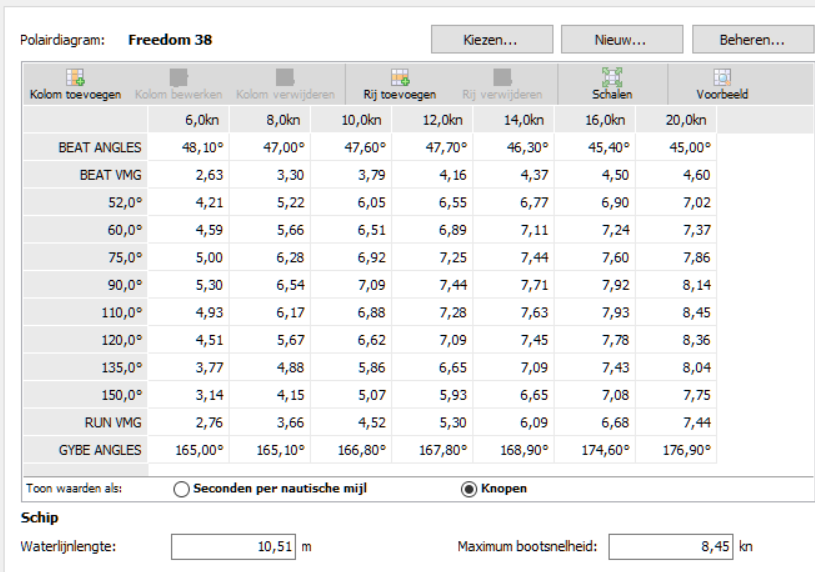

I also asked this question on a Dutch forum, and I received a reply.
So here by I would like to share it.
Unfortunately it’s only till 20 knt wind, but it’s a begin.
I created a pol file from that I will share this later with you, (or you have to created it by yourself).
