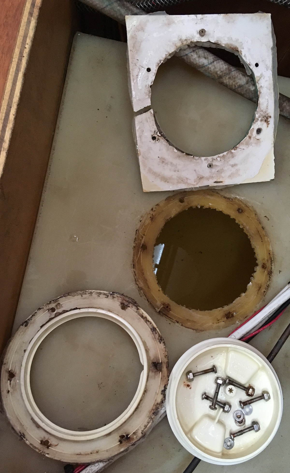

One of this winter’s projects has been to address the issue of the inspection port on the fresh water tank leaking water from inside the tank to the outside. Whenever I over-fill the tank or the boat heals excessively the factory installed inspection port leaks around the ring and possibly around the cap. A lot. The problem is twofold. First it is hard to get any kind of adhesive to bond to polyethylene and the second is the top of the tank can flex causing any actual sealing of the ring to the tank to only be only temporary. I am also not convinced the screw in cap with it’s very thin sealing ring can actually hold water in the tank when under load. This is what I found when I removed the old inspection port. Cap, Ring and fiberglass backing ring from inside the tank that the screws bite into. The backing ring ceased being flat many years ago.

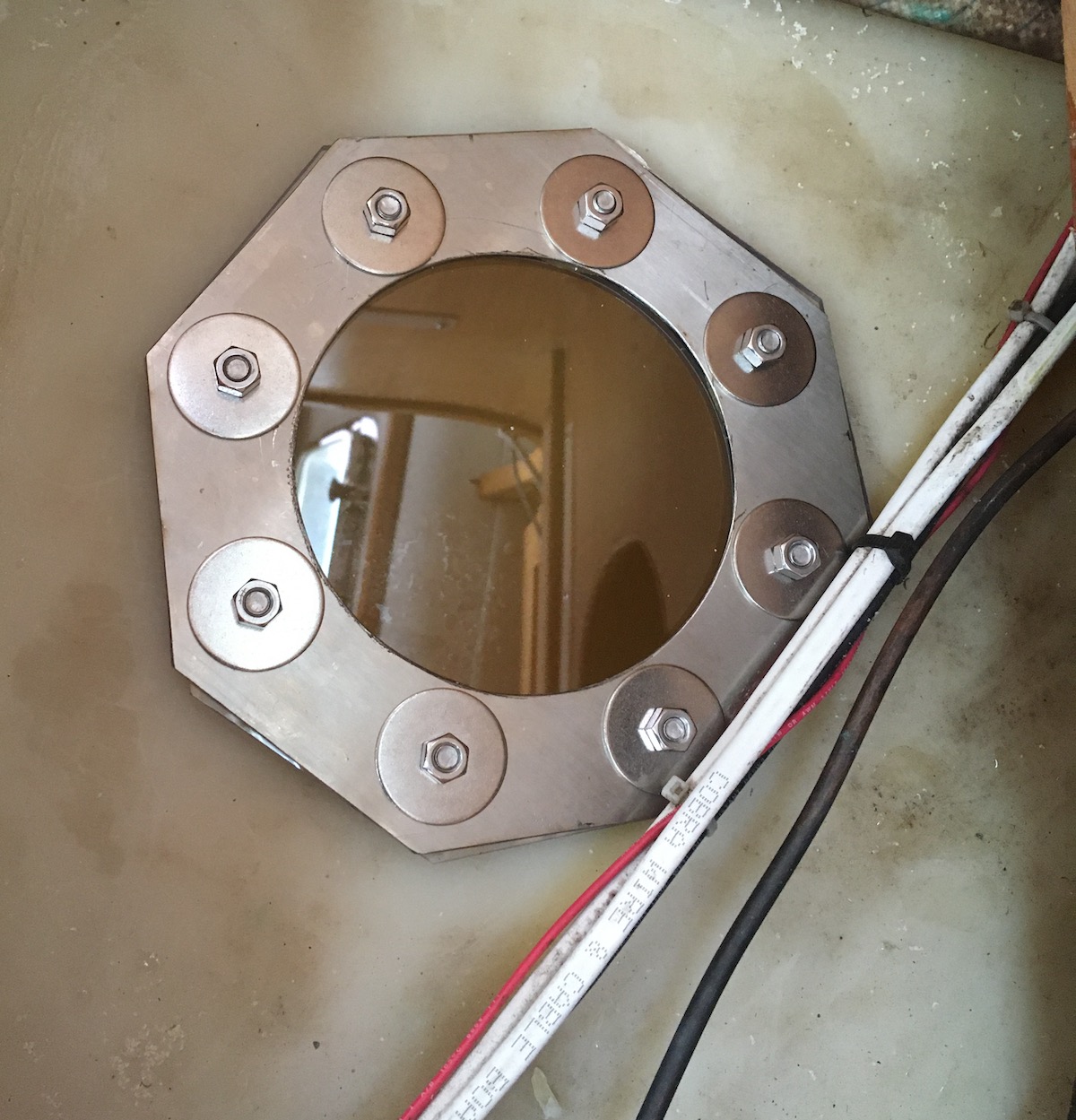

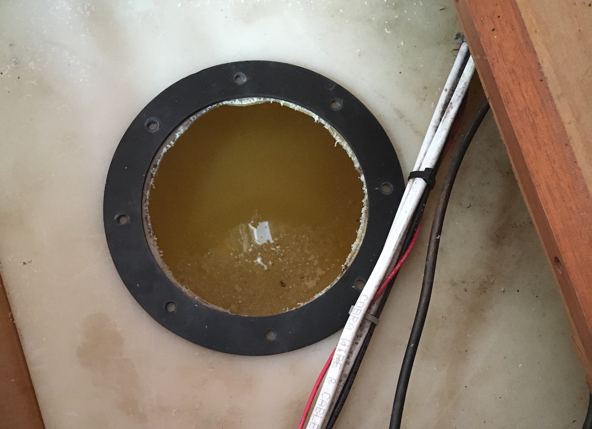

I installed a Sea Built stainless steel inspection port. It consists of 8 studs on inside ring and inner black gasket. I enlarged the hole in the tank and drilled the holes for the studs. I then installed the outer gasket which sits on the top of the tank and is tight around the studs holding the assembly in place.
The inspection port comes with a heavy stainless steel round cover which I used as a drilling template to make an octagonal Lexan cover and I also made a thin topping plate out of some stainless sheet metal I had with a big hole cut in the center. This clear cover allows me to check my water level and clarity without having to take the lid off. I secured it with stainless fender washers and stainless nuts.
So now the inspection port is has a double gasket (inside and the outside) and the top of the tank is sandwiched between the gaskets. I am sure this will be the end of my leaking problem. I can still remove the nuts and the clear Lexan cove to clean the tank when needed.
Overkill? Yes. Problem solved? Oh yeah!
