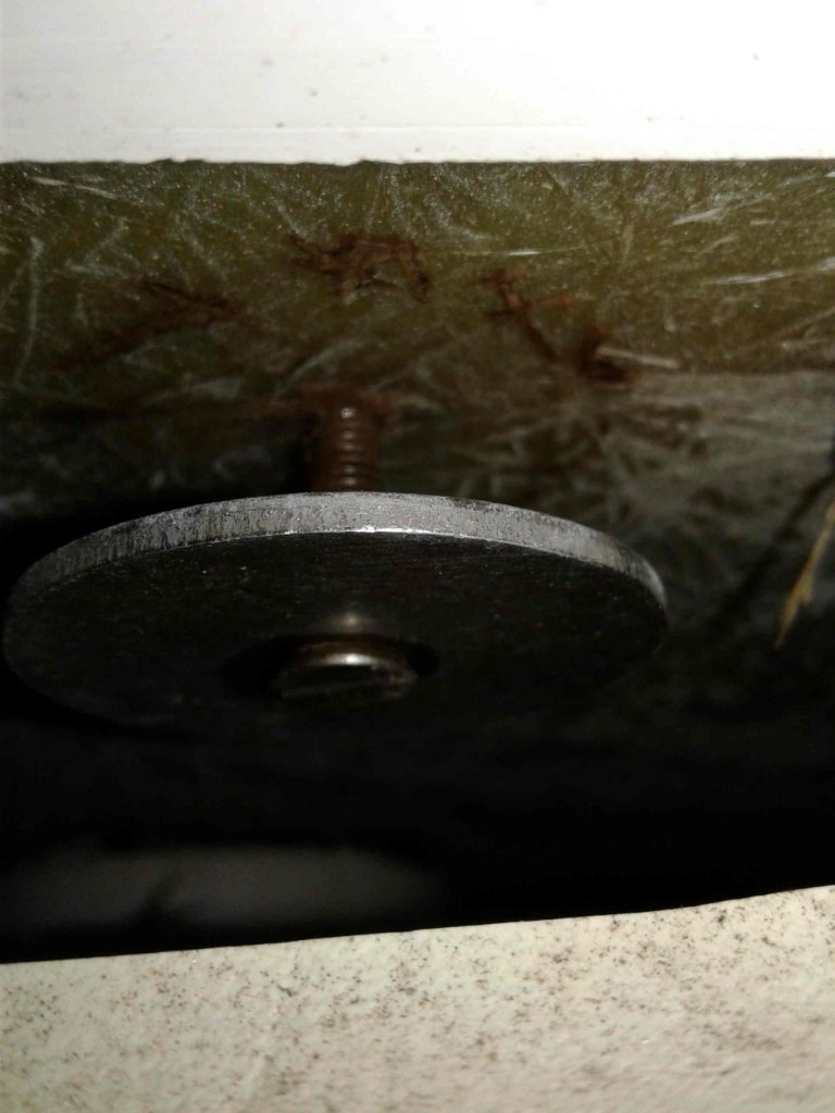

Weird asked about the handrail in the pic (did not get to making new thread). One bolt had a rust trail going down the cabin top. Pulled the rail and the bolt looked fine. Cleaned up the rail, varnished, placed back on and the bolt snapped at the base inside. It was rusted at one spot that I could not see down in the hole drilled in the fiberglass. So replaced that and we redo the rail tomorrow. Here’s what the back of those rail bolts look like (Weird asked) taken from up under the liner inside the cabin.

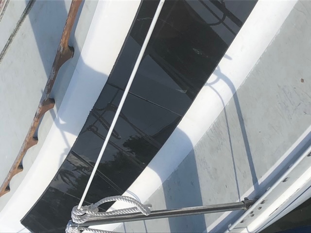

Tired of leaked, this is what we did…took a lot of work, about $2K
Looks great, zero leaks after a year. Glass. Zero holes. Way better optics, durable, and nice look.

That continuous window looks a lot different. I think I like it. Looks like you ran the plexiglass over the fiberglass in the middle. I don’t understand how you got it to fit into the window openings and yet overlaid the fiberglass in the middle? Did you cut out the fiberglass in the middle? Thanks
I haven’t pulled mine yet but i believe on the 32’s at least the widows sit proud of the fibreglass. There would be no difference it the levels. It’s a nice clean look. What adhesive was used to attach the glass?
In addition to what adhesive was used I would ask how did you “clamp it” to get it to have minimal if any gaps/good adherence. I haven’t pulled my windows. At least one side was done prior to my ownership. One side is clear the other is hazy. Neither leak. Just following. Thanks,
Wow…They used the strips of adhesive mentioned by others on this site. Looked like sticks of gum.
They said it just wont let go, then filled to the edges with 4200. I didn’t see how they clamped it but the guy said they used wood braces off the toe rail, life line and hand rail for tension. They filled all of the screw holes.
After a few weeks, they came back and filled in the rest making it flush to the edge of the glass with black caulking…I will check to see what they used. No more leaks!!! Wish I were there when they did it, but it took a couple of weeks of removing, prepping, paining, fixing to the hull, then finishing. Work beckons in the Bay Area. I think the glass was about $1K.
Since the outside of the boat is flush (not raised), they just used three pieces of glass to cover the sections in the middle with very small seams for expansion. No need to cut any fiberglass in middle.
They sanded and repainted on edges, but roughed it up in the right areas to get good seal.
At first I wasn’t sure I liked the look of the long, singular window, but it has grown on me.
BTW…it is glass, not plexi. Dark smoked color. Amazingly clearer than the faded lexan. Now I need to put the damn blinds back up.

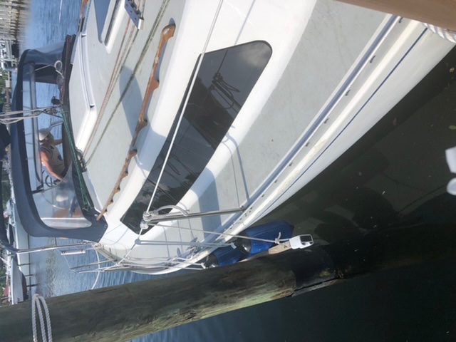

BTW if not too much trouble, post a photo showing the boat with the new windows so we can get an appreciation of the change. Thanks,
Posted some pics above…having trouble attaching photos again. :frowning:
Scott - I’m very late getting back to this but your windows look fantastic! I’m sure that the glass will perform better. Thanks for posting pics.
