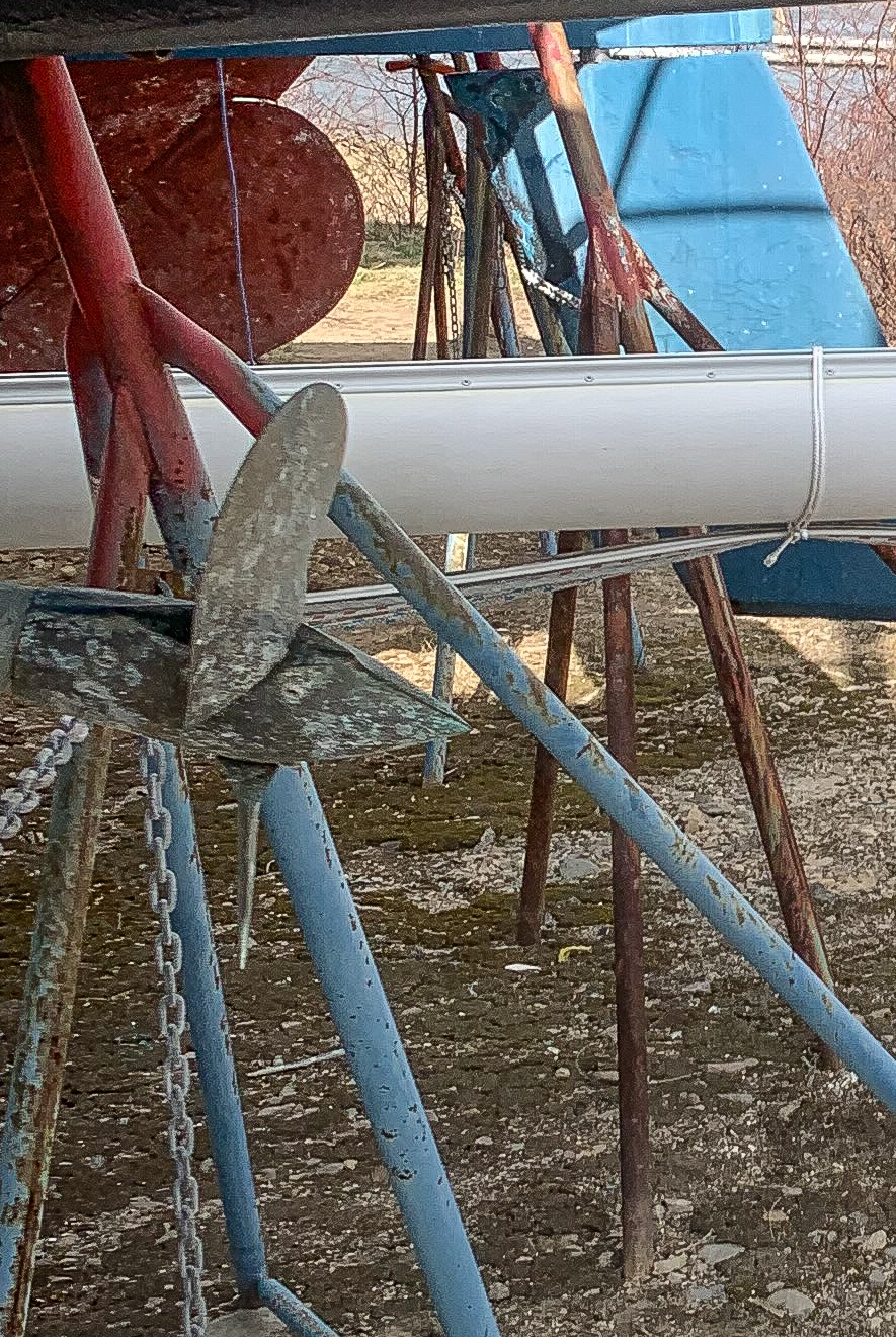

Any opinions on the matter would be greatly appreciated, as well as what the gear reduction ration is on a 1987 28M. And if anyone can tell from the photo what brand of prop I currently have.
I believe that’s a MaxProp.

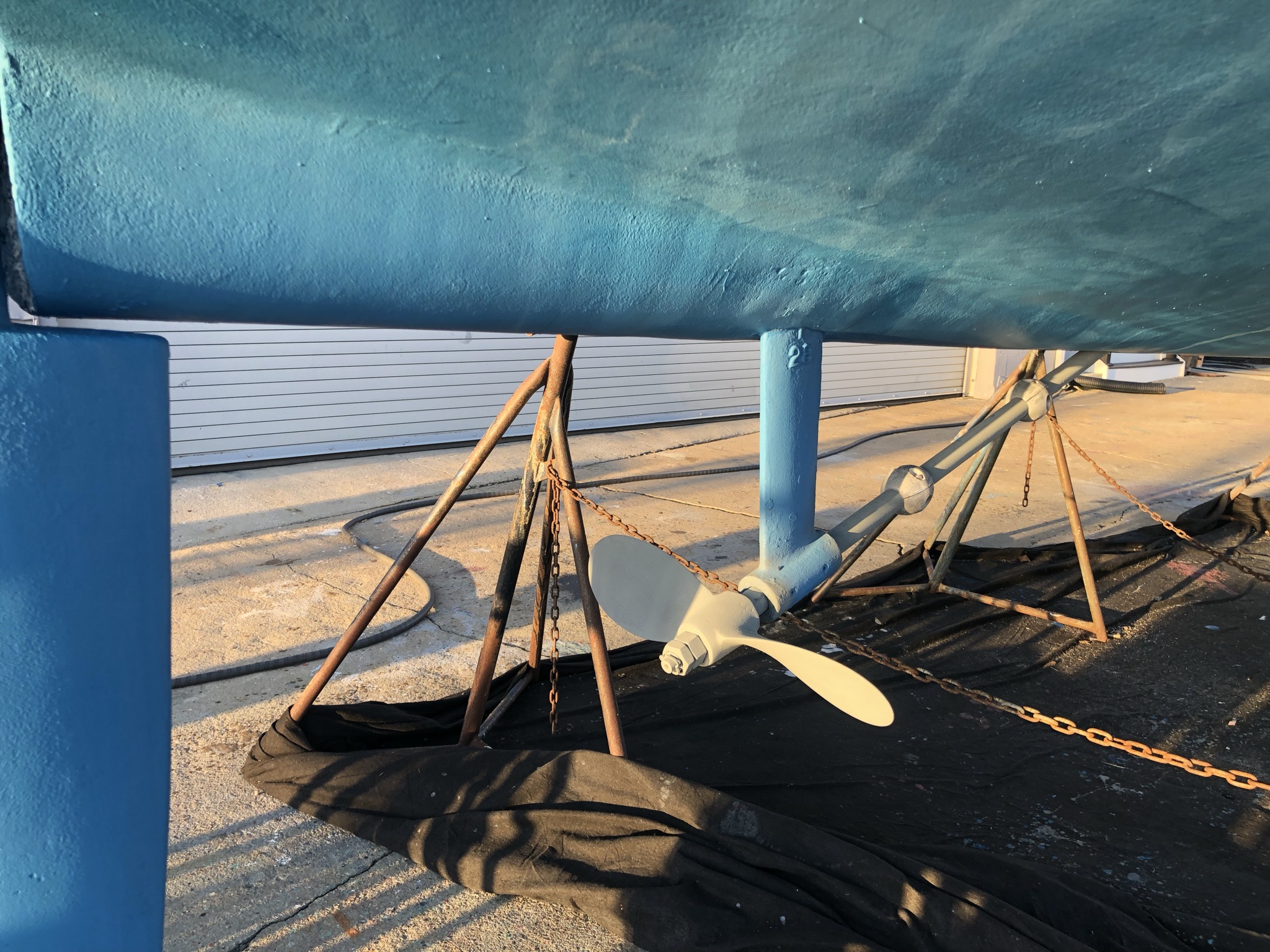

I am a big fan of the Campbell Sailor prop, however looking at the photo I’m inclined to agree that is likely more of a fouling problem. My suggestion is if the Max Prop Blades in the photo are not loose then clean the prop, paint it with Pettit Prop Zinc spray paint (or similar) and see how it does next season.

If I were you, I’d stick with the Maxprop. It’s a really great device, as long as it’s properly greased every year. You might want to check with PYI about what the pitch setting should be, and then confirm that that’s what you have. They are very responsive.

Mark, your prop looks so beautifully clean. Wish mine were likewise. I’ve had disappointing experience with Pettit’s sink prop paint. What do you use, and how?

Hi Dale- This was done by the yard shortly before I purchased the boat. The bottom paint was Micron CSC. The prop paint isn’t listed but it sure looks like it was Pettit zinc spray. I know that has a history of clogged nozzles but it seems to have kept growth off for at least this season…
Mark
Thanks Mark. With no better prop protection alternatives simple and inexpensive enough for me to try, I’ll probably give Pettit another chance. Reluctantly.
Appeal to Heaven was hauled out last week and I found four tip of finger sized barnacles on the prop. I think that may have been the problem. It seems like their are lots of up votes for the Maxi-prop, so I will lubricate , check the pitch, and zinc paint it in the spring. Then I will make sure to keep it brushed off with some summer swimming.
