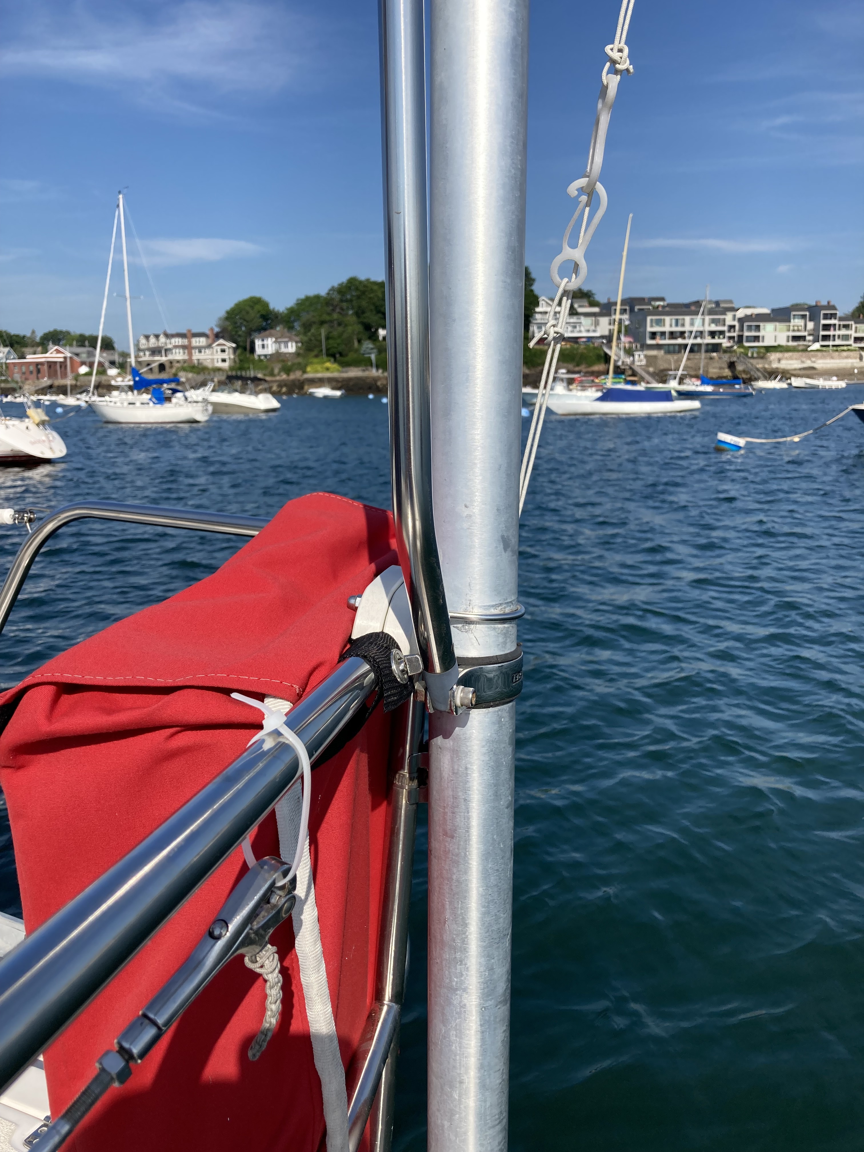

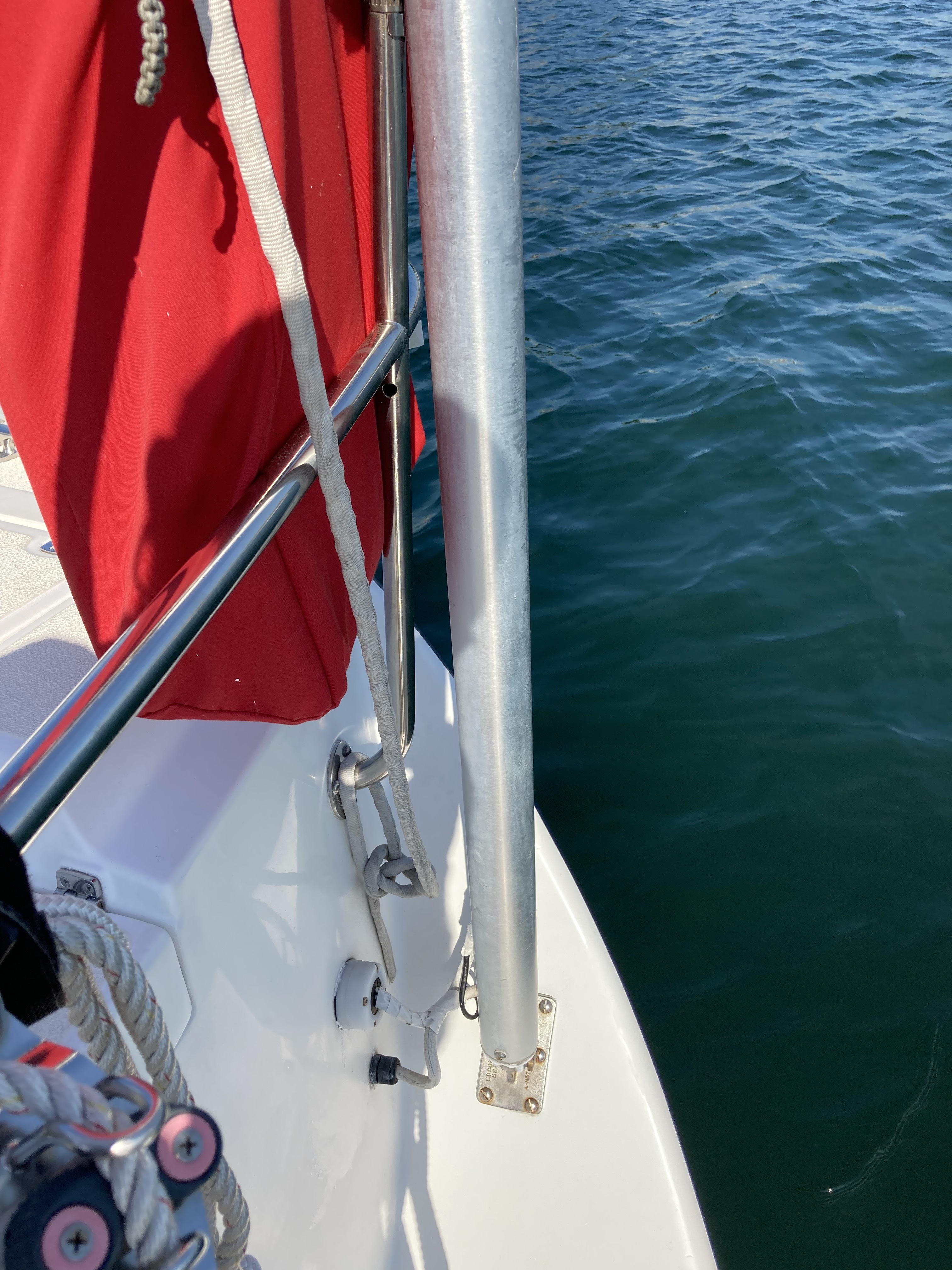

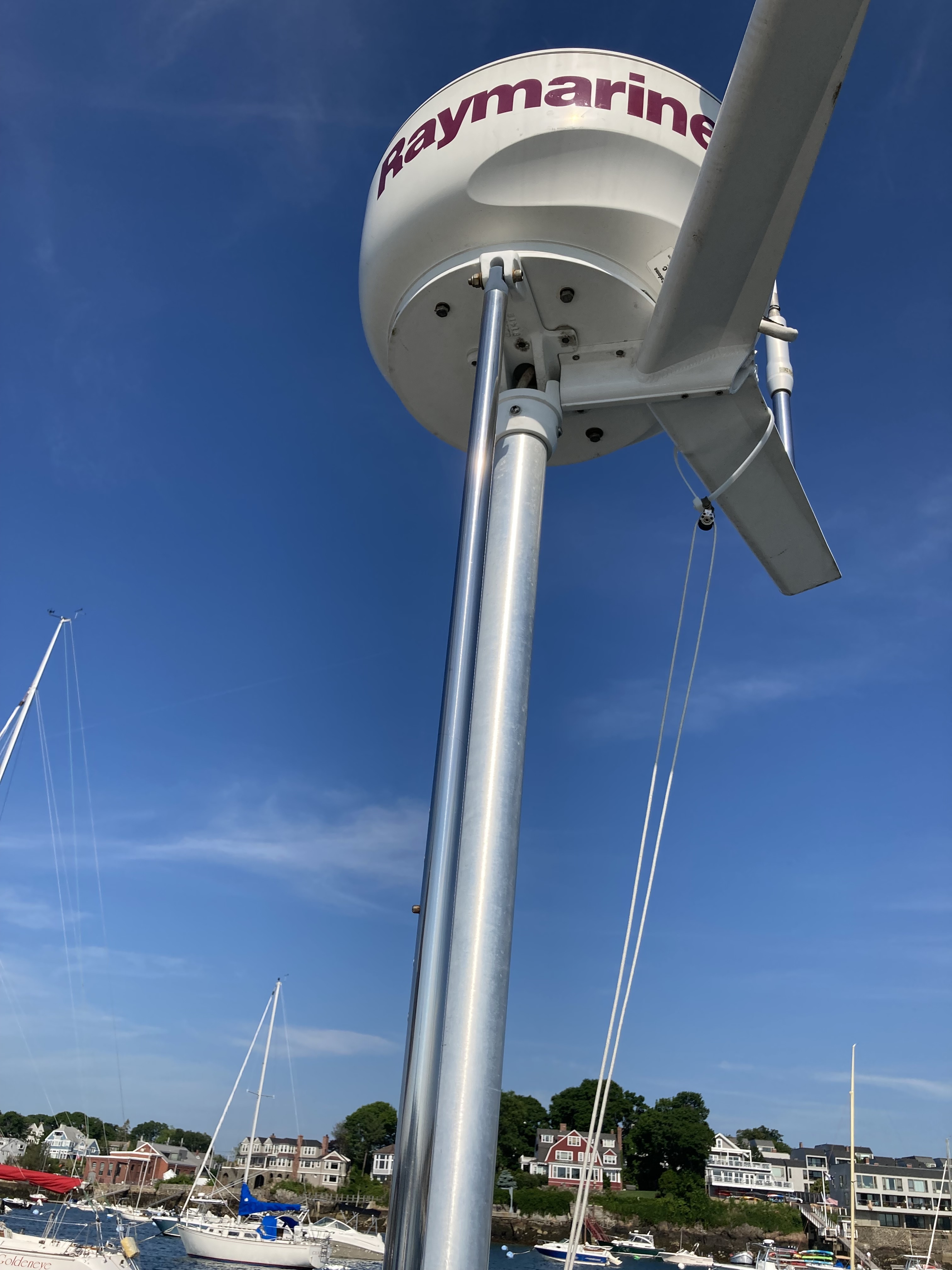

Here are some photos of my radar installation, which is on a 40/40, and probably overkill for a F28, but you have to think about the forces that a radar on a pole will generate if you’re pounding into a seaway. The photo of the boom and radar isn’t the greatest, but I don’t have many from an angle where you can see both at eye level. Note, that this is my old radar pole and the newer one is higher, as this one was too low. I think that I probably added a foot. Also, note that there is a connection from the radar mast to the top railing to add stability.
