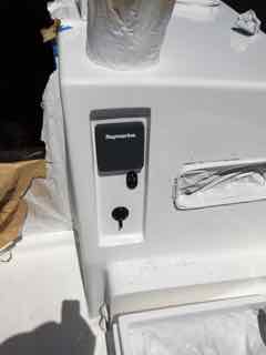

I bit and got the i70s system pack (one i70s display, itc-5 converter, depth-speed-temp transducer, and wind transducer with cable). Removed the three Autohelm instruments and glassed over the holes. I left the cables inside, hanging down by the stbd hull side until I can locate them by my control panel- the cables all had “Autohelm” written on them but I can’t locate them in my electrical panel area!
. I ran a single ST ng spur cable back over and will drill and install the i70s in the spot where the three displays were. I’ll go to the mast in a couple of weeks for that work. I removed my old boat speed paddle transducer and installed the combo-transducer and ran that cable to my panel where the new itc-5 is and wired those 7 leads to it (wind leads to follow). That cable too had “Autohelm” written on it but when I trace to the panel I can’t locate it! I disconnected the red from the circuit breaker to those iliminated instruments and as I can’t locate the black lead to remove it, that’ll have to remain - hopefully without a voltage drain anywhere.
