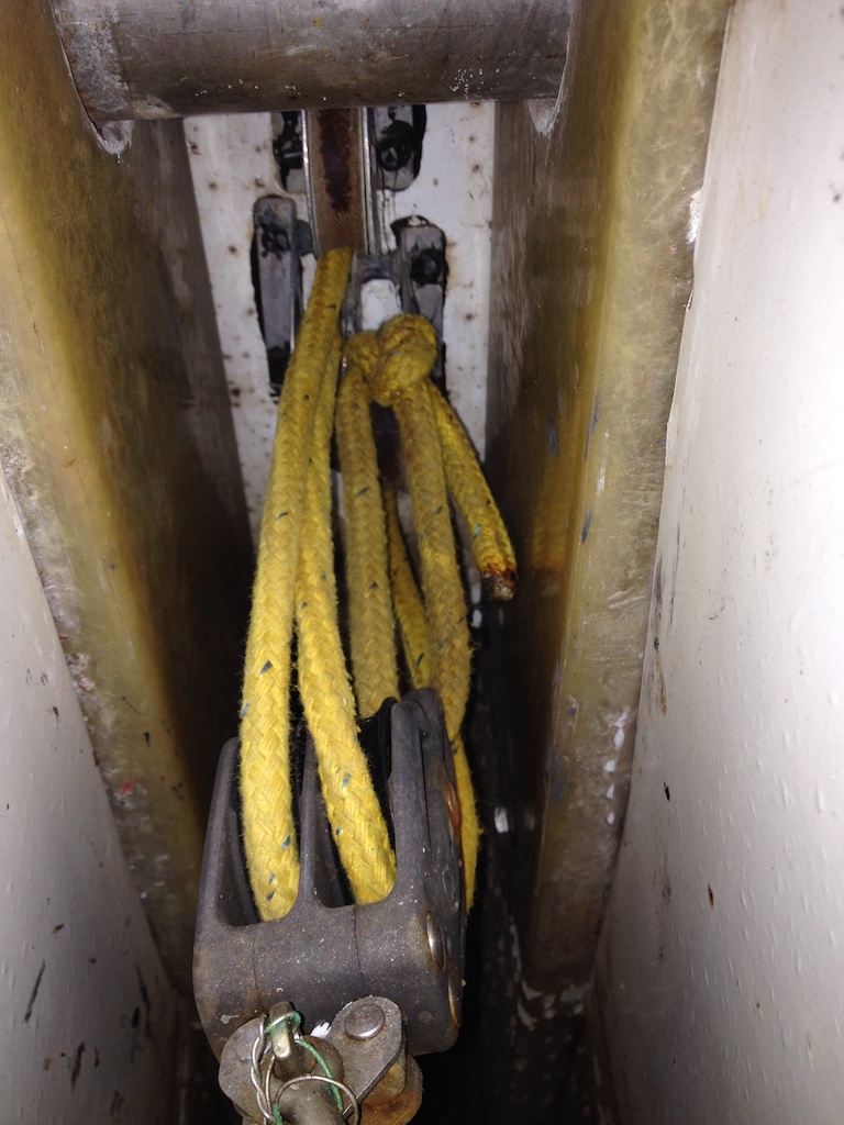

Thanks so much for the info. Mine has rope all the way to the winch. One picture speaks a 1000 words. Thanks again.

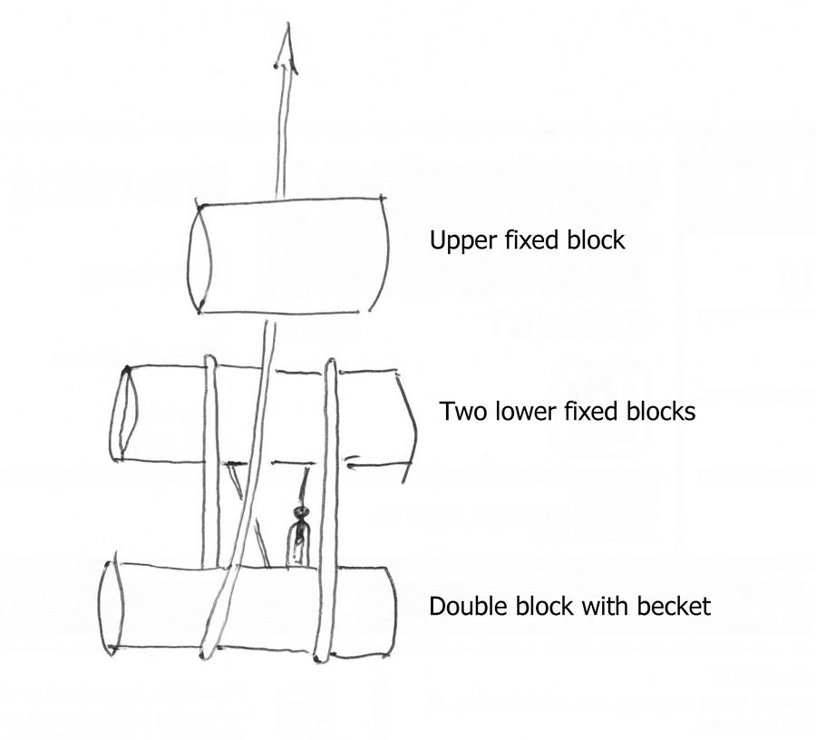

I’ve just been experimenting with the rigging of the plate uphaul on my F30 - it’s the same layout as the F33/35. Its technical name is a “winding tackle”. I’ve ended up slightly different from Gerald’s arrangement - for a start, I don’t have room for that long bowline onto the becket of the double block. I tried rigging it with the block at 90 degrees to the fixed sheaves - Ashley Book of Knots serial 3253 - but that didn’t work for me. I then went for serial 3261 (although you have to think it upside down because the lead sheave is not in line with the other two fixed sheaves)
Imagine that you are looking up from underneath and that the hauling part goes up and away from you, not coming at you as shown. Note the crossover of the left hand turn.

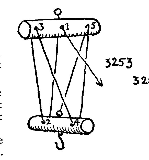

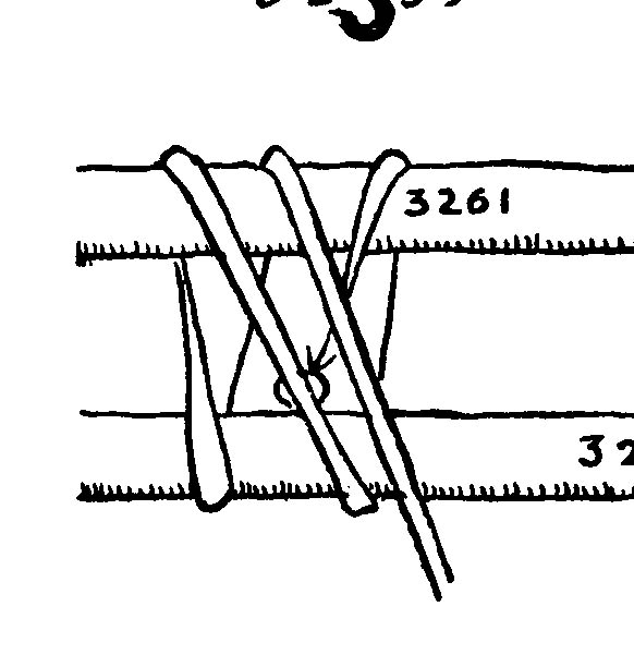

I drew a new version of the arrangement from Ashley to show how I have it rigged on my plate.

Your revised drawing look pretty much as I remember mine, though it is now two years since last I looked. The picture I posted was of a previous pennant, from 2010, when I had to replace it in Helsinki after a block failed – not one I had chosen, and nominally well within its load capacity; but it also had had the pennant rove in a sub-optimal manner, and the twisting contributed to the failure. The new, substantial block was eye-wateringly expensive – €75 – and the Swedish yard had lost the Tufnol blocks I put in the previous year.
Erik – that’s why I think it is so important to get the route of the pennant just right, and why it’s worth taking a little time to check that nothing is twisted or chafes.

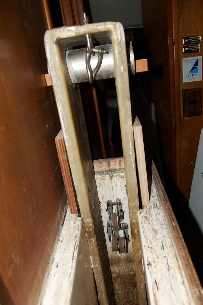

Thanks to you guys for the info. I just got a look at my centerboard through the top of the trunk. The arrangement I have is one single block attached to the board with two single sheaves located on the front wall of the trunk.
To increase the mechanical advantage I could attache a fiddle block to the board .
Then, attaching the line to the upper trunk support run it through the fiddle block and two stationary sheaves.

Anything that increases the mechanical advantage will be good news, so long as it can run freely. I’m surprised it can be lifted with the current arrangement, unless you have a very powerful winch. A double block (sheaves side by side) might be better than a fiddle block, if there is little room when the board is raised. My long bowline actually prevented the complete raising of the board because it touched the fixed sheaves on the casing. The disadvantage of increasing the power of the tackle would be more rope in the cockpit, and longer to wind it in.
If you have the original design of F33, with the American cabin layout, where does the lifting pennant go when it leaves the Centreboard casing? The UK one takes it up above the coachroof, through another sheave, then aft to a central winch, which would be where the companionway is on the US model. Have you a diagram of the layout?

The pennant goes up to the cabin top and then back to the winch which is a Harken 56. I definitely need to use the slow speed to lift the board. Will use a double block with 12mm line instead of the fiddle block. Will take some measurements this weekend and do a better inspection, am currently replacing the leaky fuel tank what a PITA.

Just looking through some of the stuff I have about centreboards; there’s a really good post by Phil Downey (search this board under phildowney ) dated Sept 13 2009 about replacing blocks on the c/b. She built a double block with becket from two stainless Harken blocks bolted together,then used 10mm Dyneema for the pennant, and also replaced one of the fixed blocks, which was binding. She can manage to raise it ‘one handed’ (must be very fit). I think her suggestions are perhaps the best solution, though neither cheap nor simple; she is obviously very experienced in boatbuilding, as well as sailmaking.
From your description, there is no essential difference between the US and UK versions of the c/b layout, though the access may be a little different, since the aft end of the case is more accessible on the UK boats.
