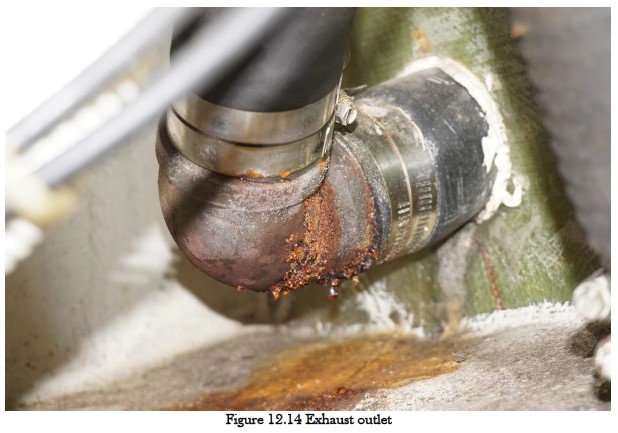

I purchased a 1987 Freedom 30 a few weeks ago (A terrific and past due upgrade, after having a F-25 for 25 years). I wasn’t there for the survey and am going through the report that includes the following:
“Corrosion and possible leak observed where the engine exhaust exists the transom [Figure 12.14]. Monitor for leaks after launch with engine running and repair if necessary. Clean and treat corrosion.”
I’ve attached the survey photo that shows the elbow with rusty liquid dripping from it.

Congrats on the “new” boat" I think you’re gonna love it. I have a F38. The exhaust elbow and its connection to the outside are hinky on the Freedoms (note the white caulking holding it in place) so this is as good a time as any to fix this. That elbow itself should be replaced (not “repair” as the survey language suggests). With that much rust you are likely to be exhausting hot water and carbon monoxide in your boat especially if there’s a known leak. You should always check that water is coming out when the engine is running. The exhaust hose is accessible – not easily, mind you, if you’re a big person – through the port locker. If you’re pulling everything off (my approach to boat work) you might consider replacing the exhaust hose too especially if it’s looking kinda worn. The exhaust port on the transom is low to the water and should be easily visible standing on the dock. I recommend you do this work when you’re on the hard. You might also look at upgrading that exhaust port with a check valve. These are all on my To Do list for next time. Do let us know how it all works out!

I’m liking your input of going ahead to replace the exhaust elbow and will do that after haulout, and maybe also the hose. Will also take a look at the funky caulking. Hope I can find an elbow replacement. Please let me know if you have any idea where one can be located.

The elbow is very very simple. Go to a hardware store and buy a galvanized pipe elbow of the correct diameter (I think its 2.5 inches but I did mine a long time ago so verify) and you are good. Actually, I need to do it again, they seem to last about 10 years or so. I recommend using high quality T clamps for all your exhaust connections, I have had run of the mill screw clamps rust out and literally drop off. Not good. Replaced all of them about a year ago. Was a major pain but worth it. The community may have other ideas re elbow to use. Edit: You also need to buy two threaded pipes to insert each end of the galvanized elbow to provide a “barb” for the exhaust hose. As I recall these threaded pipes are readily available also.
