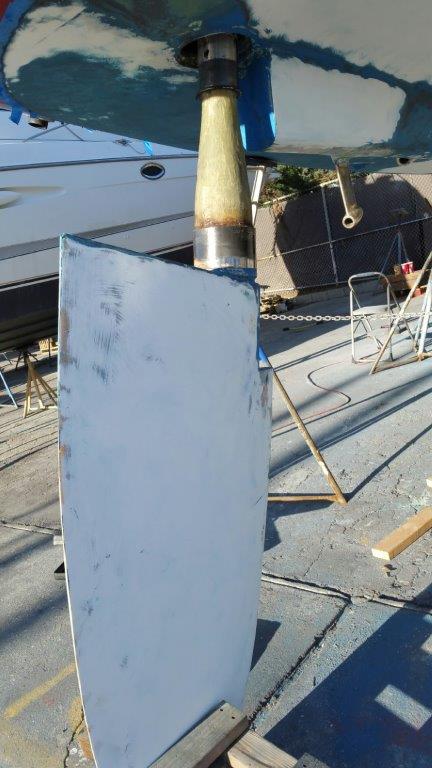

Well, I found out there are no bearings on the F38 (1988). I dropped the rudder and it is stocky though a little weird looking. There are 4 Zerk fittings on the rudder log (?) inside the boat and a couple of bolts that run through to hold the rudder post in place. One at the top where the emergency rudder fits onto and one below it where the quadrant fits around, which you might be able to see in the picture below just underneath the opening. I don’t think I have any before pictures of inside but will try to get those when I clear the cockpit locker again. Here is a picture of the rudder after I cleaned all the grease off, what little was left. It turns nicely now :slight_smile: There had been some pit corrosion on that lower band, but I checked with someone and he didn’t think, if I kept it greased, that it would create a failure any time soon.

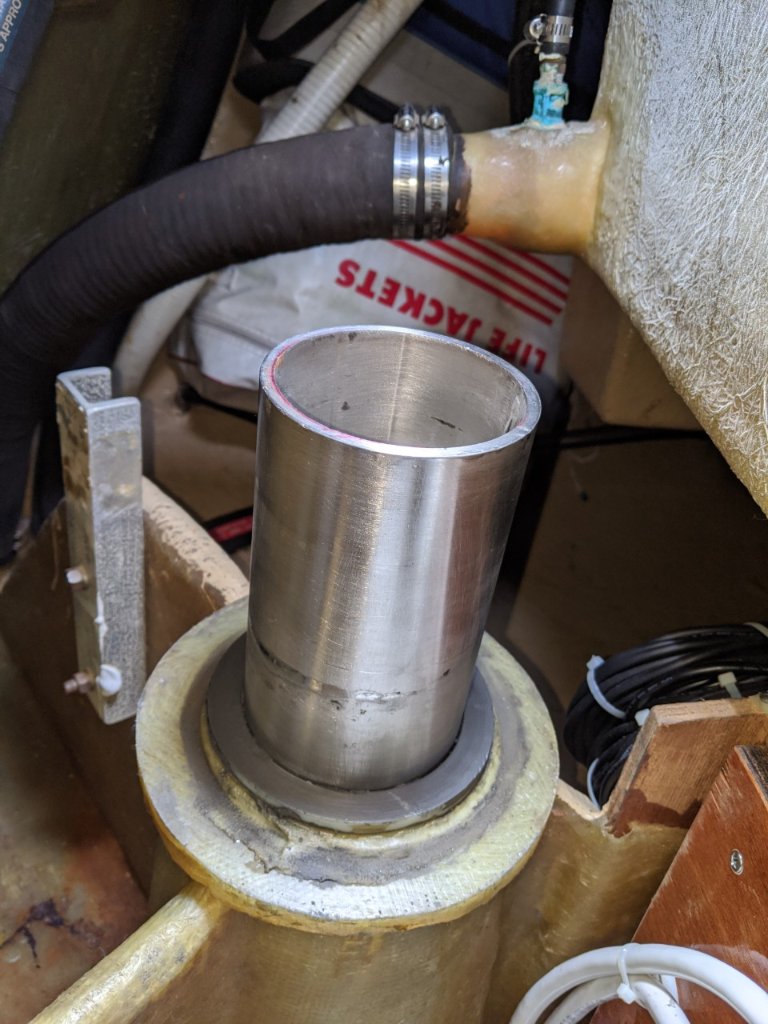

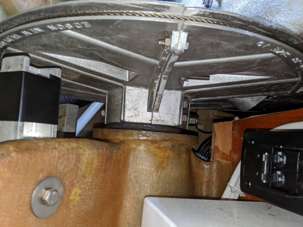

Follow up to my question 4 years ago about the Edson Radial Drive Wheel on my 1986 Freedom 36. It had a slight wobble in all directions on the rudder shaft so I guessed the only thing keeping it from turning on the shaft was the bolt. This year (2020) I was finally able to address the issue. The boat was hauled for bottom paint at KKMI in Point Richmond, CA, and I had the yard put a jack-stand under the rudder to support it. I then removed the cables and the Drive Wheel. Fortunately none of the bolts were seized so it came off easily. What I found was an apparent factory defect. Edson specifies that the opening in the Drive Wheel be 5 thousandths undersized to get a clamp fit. My Drive Wheel was 45 thousandths oversize. The machining marks were still visible inside the Drive Wheel so I know it was not wear. I also found that the bottom of the Drive Wheel, which bears directly on the (Acetal?) bushing at the top of the rudder tube, was rough and had visible casting marks. KKMI machined the faces of the two halves of the Drive Wheel so that the inside dimension (in one direction anyway) was 5 thousandths under the dimension of the rubber shaft sleeve. That provided enough clamp to make the Drive Wheel engage the sleeve tightly. Now the bolt is no longer the only thing turning the rudder. They also machined the bottom of the Drive Wheel flat and smooth so that a good surface is bearing on the bushing. So, in answer to my original question 4 years ago, the Edson Radial Drive Wheel itself is actually what holds the rudder in place on my boat
