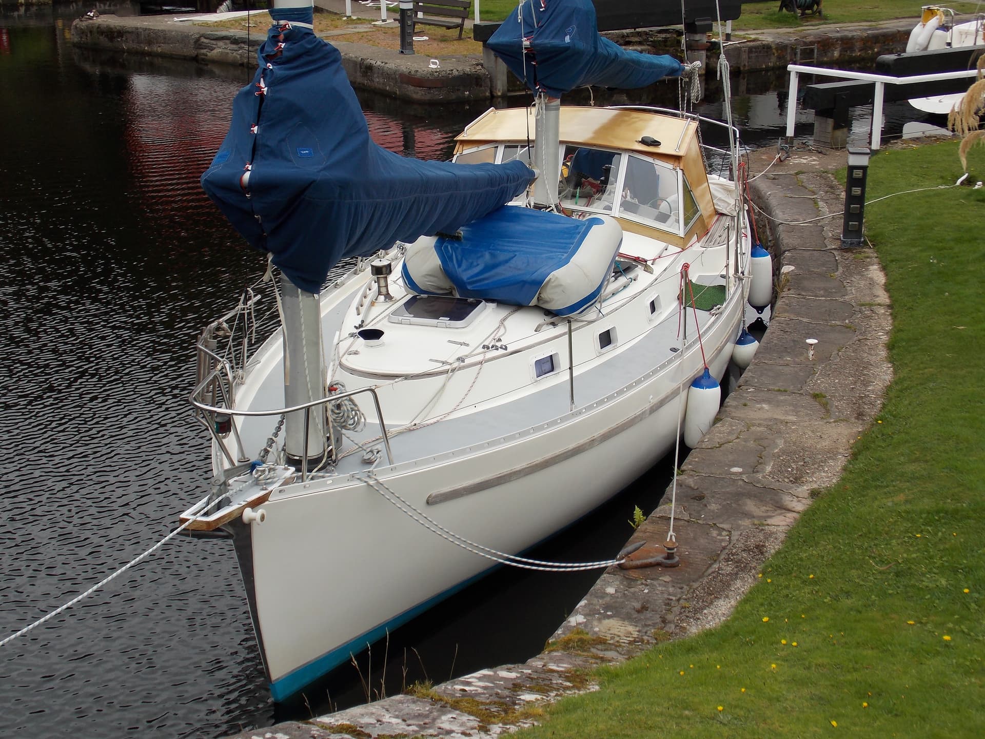

Wrong end of the winter, but I have two sets of covers, neither of which fit well around the mast. I could lend you the better set but there would be some carriage involved, to/from Argyll. I don’t use the frontsail cover while cruising in our fairly cloudy seas as it’s too much bother and somewhat hazardous for me to fit while singlehanded, requiring me to stand on the pulpit.
Perhaps better to use measurements from my covers which I can provide and make up the aft ends with spare cloth at the front which can be assessed in situ. The front is very sensitive to the shape of the head and to the length of the strops holding the saddle to the wishbone which in turn is sensitive to outhaul and risk of fouling the backsail rigging and/or wishbone. Also to the height of the wishbone when the sail is down. I generally use a rather high setting for this on the frontsail.
A photo. Note the poor fit around the top and the straining (with chafe) around the front of the wishbones.

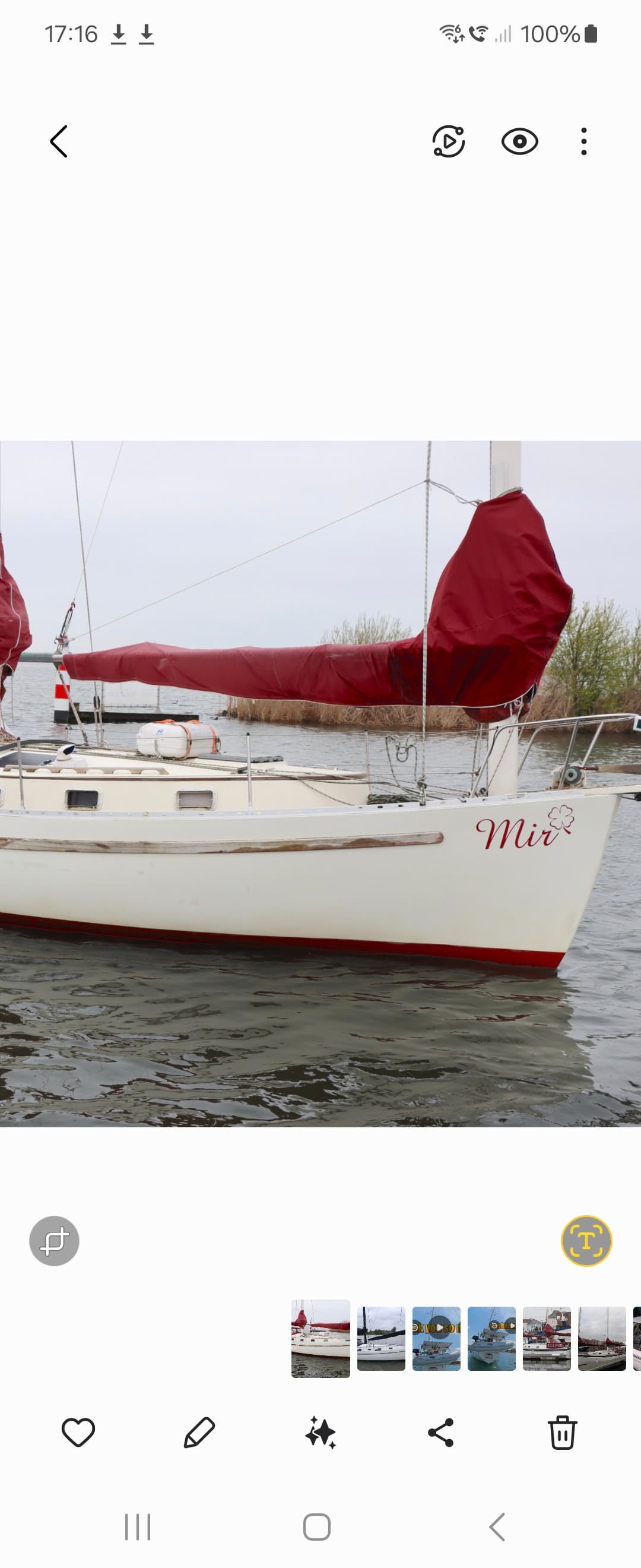

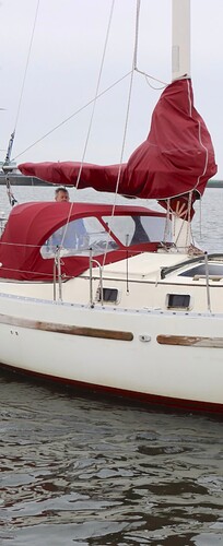

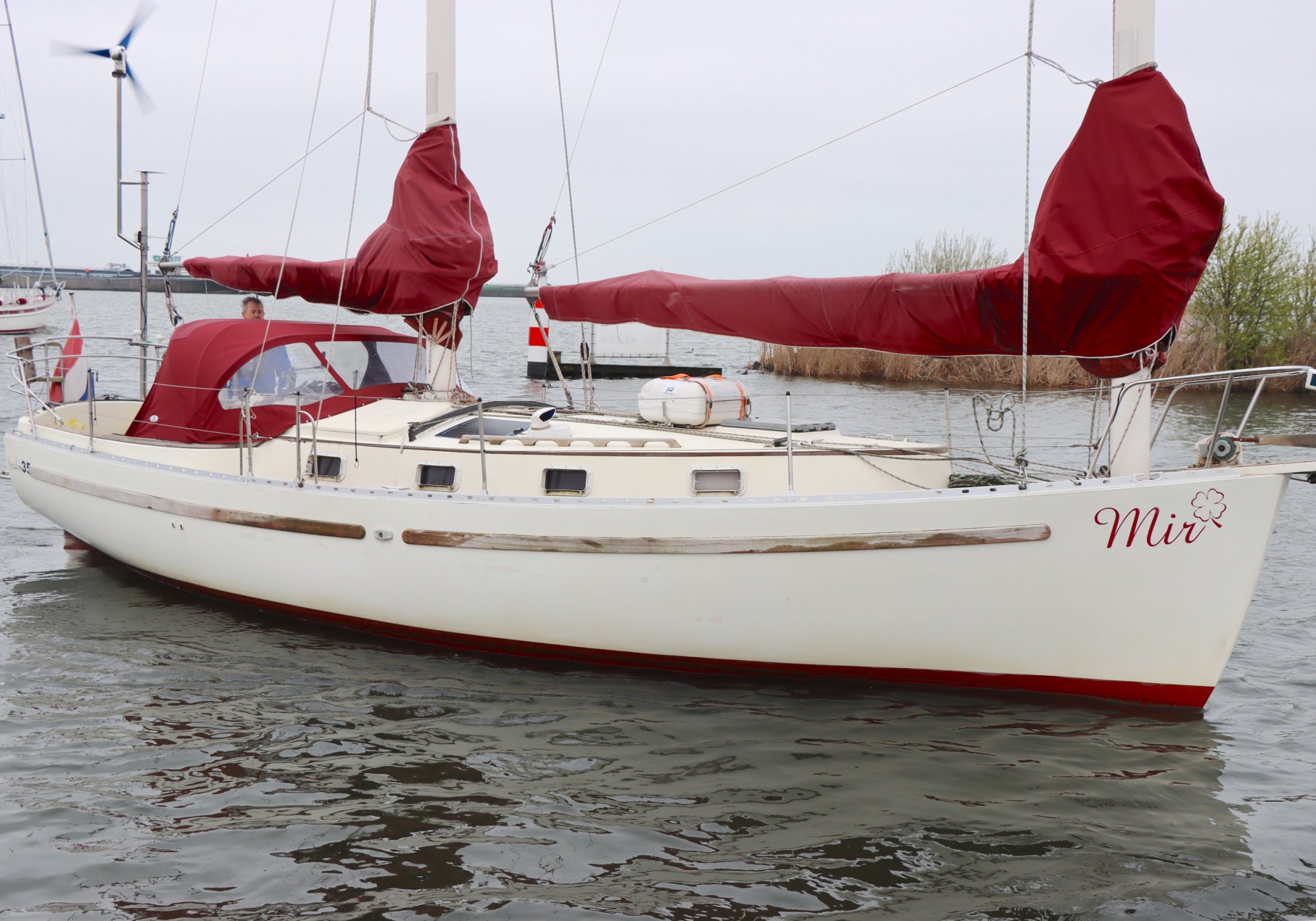

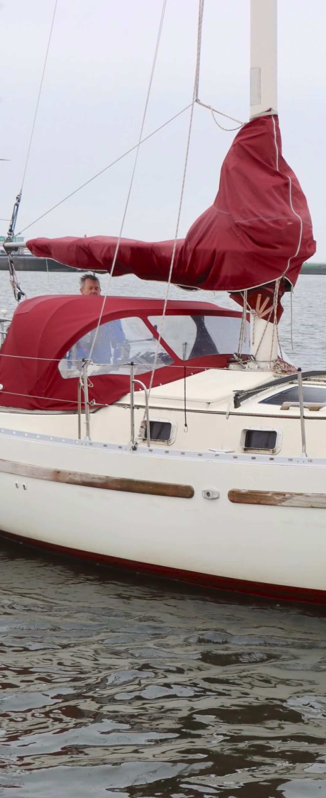

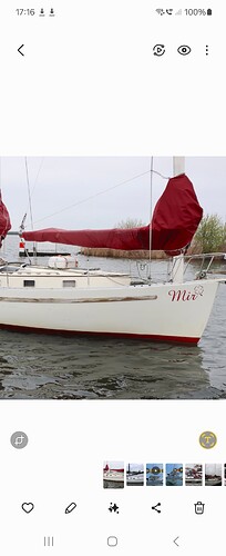

I had new covers made by Cindy Parker’s Wilkinson Sails in 2022. They did a a good job and also refurbished the sails and replaced all the running rigging. They are located at Units 7-8, The Old Shipyard, Upper Brents, Faversham ME13 7DZ (www.wilkinsonsails.co.uk).
