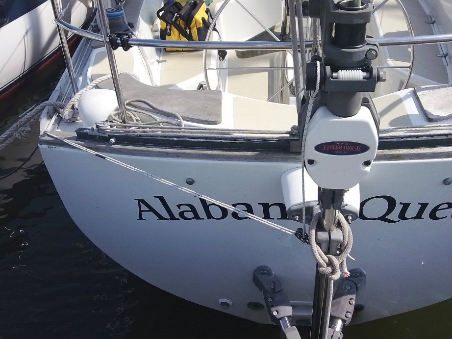

Yesterday I completed installing my Hydrovane. Mounting the top bracket through the resin and glass filler block was fairly easy; I could access the inside of the transom via the cockpit locker. And since I lost 15 kgs of body weight these last few months, I was more agile and comfortable in that cramped space. Installing the bottom A- frame brackets presented a problem however; I could not get to the inside transom at the desired locations. So I moved up the bracket and shoved the genset partially out its box to get to the inside transom:
Here is the completed installation:
Here’s a view on the vane head control line. Still have to find out if there’s not too much friction in it. I led the line to the side of the deck close to the control unit of the autopilot, so I can set both steering systems in sync with each other.
Many thanks to Hans Hansen, who offered his two year old Hydrovane for sale to me.

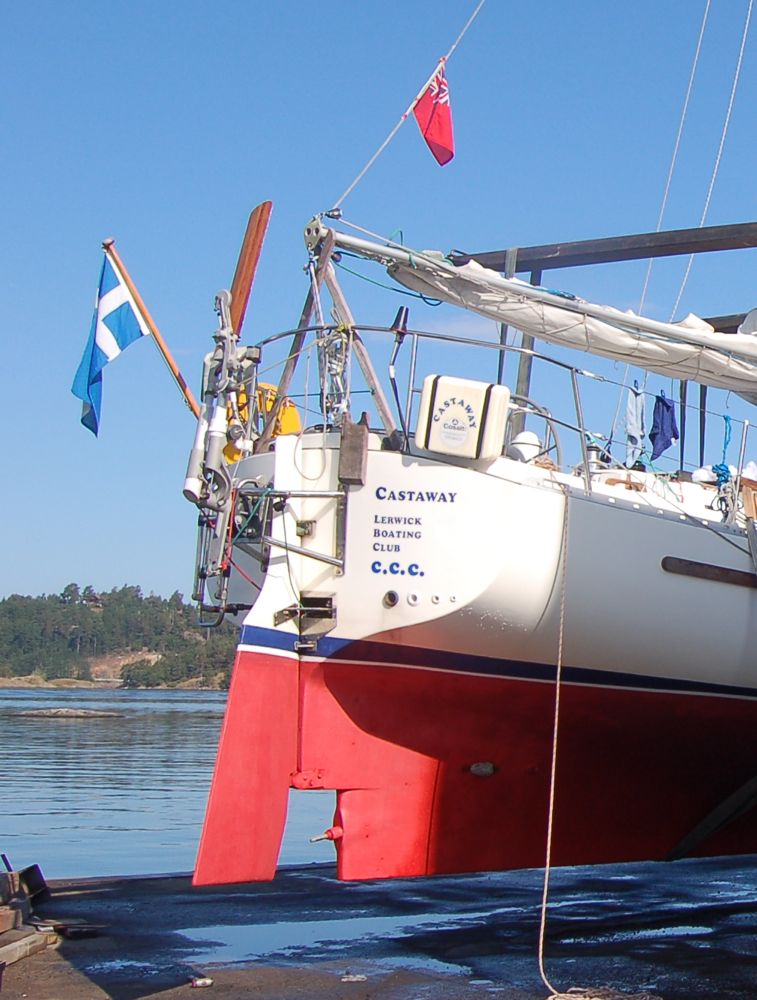

I have seen an F35(UK) with a windvane self steering mounted to one side on the transom, it was “Arran Comrades”, then based in Oban, Argyll. I don’t know if there were any drawbacks to the system. I think there was some commentary about it, years ago, on the old bulletin board, so it may be archived somewhere.
I have one or two pictures of “gantries” to mount windvanes aft of the rudder. The Windpilot on “Castaway” is also shown on the Windpilot website under Freedom351.jpg

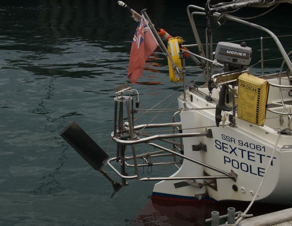

Herewith the picture of “Sextett”, belonging to Richard Salkeld. I don’t know what type of self steering this is; perhaps Richard will comment if he sees this. For some reason it would not load with the other pictures.
Gerald
That is the Monitor self steering device built by Scanmar in California. To me it looks more like an oil refinery. I prefer the somewhat more tidy looks of your Windpilot. (I confess that I am a bit prejudiced as I have a Windpilot myself)

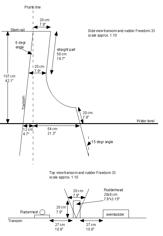

Congratulations with the almost purchase of a boat! In case it might be helpful, I attach the F33/35 transom measurements I took years ago when I bought a Voyager windvane. The manufacturer made a custom aluminum casting for me to fit around the rudder head. My measurements apply ti the F33/35 built in the UK and for the smaller rudder that was used after (I think) 1983.
Gerald, Michel

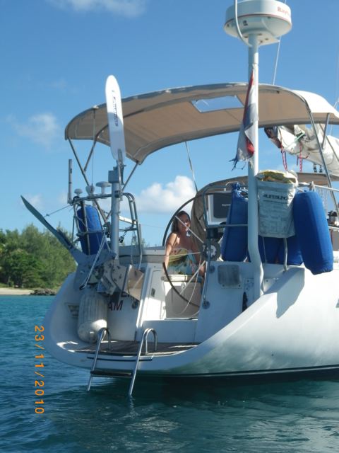

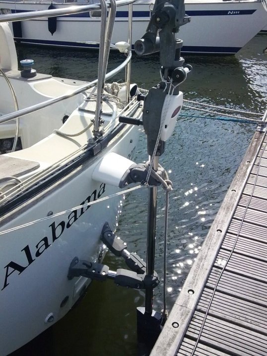

After I changed from Hydrovane to Sailomat I had the opportunity to sail a couple of weeks with the Sailomat for the first time.
My experience with Sailomat is very positive, after some small alignments the unit worked flawless from the start.
Steers the boat upwind in a rough sea on a straighter course than the Raymarine autopilot can.
In a gusty wind when to boat tends to luff, motions are a bit wider, but still steers the boat on a pretty straight line where the Hydrovane
did send the boat into the wind.
The unit weighs a fraction of the Hydrovane which is nice for a unit mounted to the stern of the boat.
The light weight aluminium construction gave me some thoughts about durability. But then I read the book written by Amir Klink. In short: singlehanded Argentinian sailor. Sails to the antartic to spend the winter there, spring comes and he sees that there are plenty of stores and fuel left. Why stop sailing when there’s another pole?
Sails to the arctic, spends winter there; sails home next spring only touching land in St Helena when I recall correctly. During this whole trip he spends himself not more than 15 hours at the helm. The rest is done by Sailomat. So durability wo’nt be a problem I suppose.
When your boat is not easily balanced in correct sailtrim with changing windspeeds I can recommend the Sailomat without any doubt.
Fair winds

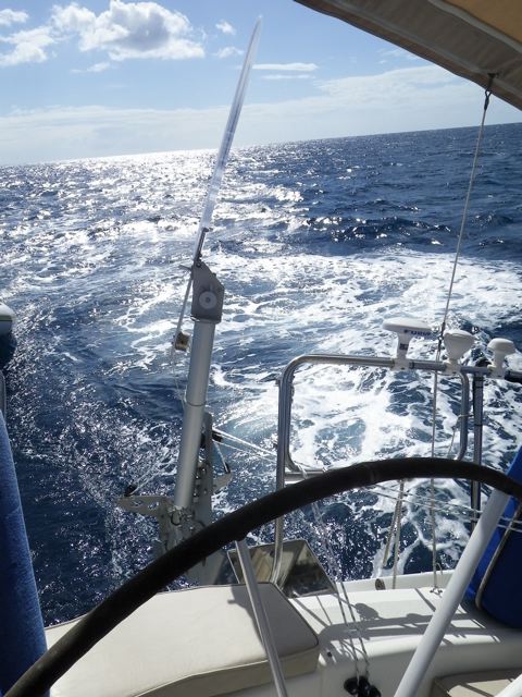

some pictures:
steering without any problem
