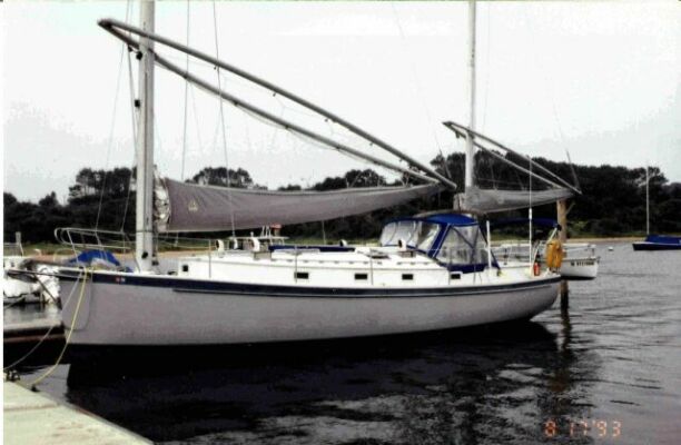

I’m in the same stage of thinking as you are. I have my wishbones at a fixed height and I have five cradle lines for each sail. See photo in this other topic. http://www.freedomyachts.org/viewtopic.php?f=9&t=10319&hilit=preventer&start=10#p40963
I am thinking of sailcovers permanently attached to the cradle lines with a batten in the bottom (or perhaps two) to stiffen things up. These battens would also double as spare battens for my sails. The cover would be divided in three sections along its horizontal axis, one bottom section - fixed to the cradle lines - and two side flaps with the zipper halves. The side flaps would fall down into the bottom section when the cover is open.

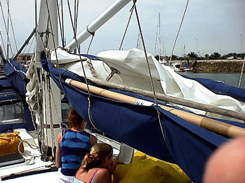

The cradle system works well on a single-ply sail on a track like Michel’s, especially with the fixed height booms. I tried it out on Castaway, and it made dropping the sail easier, but with the two-ply sails, the clew and foot need to be raised up to the level of the boom for stowage. What has worked well for me is running lines from either side of the wishbone, through eyelets in the sail at the same level. The upper part of the sail falls onto these when handed, and it is then easy to raise the foot, securing everything afterward using the criss-cross elastic. Other advantages are no loose loops hanging below the booms, which occasionally snagged when the sail was stowed, and support for the bunt of the sail when reefed ( I never got it neatly folded inside like you see in the Freedom diagrams!). I use 4mm line, and have suitable eyelets (cringles?) which were put in when the sail was last valeted, five on the main and four on the mizzen.
I don’t have any decent photos, I’m afraid. If you try this, leave the lines a little slack, and adjust so they don’t pull or chafe when the sail is set. I use loose bowlines on the wishbones, and let them slide; the eyelets keep the lines correctly spaced.

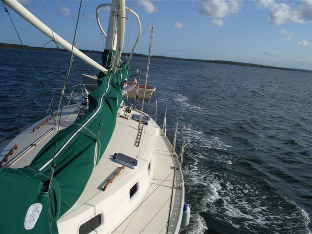

I found some more useful examples of cradle-cover combis with wishbones.
hi, i used to work for doyle , so have made a few, they often end up higher than a sailcover as they often make a straight line from above the headboard to the back a foot or so above the boom end, with rcb cars the stack heights get insanely high. my current take on stackpack style covers is to finish them 15 inches aft of the mast and provide a separate forward cover. this allows you to make an aft zipped pack that is only as big as need be.
