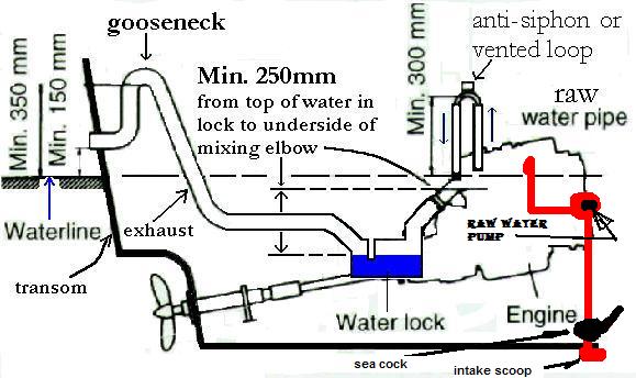

Rick, thanks for the input. Here is the diagram of my engine’s installation. I got fresh water cooling system. Sea water cools inner fresh water via heat exchanger. As you can see on the picture the raw water part with two loops :
The first loop with siphon breaker valve (My valve is just a small plastick cylinder at the top of “U”, it passes the air in one direction and closes in opposite automatically ). First loop connects heat exchanger with mixing elbow on the exhaust. I also got the second loop in the exhaust itself( gooseneck on the picture). It does not have any valves on top. red lines depict raw water flow: raw water intake scoop → sea cock → strainer → raw water pump → goes into heat exchanger → first vented loop → mixing elbow in the exhaust.

Reading this and some other sources I am now inclined to think that all wet exhaust systems are inherently dangerous and can easily flood engine either via raw water intake( in my case regardless of existing working anti-siphon valve ) or via exhaust (in the article).
Probably that is what happened in my case was that sea water flooded the engine via first vented loop, in my boat this loop rises about 12-15 inches above the water line ( 300 mm on the picture) . I read in the article:
“The water enters by a through-hull and seacock and flows through a raw-water filter. The through-hull may include a scoop. If there is a scoop, it will develop some velocity pressure when the boat is moving. (Six knots produces about 19 inches of water column pressure.). An allowance may be needed when considering other aspects of the system design if there is a scoop facing forward.”
I’ve checked my GPS track and found that my boat hit about 9 kts speed several times on that day. The only thing that stops raw water h beween the non running engine and water intake is the raw water pump while seacock is opened and boat in motion. Ideally the pump is new and impeller seals this path completely , mine is not … probably the velocity pressure built in the intake path could overcome the head of the first loop and flood the engine combining with the fact that transom sags at the speed and that rise become even smaller … if someone has similar engine installation what is the height of that loop above waterline in your boat ?As far as I know almost everyone keeps seacock opened while sailing … I feel that I have to change that habit of mine.

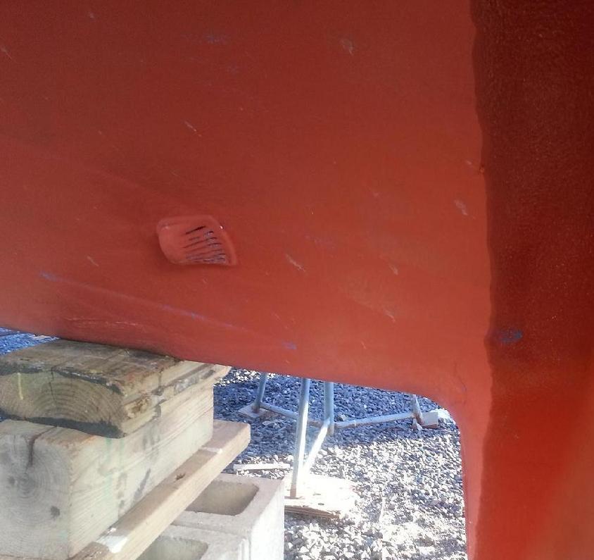

One thing I noticed that the raw water intake scoop (see the picture ) facing forward creating some positive dynamic pressure in the intake line while the boat is underway. It looks like the scoop has been originally installed this way by the factory. One possibility is to turn it 180 degree backward, to face stern.
I wonder if it might have some undesirable effect, for instance creating of some negative pressure and therefore leading to less water coming in and possible engine overheating. (I got 4 cyl. 55 hp diesel)
It would be interesting to know if anyone else has the same type of raw water intake and what is its orientation relative to the hull ?
We have a huge gate valve at the thru hull for the exhaust. It can be manually shut if there is a large following sea and there is concern about flooding of the exhaust. Our raw water anti-siphon loop is about 2 ft above the water line, and on center line. The thru hull for it is flush mounted and we have an internal Graco strainer.
I don’t think you create any problem by flipping the intake screen on your thru hull. I’d make sure the antisiphon valve works and I would try and get the loop as high as possible. Not sure I would close the valve though, unless it is easy to get to and you can open it up quickly if you need your engine. Impeller pumps don’t like to run dry. We have a diaphragm pump, which cares less.
