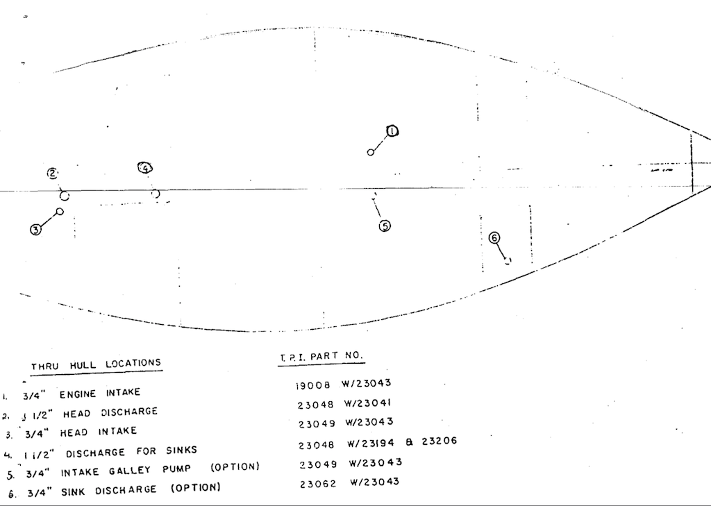

New to sailing and my boat, Freedom32. Haven’t had a chance to haul it out and I’m building a reef on the hull. Hull cleaning in the spring. My question is how many seacocks on this vessel and where are they located? Thanks.
Assuming you have the Hoyt 32 and not the Mull 32, here’s a screenshot from the manual showing all the factory thru hull locations:

There are at lest three discharge ones. Head (I mean toilet), galley (I mean kitchen) sink and a head sink.
There are at least two intake ones. Engine. Head(toilet) . Previous owner could add one for raw water washing in galley.
That are all located in vicinity of above mentioned devices.
