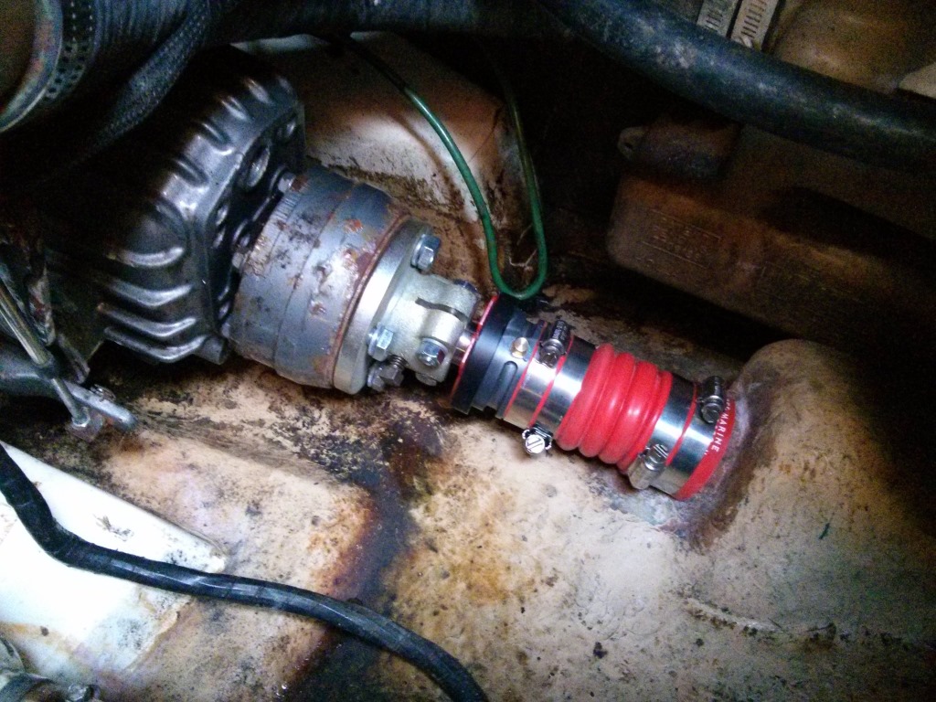

I just replaced the shaft seal on Dolcetto (F38) last week. I used a Tides seal as it was recommended by Paul Dennis from Warren River Boatworks. It was tight but it fit. I also replaced the shaft. I cut out the old shaft, removed the cutless bearing, installed the new shaft (required a bit of force) then installed the new cutless bearing. The shaft has yet to be aligned.

Michael;
Looks good but tight. What is that block of metal between the transmission flange and the shaft flange? Looks like a flexible coupling of sorts I’ve never seen before.
Don’t forget to tighten all the bolts before you power off. They look a little loose. :slight_smile:
The PO replaced the engine with a 40hp Yanmar 3JH3E. That cylinder is a torque limiter, standard on that model. I still have to align the shaft (this weekend) that is why the bolts are loose. I will finish alignment in water.
