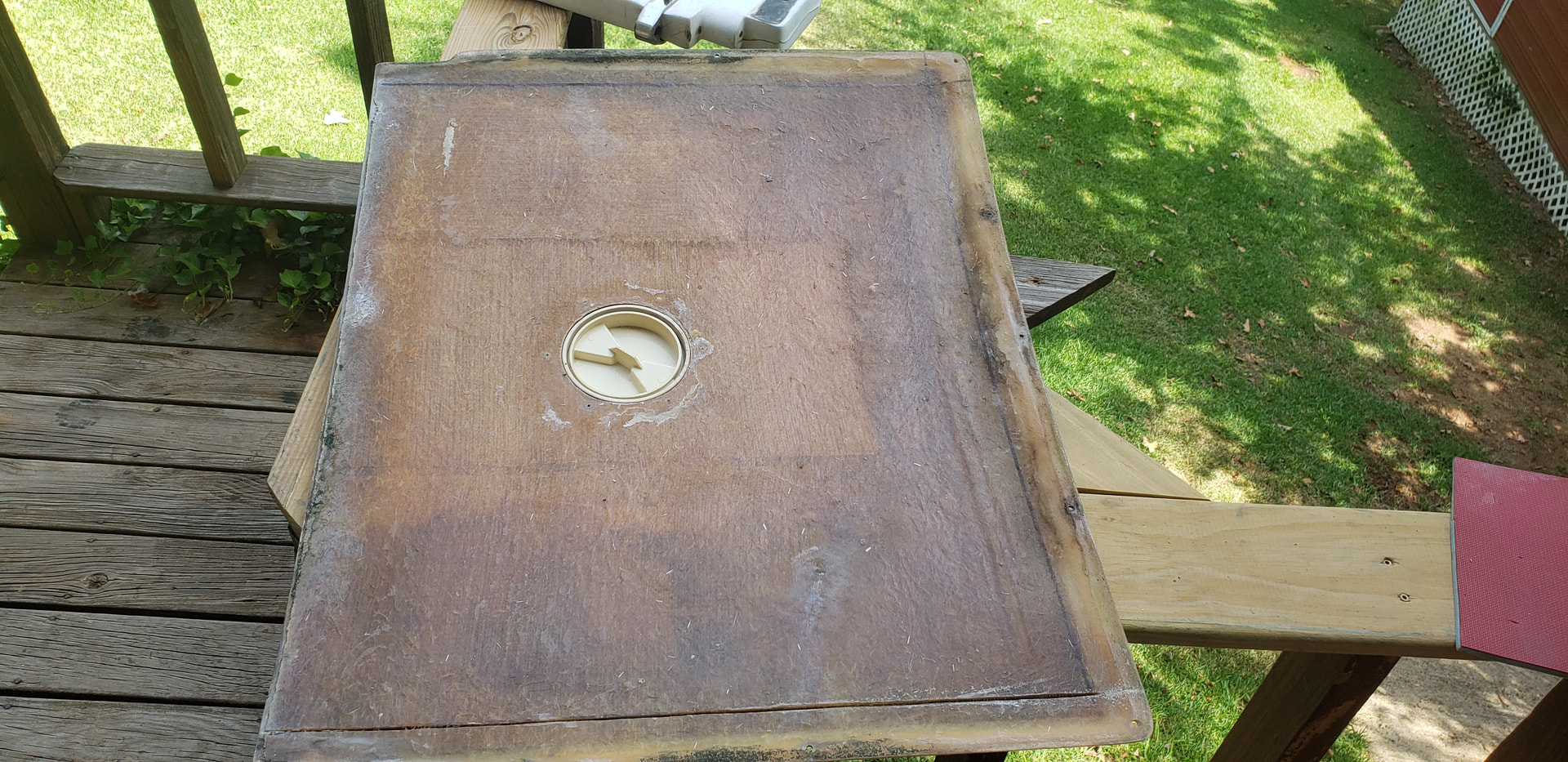

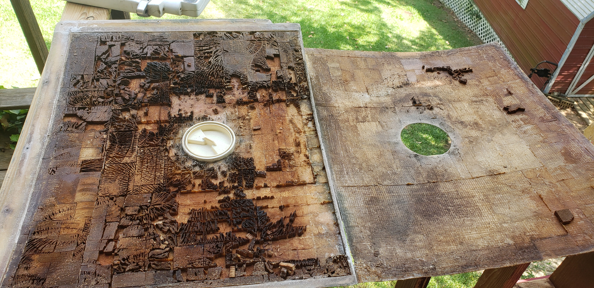

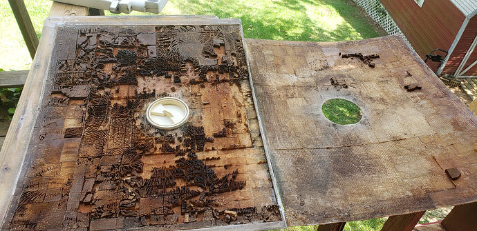

Tillotson owners; I opened up the inside of the “lid” for the sliding hatch cover today and found wet wood re-enforcement. Look at the included photos. Before I cut it open I thought this would be plywood laminated to both top and bottom sides of the “lid”. Before I go on a witch-hunt, I wanted to ask the forum what is a good product to put back in there. I am thinking plywood (3/8"?) but then the builder could have done that and chose to use something I have never seen before. Once sized and placed, I can re-do the fiberglass. Appreciate any advice. Rob
Hi Rob, I had a similar issue some years back…here’s how I dealt with it. Best of luck, Walter
That rotten wood is balsa.
Right - end grain so it will bend. Now to find that stuff locally - hopefully. Thanks, Rob

Instead of Balsa wood core I used a 1/4" Lauan plywood and laminated to the hatch cover with 2 part Epoxy. The contour and good adhesion was accomplished using a 50# bag of sand which bent the plywood to the existing curve. Once cured I then used fiberglass roving with resin to cover the Luaun plywood. edges were sanded smooth then the hole cut for the screw in deck plate; I presume this was meant for cabin ventilation. Posting photos of the repair.
