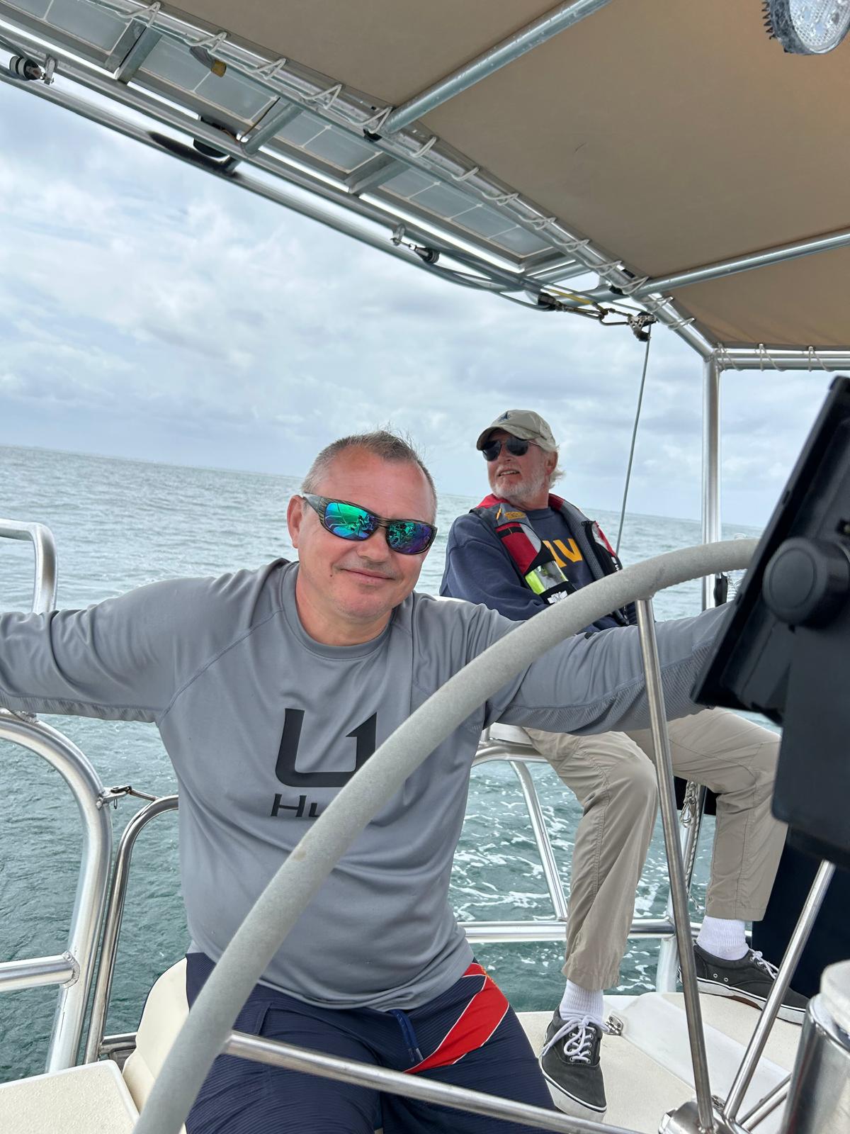

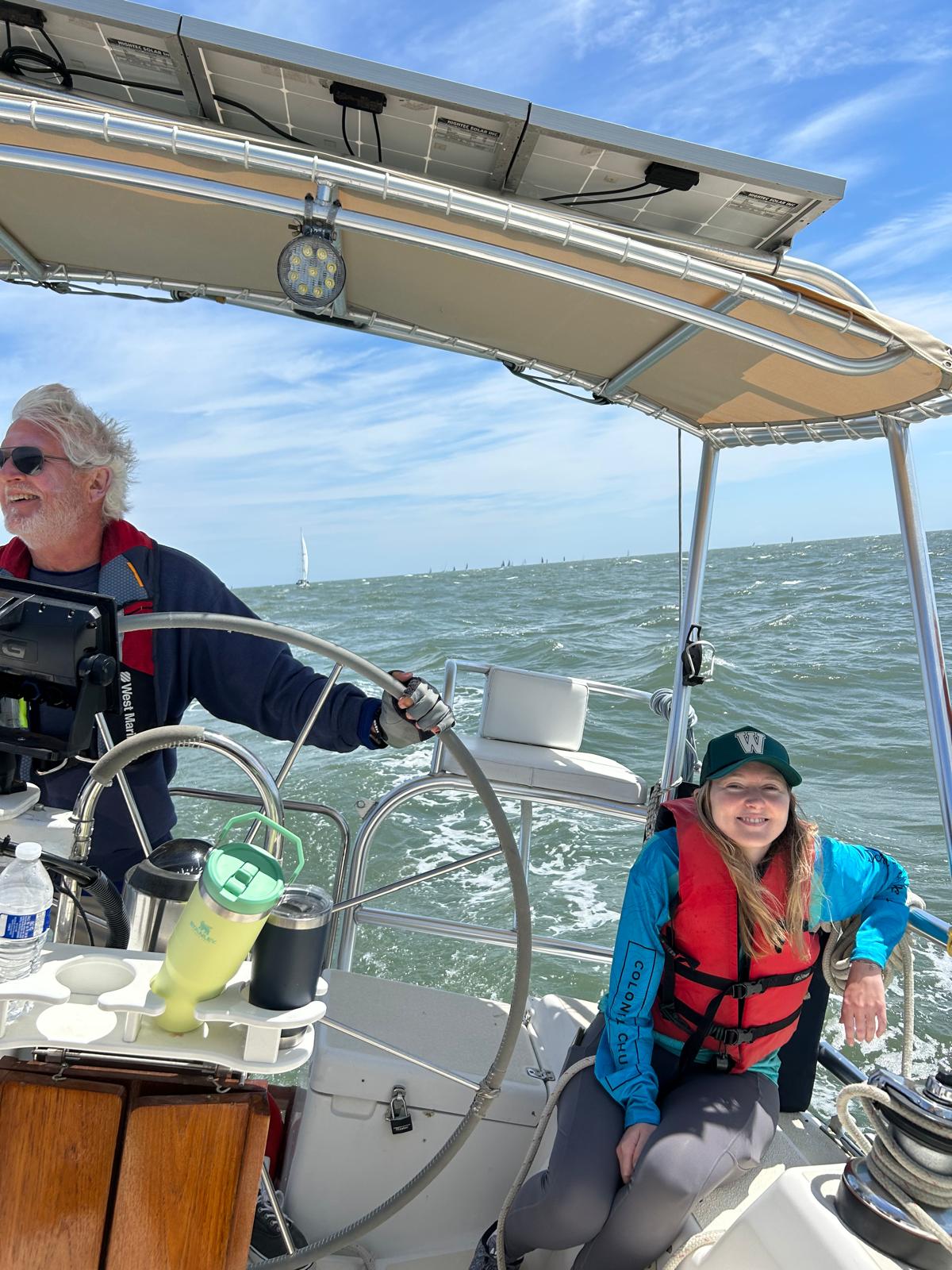

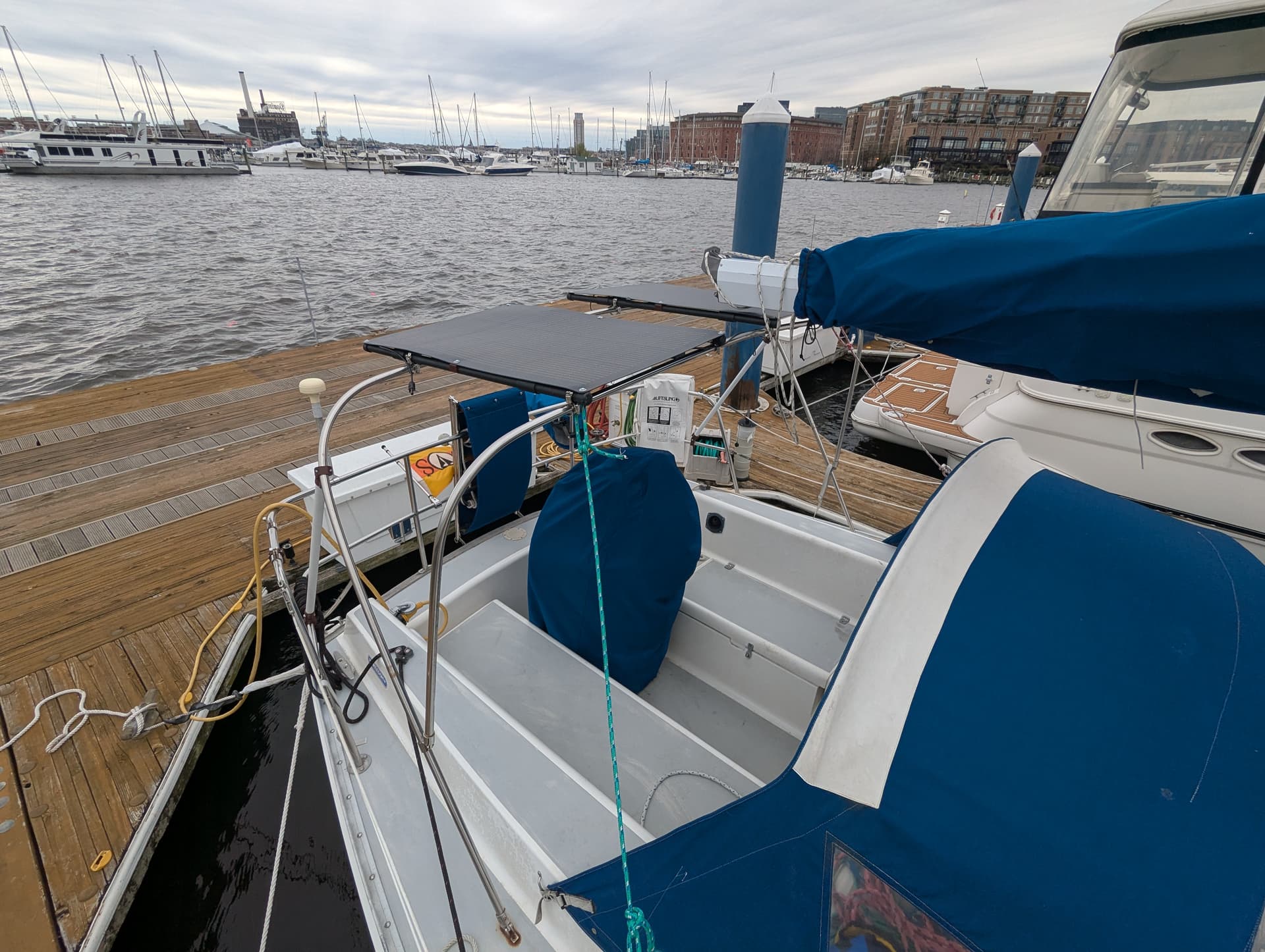

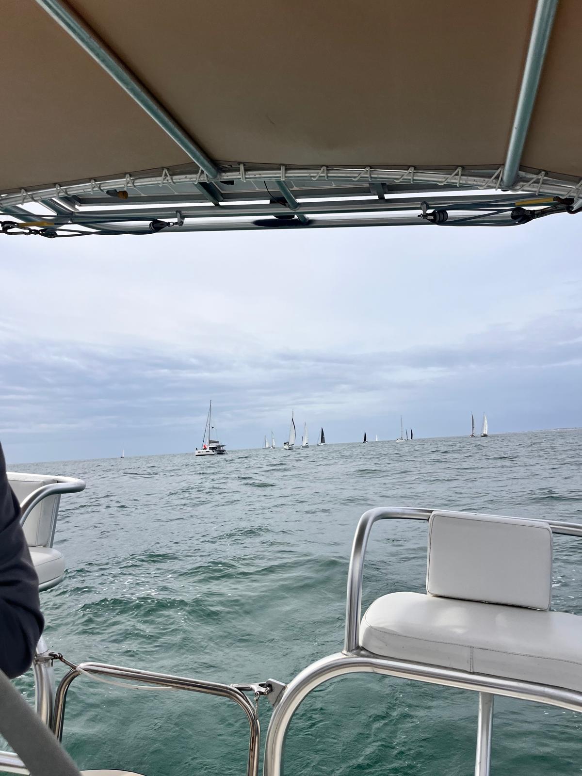

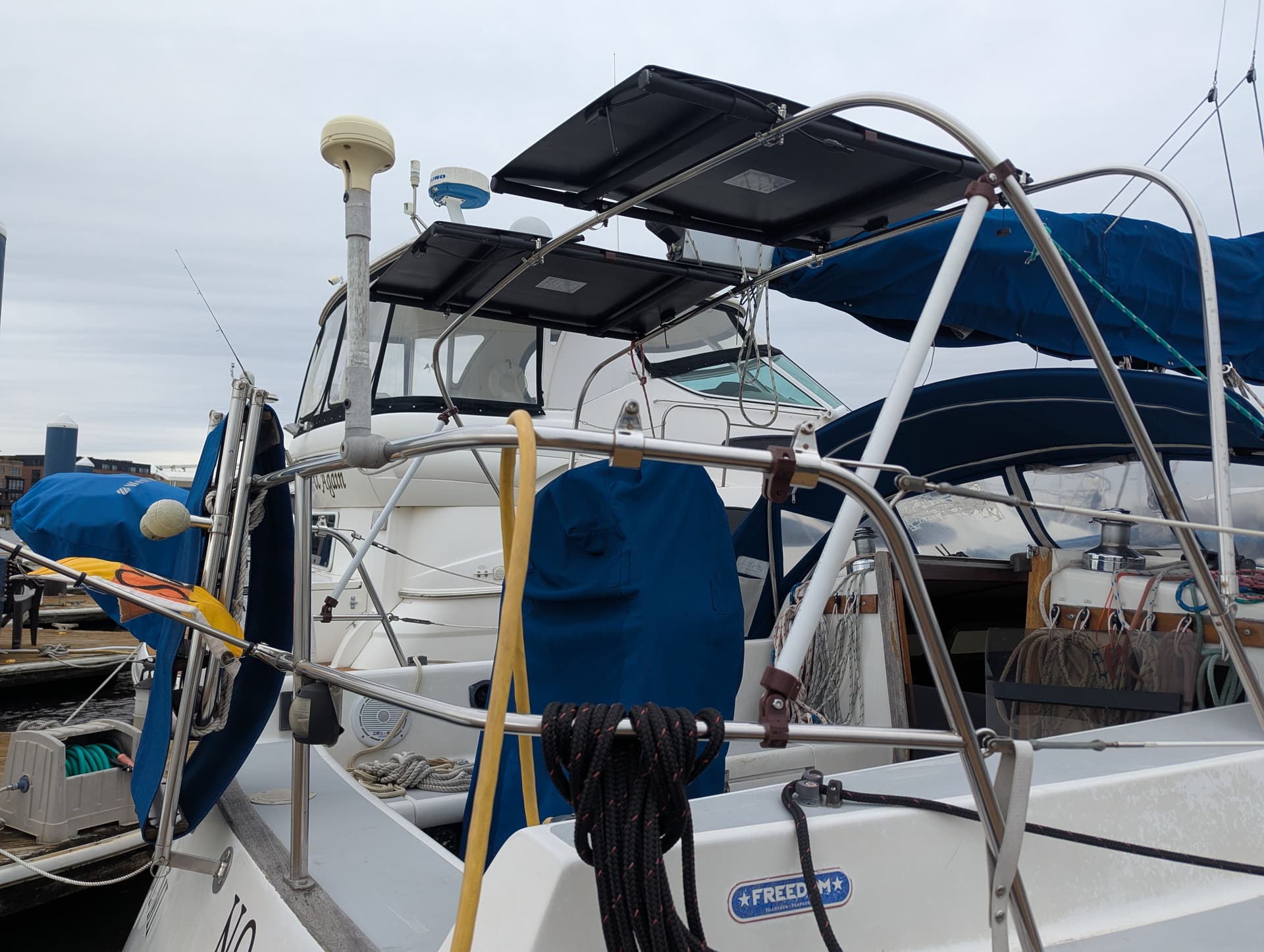

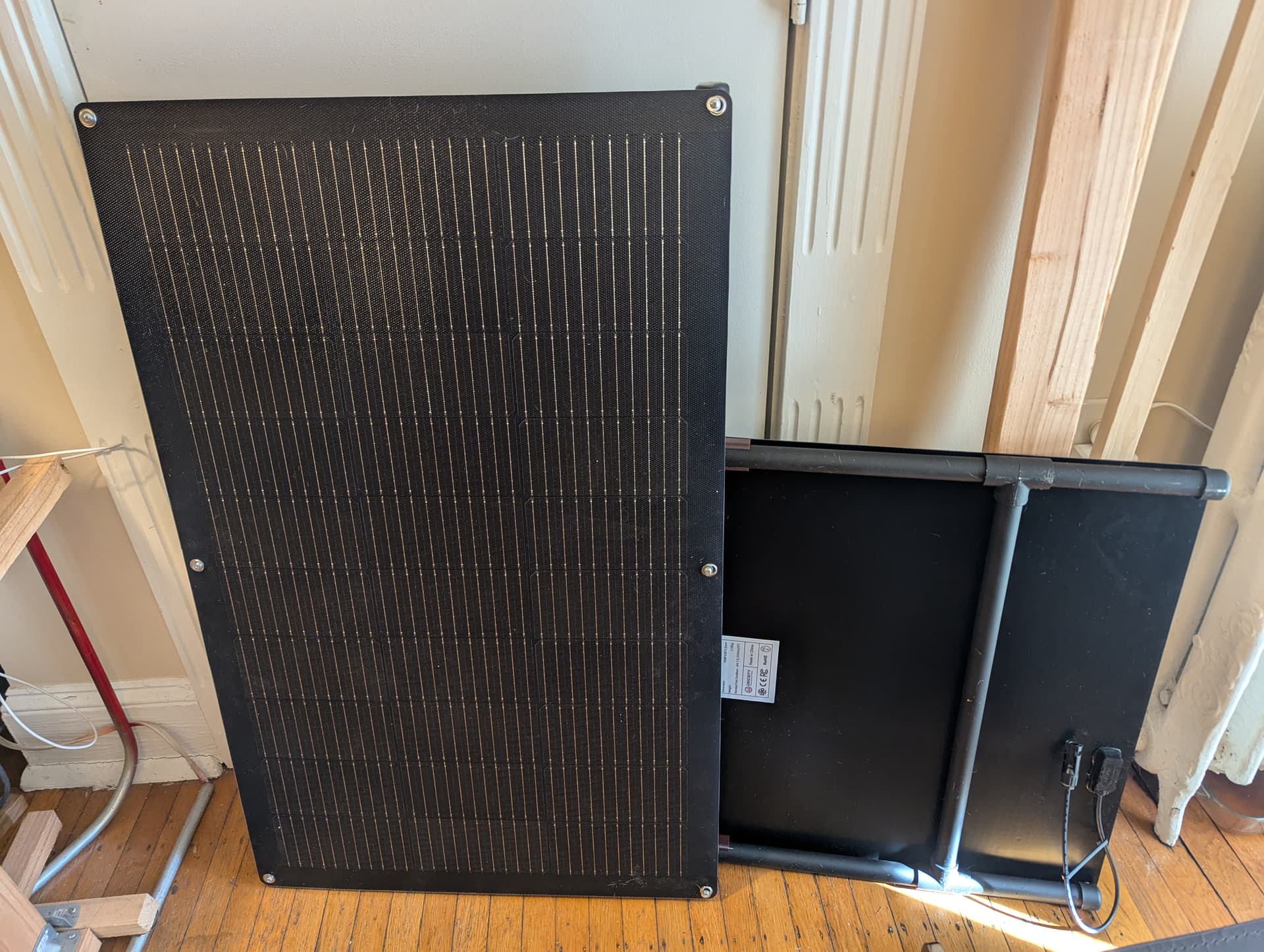

I actually just did this on my F30. I used some PVC pipe to make a few frames for a flexible solar panels and hose clamped them to my bimini.
My F30 came with a standard (?) hinged pipe bimini that was far too flimsy for a big rigid panel (I have one that weighs maybe 40lbs). The flexible panels are really lightweight though, and Amazon sells them for sometimes less than $50/100W.
This project is really easy to do (in my opinion) and so far I’m very happy with the results!
Will send you better picture if youre interested.
