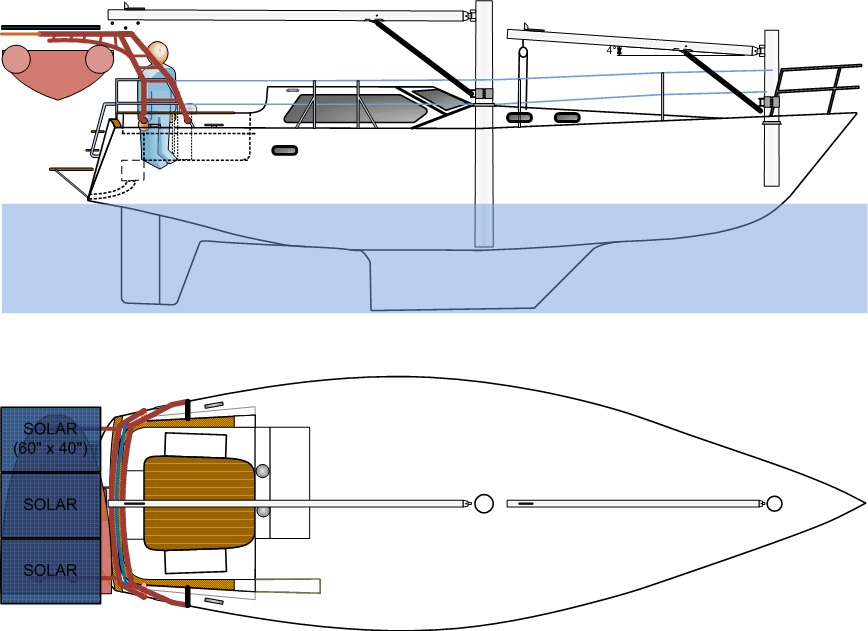

The timing is interesting because I am currently working on this for my 39PH. My current idea is to build a multipurpose arch over the cockpit. The goal is to solve the following:
  • move the mainsheet traveler out of the cockpit both for safety during gybes, and to allow extension of the bimini aft to protect the helmsman’s neck
  • davit arms for the dinghie
  • support for solar panels
  • support for bimini
  • radar mast
This is a preliminary design drawing. I’m currently working on the 3D model and calculating the loads and stresses. My main concern right now is attachment point of the arch to the boat. The deck is not wide enough the have the arch’s feet bolted through the deck. The only alternative seems to be of attaching the arch to the coamings, but I don’t know if they are strong enough. I may need to increase the laminate…
Any comments or critics are more than welcome! If you can destroy the design, please do! :open_mouth:
