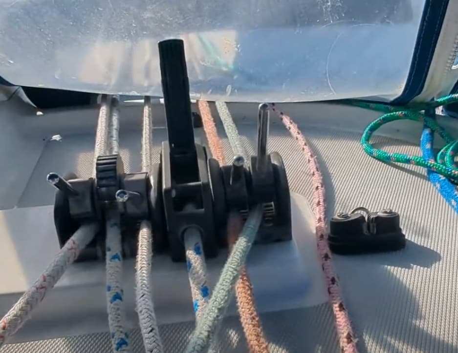

Mine is only the baby (F21) but the same rigging setup. I have pole adjustment and clew lines to clutches on both sides of the companionway. However, pretty much any cleat would do. When flying the spinnaker, the only time you need to adjust these lines is when pulling out the clews prior to hoisting the spinnaker. I rarely adjust them under load.

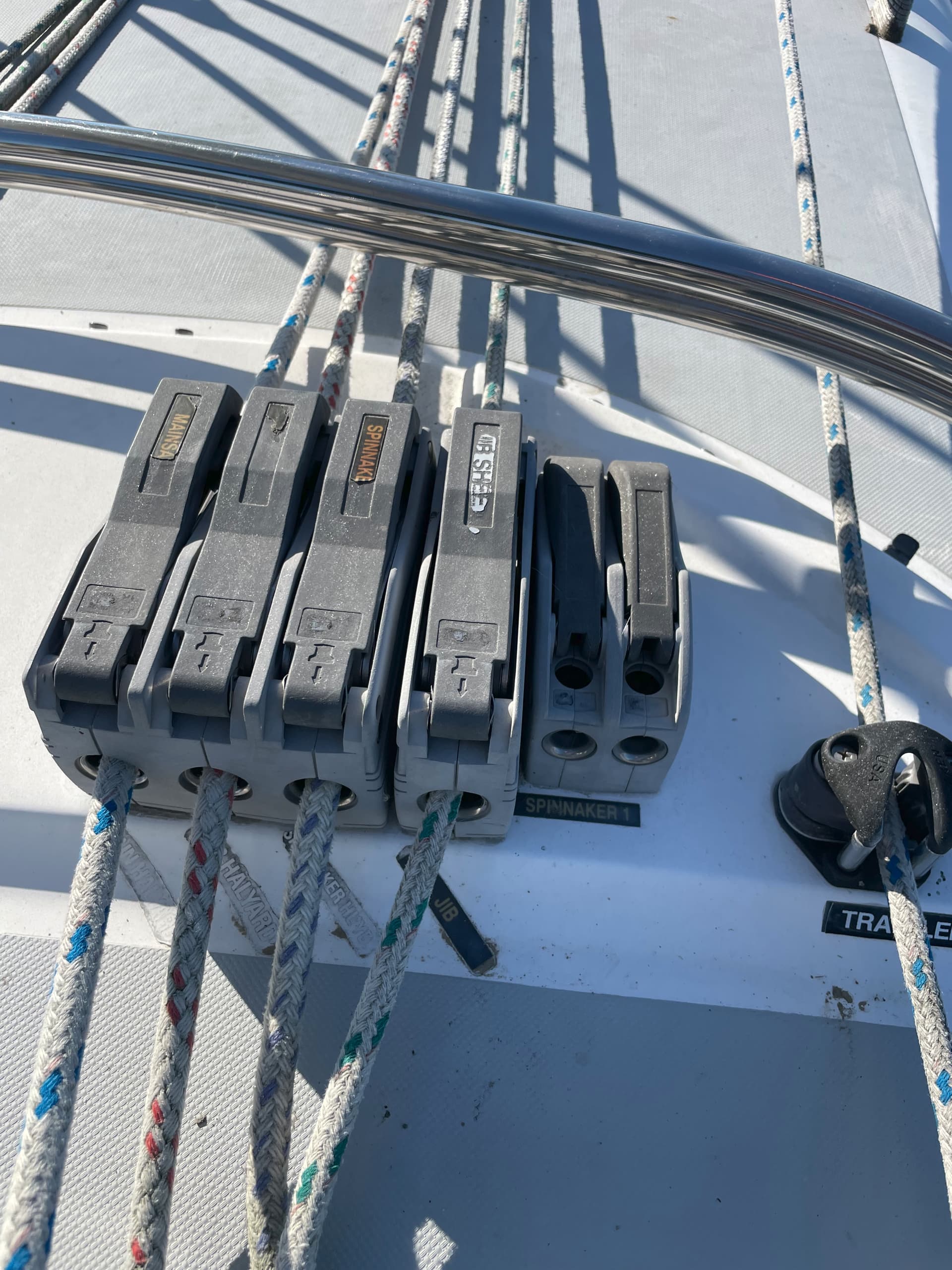

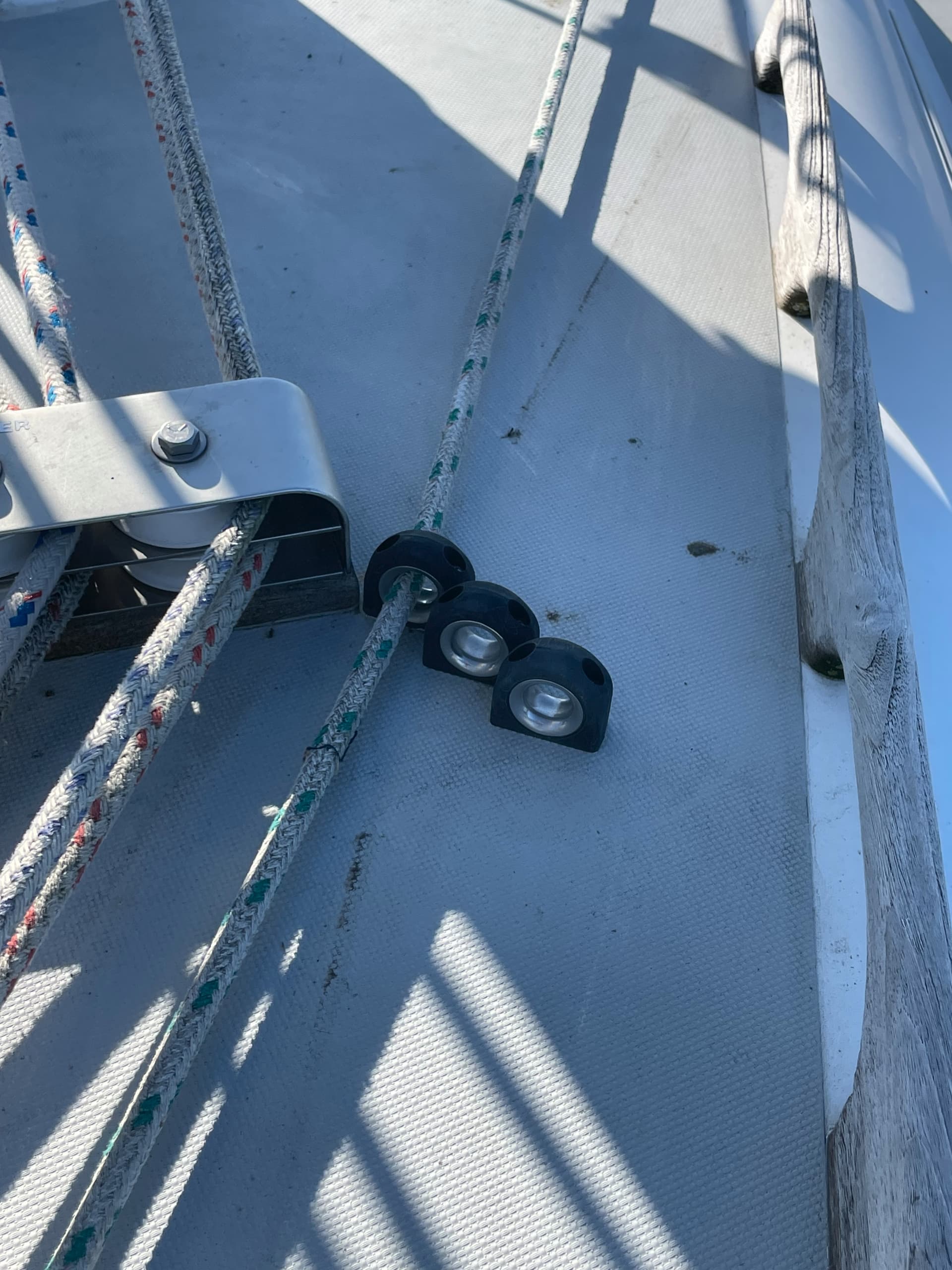

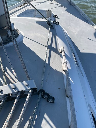

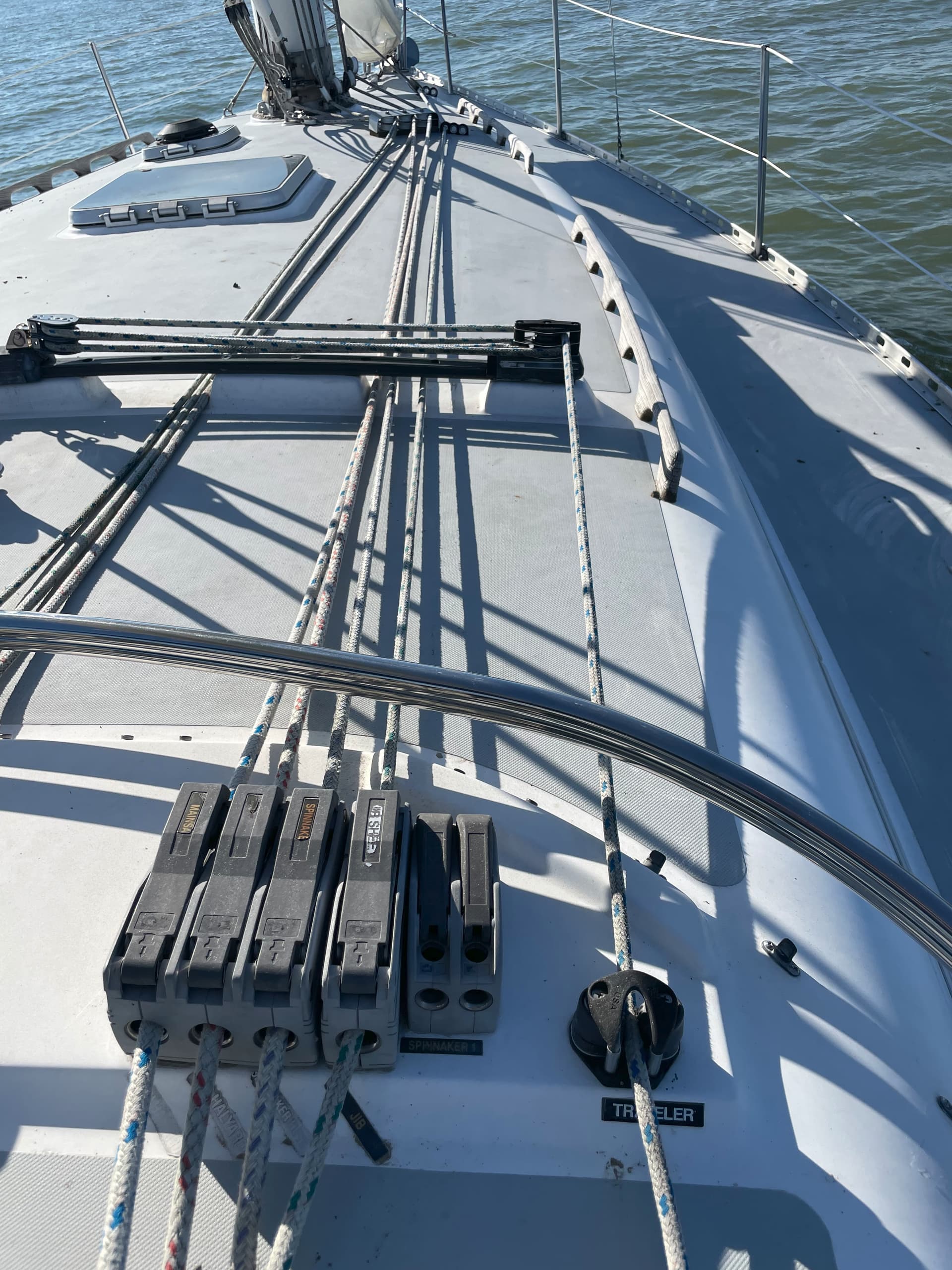

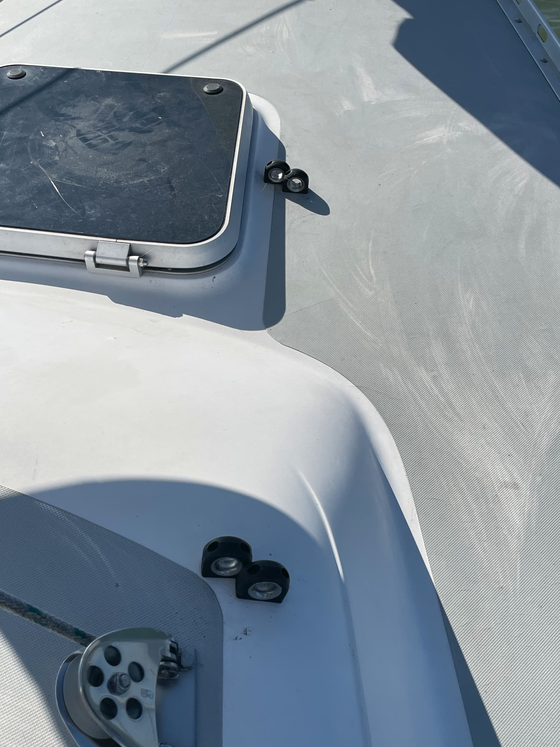

I have a Freedom 36/38 like you on Lake Erie … the “clew lines” are called the spinnaker sheets … they feed down to the base of the bow pulpit (port and starboard) through a turning block .. .here are the pictures of my fairlead mounts from the front to the cockpit where my two spinnaker sheet clutches are mounted. My spinnaker is not rigged in the pictures but you can see the hardware mounted
I didn’t take a picture of the turning blocks at the base of the bow pulpit so just ask if you would like a pic of them as well.
