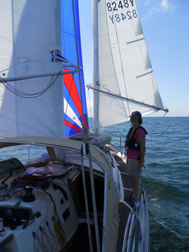

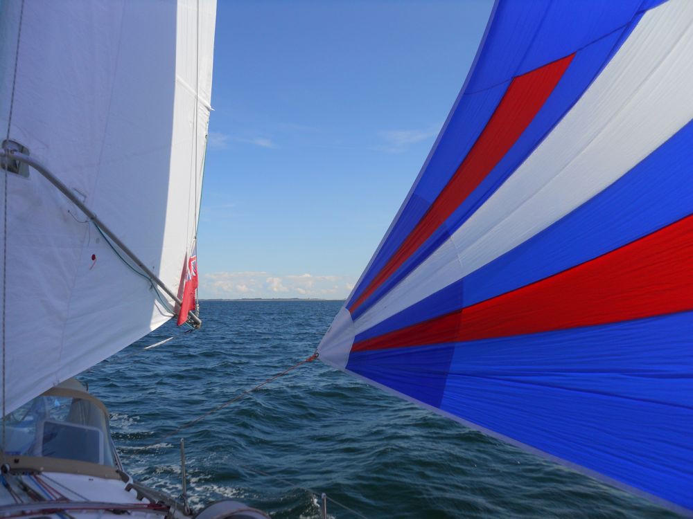

I have one or two pictures of staysails set, but you need a really wide angle lens to see them clearly. You can sheet a large staysail via a snatchblock on the end of the mizzen boom when running; it keeps the sail drawing, and it is usually best to drop the mizzen to avoid blanketing the staysail. When on any sort of reach, keep the mizzen set and sheet the stays’l to the toerail right aft.
[/img]http://www.freedomyachts.org/download/file.php?mode=view&id=804&sid=6c123aa1baab5a7612d46147dee57d55[/img]
view from cockpit with all sails set, wind from about 120 deg apparent
view of stays’l sheet
I don’t have any idea of the dimensions which might suit you boat, and this sail is cut a little too flat for best downwind effect. It is about 30 sq m, (300 sq ft) The original was much fuller aloft, but the sailmaker who did this one had his own ideas about the shape, and it likes the wind more abeam than abaft.
