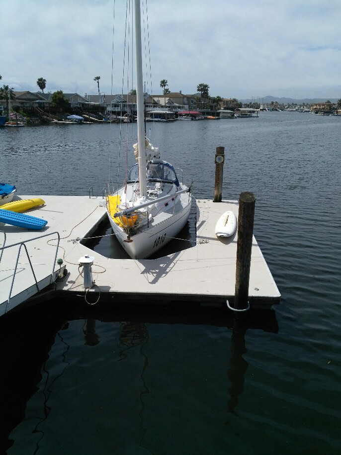

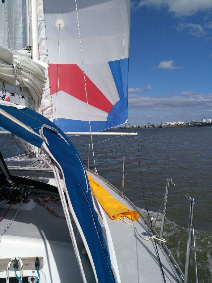

Finally finally got the gunmount set up completed on Jacqueline, my F30. Although I still need to tweak the rig, I flew and doused the chute twice during a recent sail into the Cali Delta which is a perfect flat water testing ground. Those here who have commented on the ease of use were spot on, it was fantastic! In 8 Kts AWS I was at hull speed around 6.2 Kts. In a seaway I would have been surfing like crazy. Rick Simmonds stated the reins would not be loaded with the sail up. I didn’t believe this but he was absolutely right. I was jibing the boat with a casual tweak if the reins. Wow.
There are definitely tricks to be learned on dousing, that process needs to be smooth as silk, especially as the wind starts to pick up.
Need to get out there and do some more practicing. Its not like its hard. You could set and douse the sail ten times an hour and not break a sweat.mm

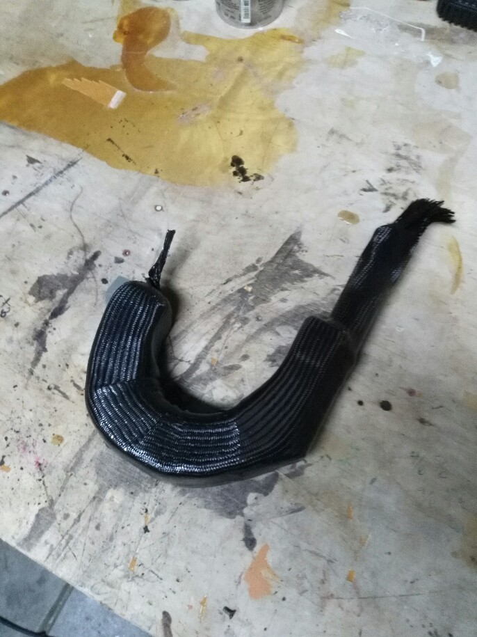

If you decide to go for it, I am building carbon pole brackets. I could make you a couple if you want. Here’s a pic of model #2 (an improvement on model #1 design which is on the boat). It fits right over the existing stanchion and my lifeline threads through the pole part on the right side. I just need to drill the lifeline hole and clean this piece up. I plan to build four of them for my boat so I can adjust the stowed location of the pole depending on conditions.
BTW, although the bracket looks heavy it is actually foam cored so the whole thing weighs, maybe, 10 oz or so.

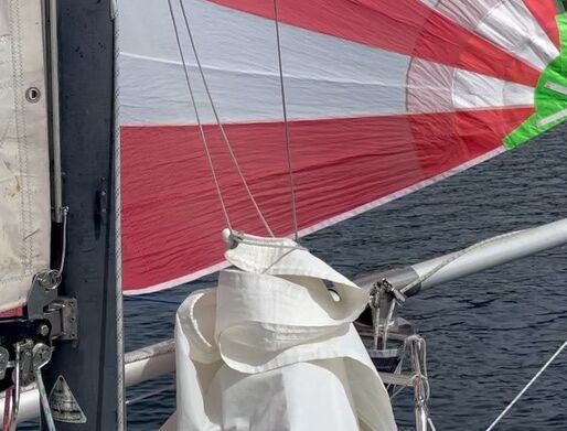

Can anyone share photos of their spinnaker sock attached to the pulpit. I’ve never felt good about the way I have done it.
Alan, sorry it’s just a small clip from a video but this image shows the right hand side of my spinnaker sock. To add to that I have 4 lines at the mouth of my spinnaker sock and one below that. The lines are tied (now clipped) to the 4 corners of the pulpit, making sure they stay at the corners. I clip to the reinforcing strut underneath. The bottom line attached to the bottom of the front pole.
I hope this helps.
