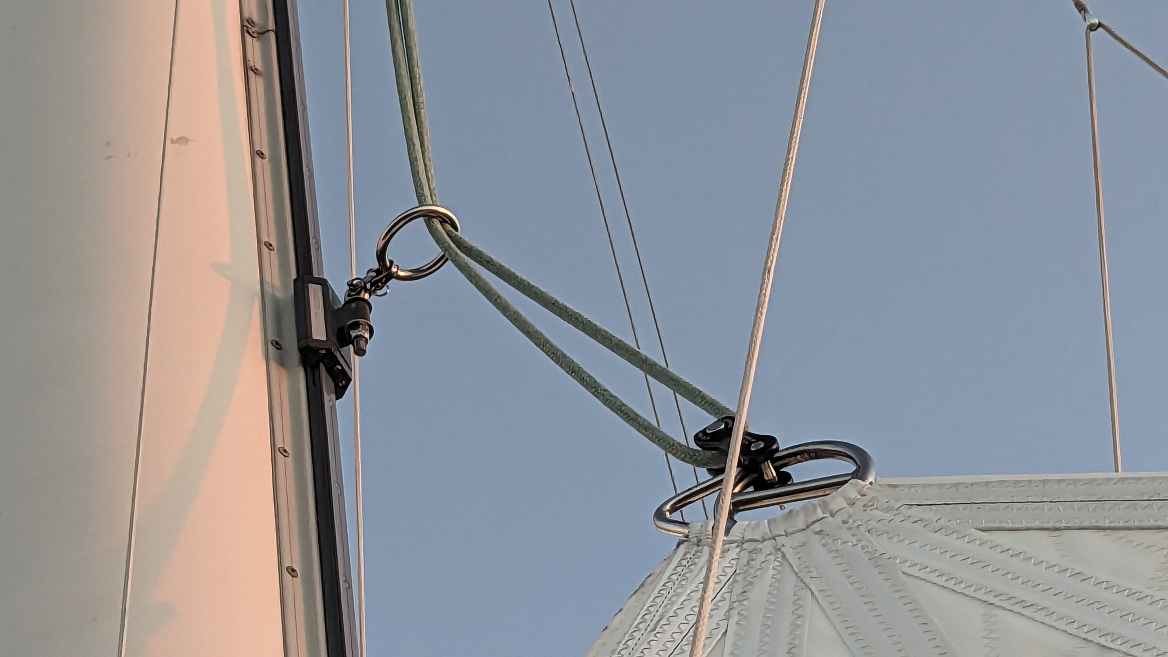

I figured out a solution that allows the squaretop main to automatically pull the head of the sail to the mast. Normally I would have to pull the head of the sail to the headboard car and insert a pin. Since I have a harken battcar system the battcar stack is so high (and I am short!) that I have to stand on a small ladder to insert and remove the pin. There are very expensive solutions to this problem such as the Doyle anomaly headboard. There are also very complicated solutions such as the one used on Lagoon Catamarans. I figured out a simple cheap solution that works well.
I fix a large ring to the headboard car and pass my double ended halyard through it with a tylaska H8 shackle on it.
See Picture
The shackle slides in the ring and holds the head of the sail surprisingly well.

I like the solution you came up with, very elegant, simple and cheap. Well done.

Here is a better view of the halyard and the model number of the drill. Note that when the halyard is taut it will make the shackle more vertical and pull the sail toward the mast.
