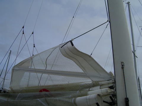

I also looked at the Anomaly headboard and decided that the price must be anomaly. I have a simple solution I used on my F38 at first and now on the F45.
In normal Bermuda sail the headboard is fixed on the top slider or car. I now have just a shackle made on the headboard and run the halyard through the shackle before
attatching to the headboard. Works fine all these years so far.
Hi Hans,
Thanks for the reply. Seems like a simple (and inexpensive) solution. I assume the halyard goes through a shackle (“D” shackle?) fixed to the headboard car on the mast track and then it is attached to the headboard with a shackle at the end of the halyard.

pic of setup (not my boat)
