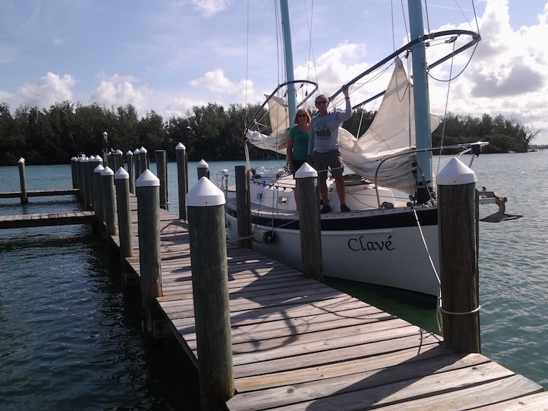

The previous owner of our freedom 28 cat ketch upgraded to squaretops from Knighton sailmakers Sarasota Fl loft. My first squartops.
Make sure they include a system to unplug your gaff batten. It is a pain inserting the battens and they need to be removed when the sails come down unless you like a 10-15sq ft shark fin flying all the time. I found that was more sail than I wanted at 60knots;-) But it makes our look even more distinctive. The sailmakers each have their own way to release the gaff now. And they call it by a different name. I think it is a good addition if not included in your initial bid.
Here is Clave just before hoisting and sailing away from the dock:
