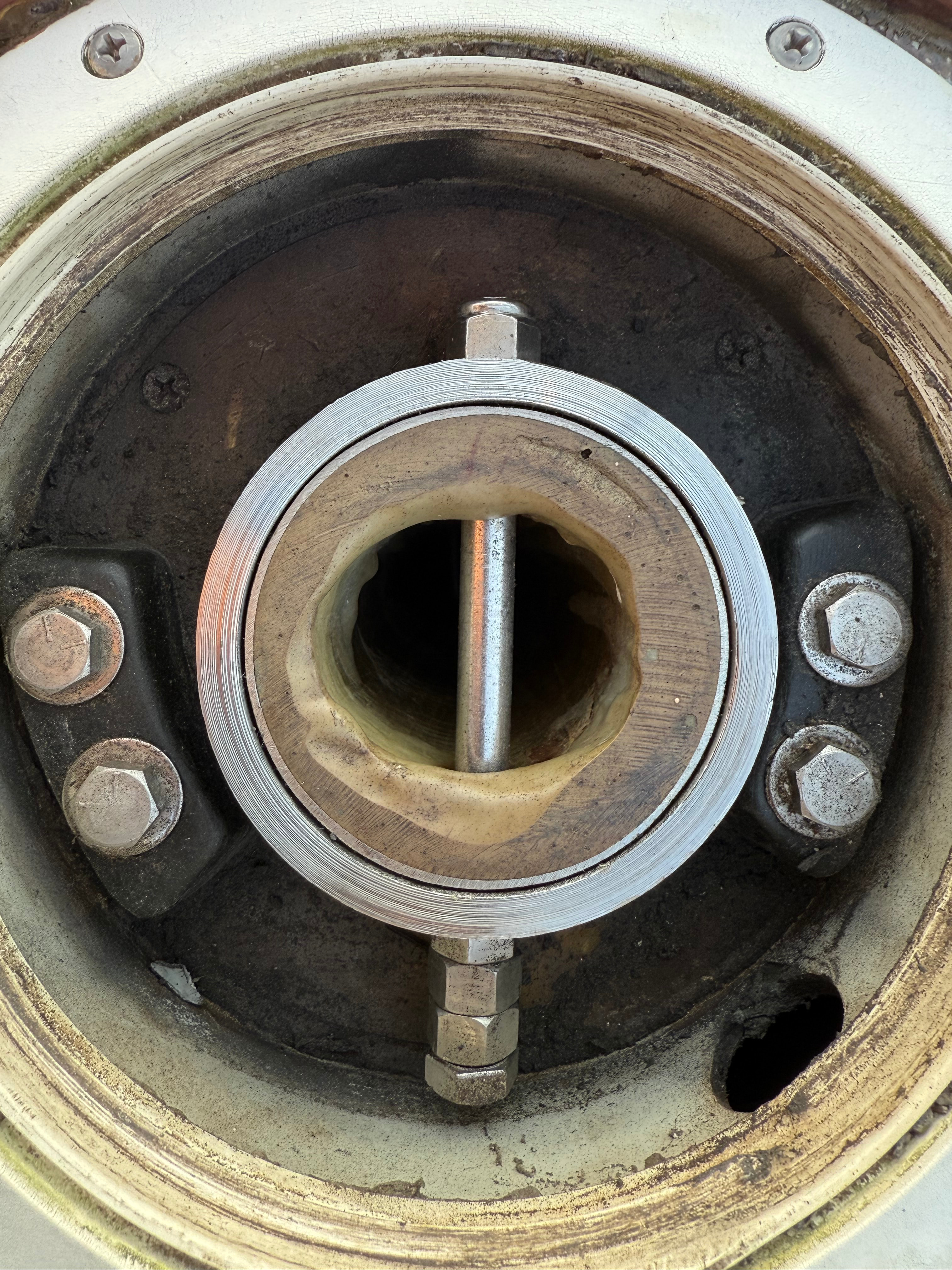

Hey there, pretty old topic, so maybe I’m out of luck, but I noticed this weekend some creaking coming from what I think was the same area on my ‘87 F30. Does anyone have any information on what’s going on in there, and what kind of maintenance is recommended?
What does the top of your rudder shaft look like, when you open the access port? Something like this?
