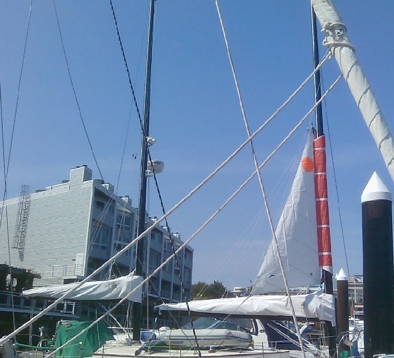

Here is a pic of my storm sail attached to the main mast. The sail is hanked around the mast. In your case with the wishbone boom, the control lines for the boom may be in the way for this setup.
Happy sailing,
Jim D.
Gotcha! I’ve seen this design commercially to fit over a furled up jib or genoa. Neat…

That trysail is rather impressive, Jim. I see no reason why it couldn’t be used with the wishbone boom, as the boom uphaul is on the aft side of the mast.

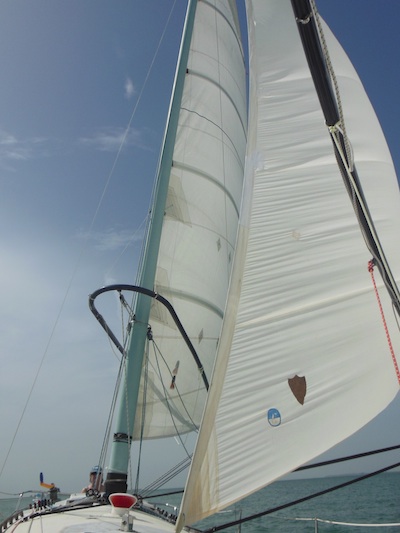

This is the only picture I have showing our blade stays’l set. It is about 2m from tack to clew, and 9m luff. This is a picture of the owner, rather than the sail!. Castaway came with four strengthened pad eyes on the coach roof to which the small and medium stays’ls can be set; we never use the medium one (which my daughter christened the ‘sh*tsail’). The big cruising chute is tacked down to the toe rail right forward.
We always use a running backstay from the masthead, opposite the halyard, with any stays’l. The PO told us that he once had the block on this break, in an acceleration zone between the Canary Islands; the mast bent alarmingly until he could release the sheet, but it didn’t break.
I have sailed with just the cruising chute, and the boat handled normally on the helm, but never with just the small stays’l.

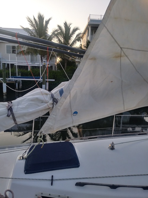

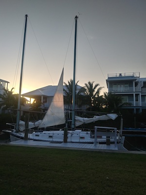

I have a storm sail. Designed to be flown in staysail postition from front of cabin tack on a 3 foot tail from mizzen mast halyard. Never flown in significant wind.
Our light air staysail flown from same location in this photo at top of its wind range.

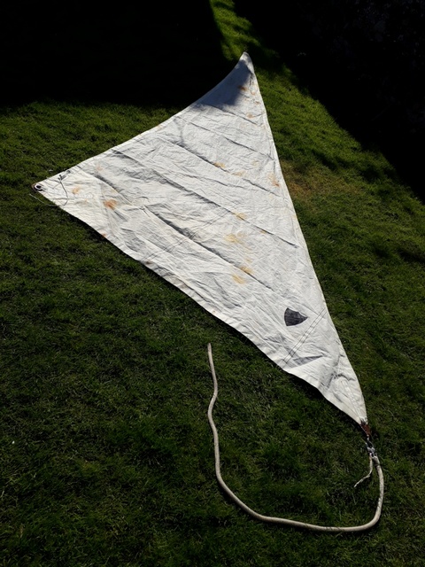

My storm staysail is original equipment. It may have been used by the first owner, but not since.
Luff 5.35m 17’ 7"
Leech 4.35m 14’ 3"
Foot 2.14m 7’ 0"
That leech measurement is the straight line. There’s a fair degree of negative roach.
Superb.

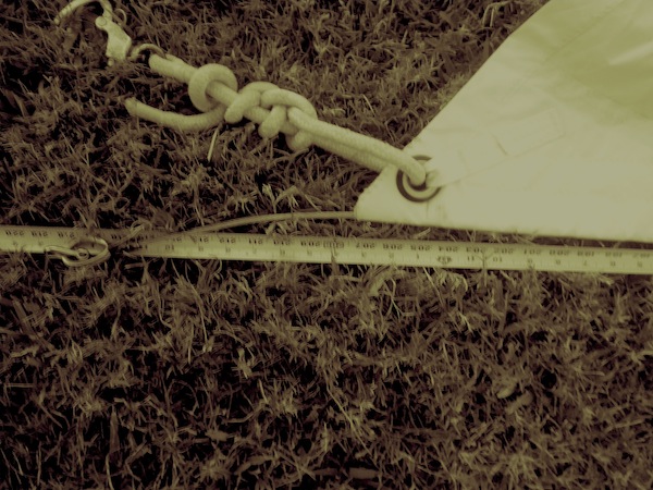

just returned from visiting my boat
My hamble fairways marine #112 has this sail.
Luff wire 220 inches. Sail luff 208 inches
12 inches wire beneath tack. Tack line acts as downhall.
Foot 88 inches
