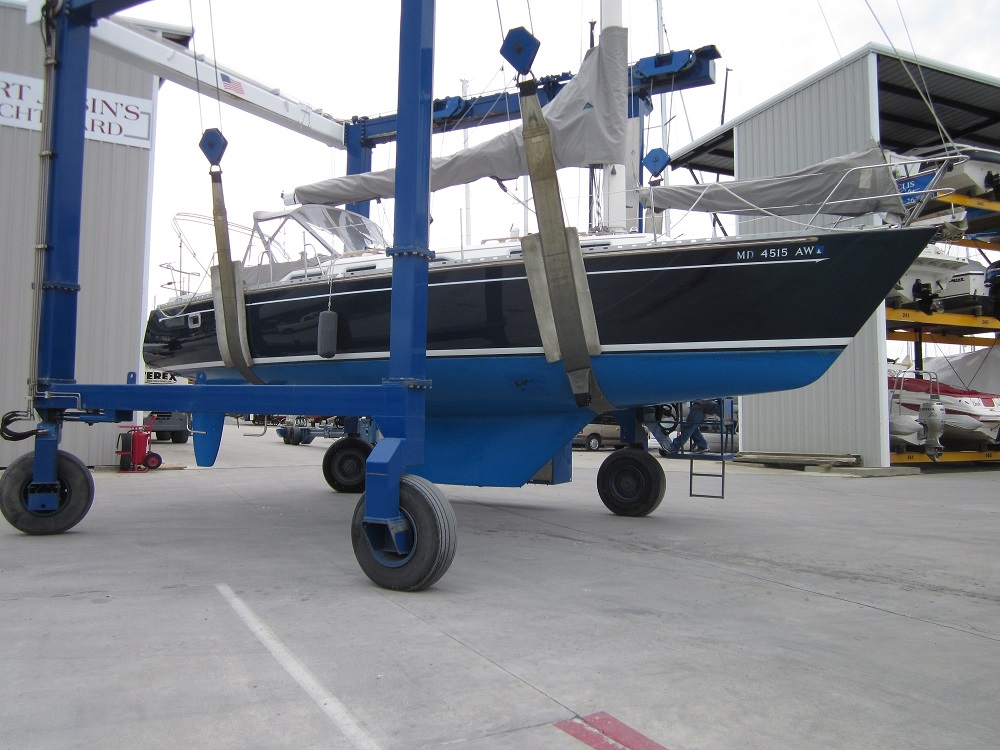

I had my surveyor stop by and do a quick “short survey” where he tapped the hull and went over the deck with his moisture meter. He then went below and looked at the major systems and general condition. All in all, he found the boat very clean and no show stopping problems. This is the same guy who basically talked me out of two previous boats due to condition. He’ll do the full survey next week or so when the alignment of my broker/seller’s broker/surveyor/yard travel lift are all sync.

  1. The rudder shaft looks, well, enormous. Very wide. Is there a smaller diameter steel shaft in there or is the whole thing carbon fiber?
  2. Are there any issues with delamination in the rudder? This was the only issue the surveyor found so far. It seemed to him that the fiberglass had pulled away from the rudder stock in some areas.
  3. From my reading, the keel (4.5 foot version) is connected by keel bolts. I pulled up the floor boards and could not find anything that looked like a bolt head. Granted,the bilge had been filled with antifreeze to a depth of about 4 inches, but I got down there with a high power light and could not see a bolt head. Were some of these boats made with encapsulated keels? It’s a 1990 vintage.

The fat laminate tube is the rudder shaft. It is laminated to the rudder itself and leakage between the shaft and blade is very rare. No metal shaft inside. One of the great things about this design is that there is no internal skeleton to break away from a metal rudder shaft. if there is movement in the rudder it is usually from one of 3 sources:
  1. The rudder has 2 stainless sleeves around the shaft that ride on 2 plastic rudder bearings (upper and lower - actually large bushings). These eventually wear out and need to be replaced. It’s a bit of a pain in the neck to replace them - cutting out the old ones and epoxying in the new… but they are available and come with pretty good step-by-step instructions.
  2. Slop or loose cables or loose components in the Edson Radial Drive steering system.
  3. Third is the most daunting. While Freedom rudders are well known for great design and generally great construction, the top sleeve (not the upper bearing sleeve but a 3rd sleeve), which is gripped by the radial drive, sometimes works loose from the upper portion of the laminated shaft. This is not common - and is usually the result of builders defect. If your steering cables are properly tensioned and your wheel is locked - and you are able to rotate the rudder, chances are the upper sleeve is rotating inside the radial drive, OR the rudder shaft is rotating inside the sleeve. I know this because we lost the rudder on our F30 as a result of this defect. As I said, it was the result of very rare corner cutting by TPI. Guessing our rudder was built late on a Friday and the fiberglass shaft was a bit short. Instead of adding to it or just rebuilding the rudder, they attached the upper sleeve with the fiberglass shaft only fitting about 1/2 way up the sleeve - rather than all the way through it. They then poured resin on top to fill the upper part of the sleeve, where the upper shaft was absent. As a result, the bolt that goes through the radial drive and upper sleeve did not go through the fiberglass shaft. It took 16 years to work its way out - but after about a year’s worth of strange and unexplained slippage in the steering system (center rudder mark on the steering wheel kept shifting) we went over a large wave… stern went up, rudder slipped out and rest was history. Thank goodness for TowBoat US. As I said, - very rare, but worth checking if the surveyor finds this kind of rotation.
Yes Freedom rudders can delaminate like any other brand. It can result from impact, water incursion, faulty original lay up. Not uncommon to have to rebuild a rudder blade after 20 years. Not terribly difficult or expensive (relatively speaking). As you already know from previous boats, BOAT is an acronym for Break Out Another Thousand…
Our 4 1/2 foot draft wing keel is external ballast, bolted to bottom of sump.If the boat you are looking at has a 4 1/2 foot draft modified fin (shoal draft) keel, it is likely internal ballast - so no bolts.

My fingers could not type fast enough to get the online version of Good Old Boats Jan/Feb issue. Man your boat looks sweet. I’m glad to find out I’m not completely clueless when it comes to searching for keel bolts and based on the information in the article, I do indeed have an encapsulated ballast. I will forward your comments the rudder structure to my surveyor. Due to weather and scheduling problems, I have to wait until 4/3 for the sea trial/survey.
