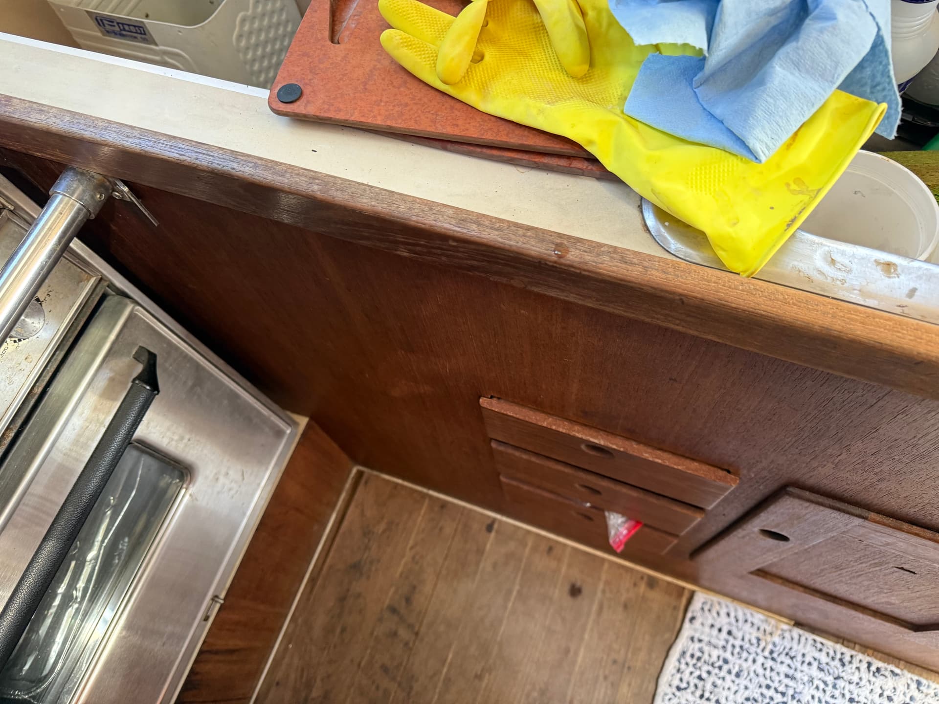

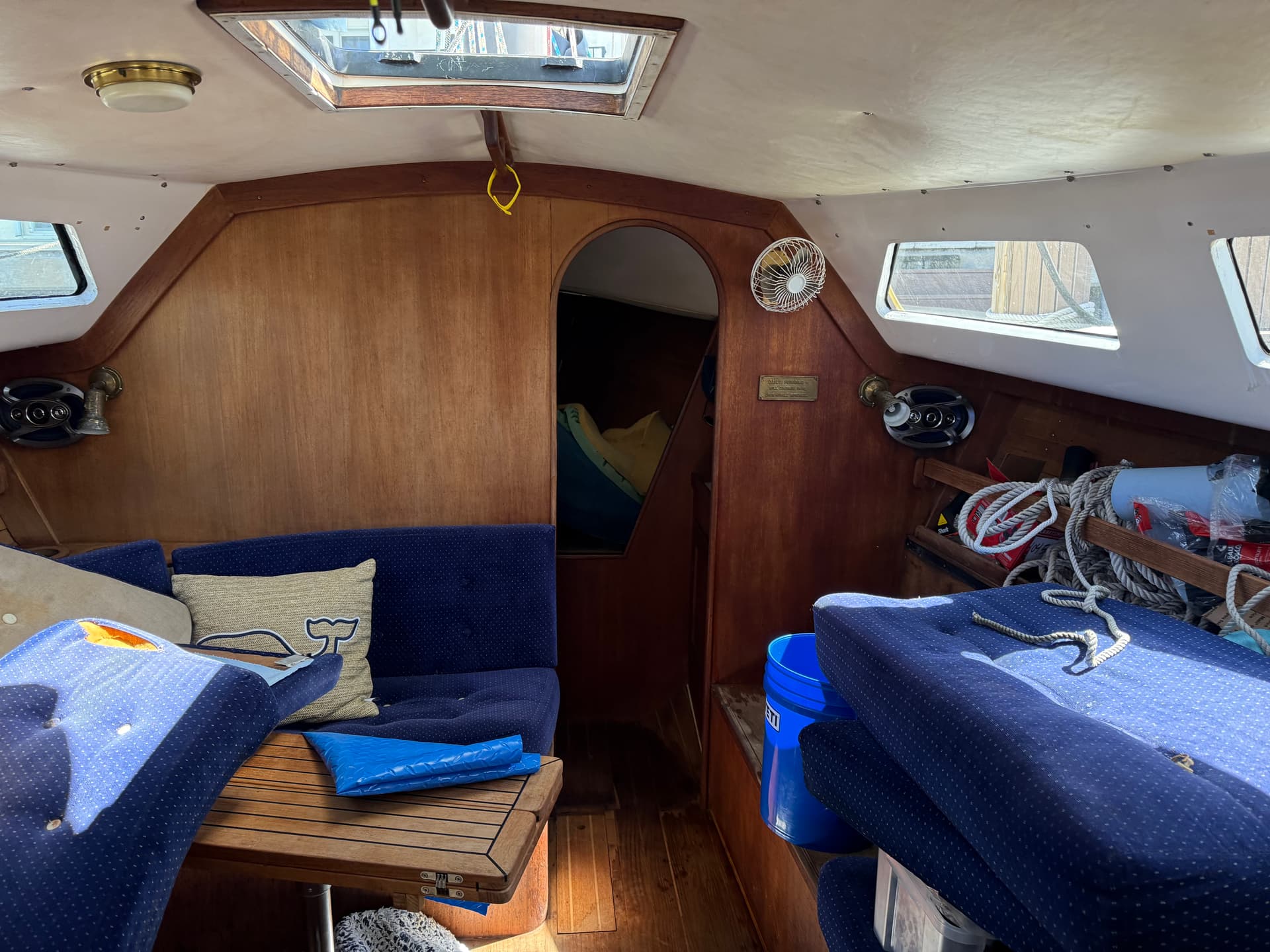

Pictures on wall on left is cleaned, right is not yet cleaned. On galley rail left is not cleaned, right is. May varnish galley rail as it gets wet a lot.

The real issue is the sole. The teak and holly verner has come up in many places, not well sealed in corners and probably not worthy of restoring. It seems that taking up the flooring is next to impossible without a total cabin disassembly. Unlike production boats, the sole seems not be be merely fastened to a fiberglass structure.
Has anyone dealt with this? Replaced it? Open to ideas (other than complete interior disassembly).

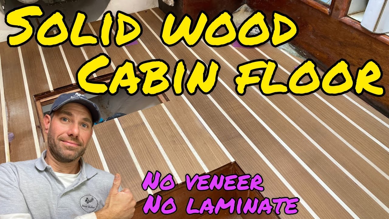

Here is a YouTube video of a fellow in UK who did a sole replacement with an overlay of teak/holly adjacent lumber. Teak has gotten ridiculous re cost. I thought this guys approach was pretty clever but it’s gonna be a big job
regardless.
