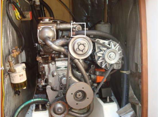

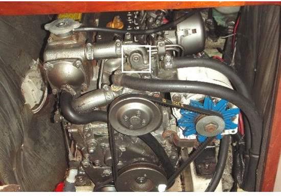

Several months ago I posted here about installing a water temperature gauge on my Yanmar 3GM. I did install the gauge without disturbing the origional temp sensor and buzzer alarm system.
The fresh water pipe between the heat exchanger and the thermostat has a 3/8 npt plug. See pics. I removed the plug after first heating with a propane torch (and allowing it to cool) and screwed a temp sensor in its place. I used a Teleflex Morse Heavy Duty Temperature Gauge and matching sensor.
I used an Edson Vision Series Single Housing with a side arm mount, placing it on the pedistal guard. For the gauge, one wire came from the sensor, one from the ignition switch. Light power came from the compass light which is powered by the navigation switch.
I claim no diesel expertise and have no particular qualifications except my career as a surgeon. Just sharing my experience…
