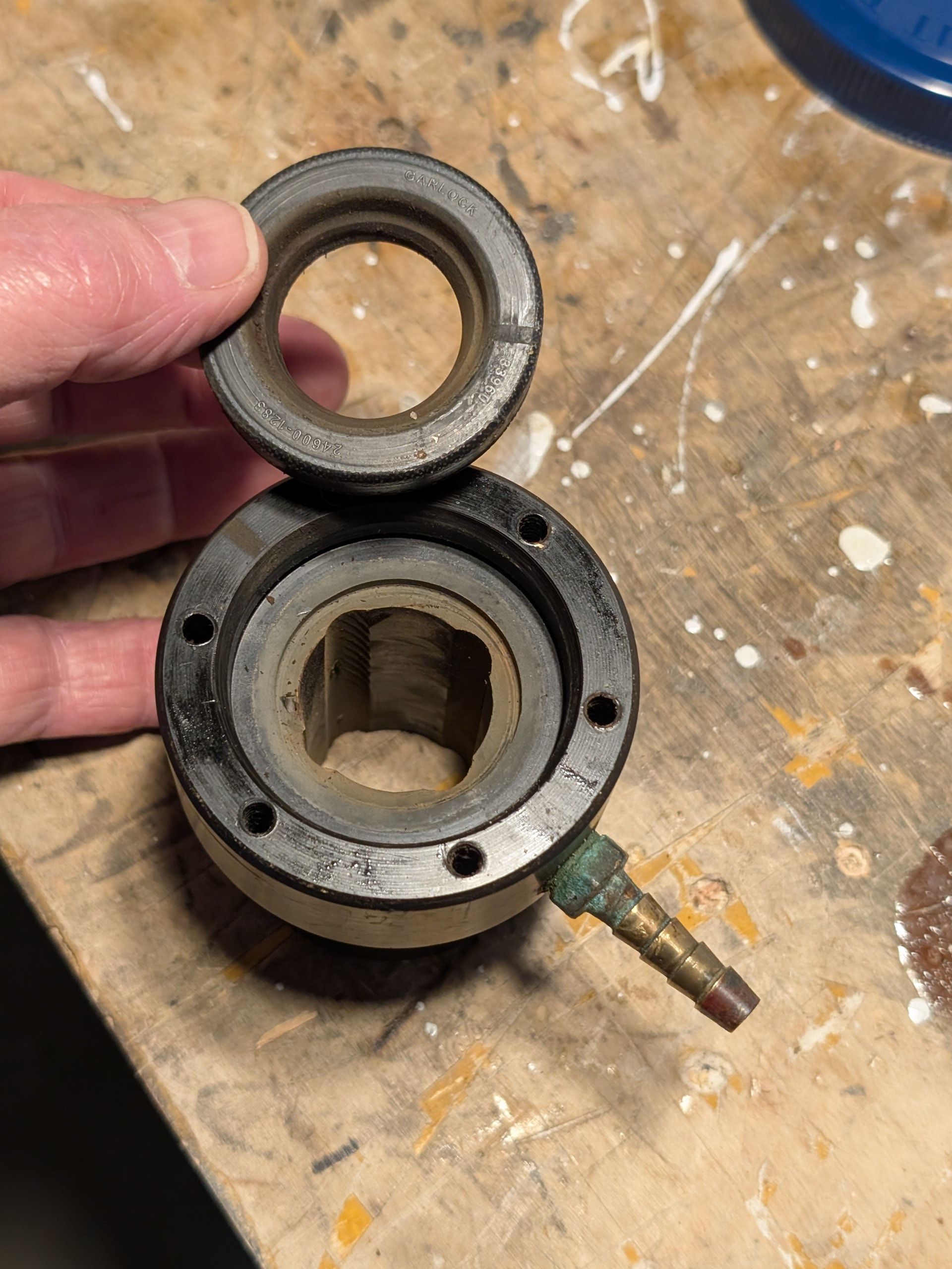

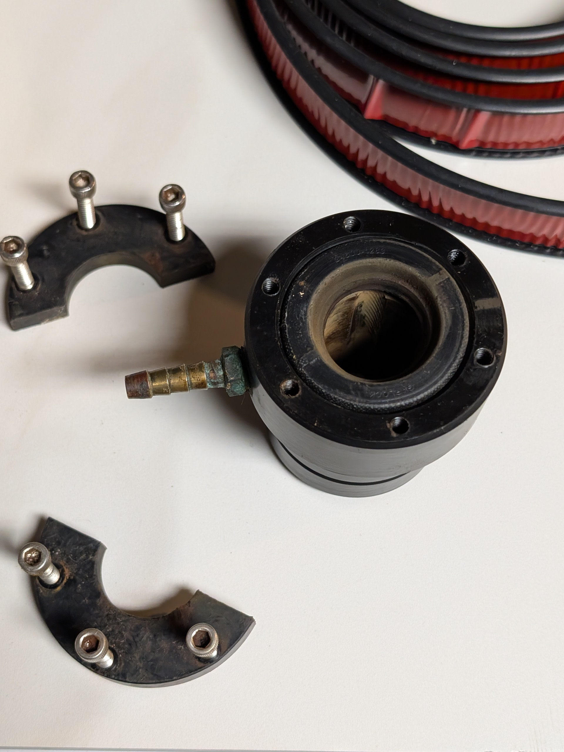

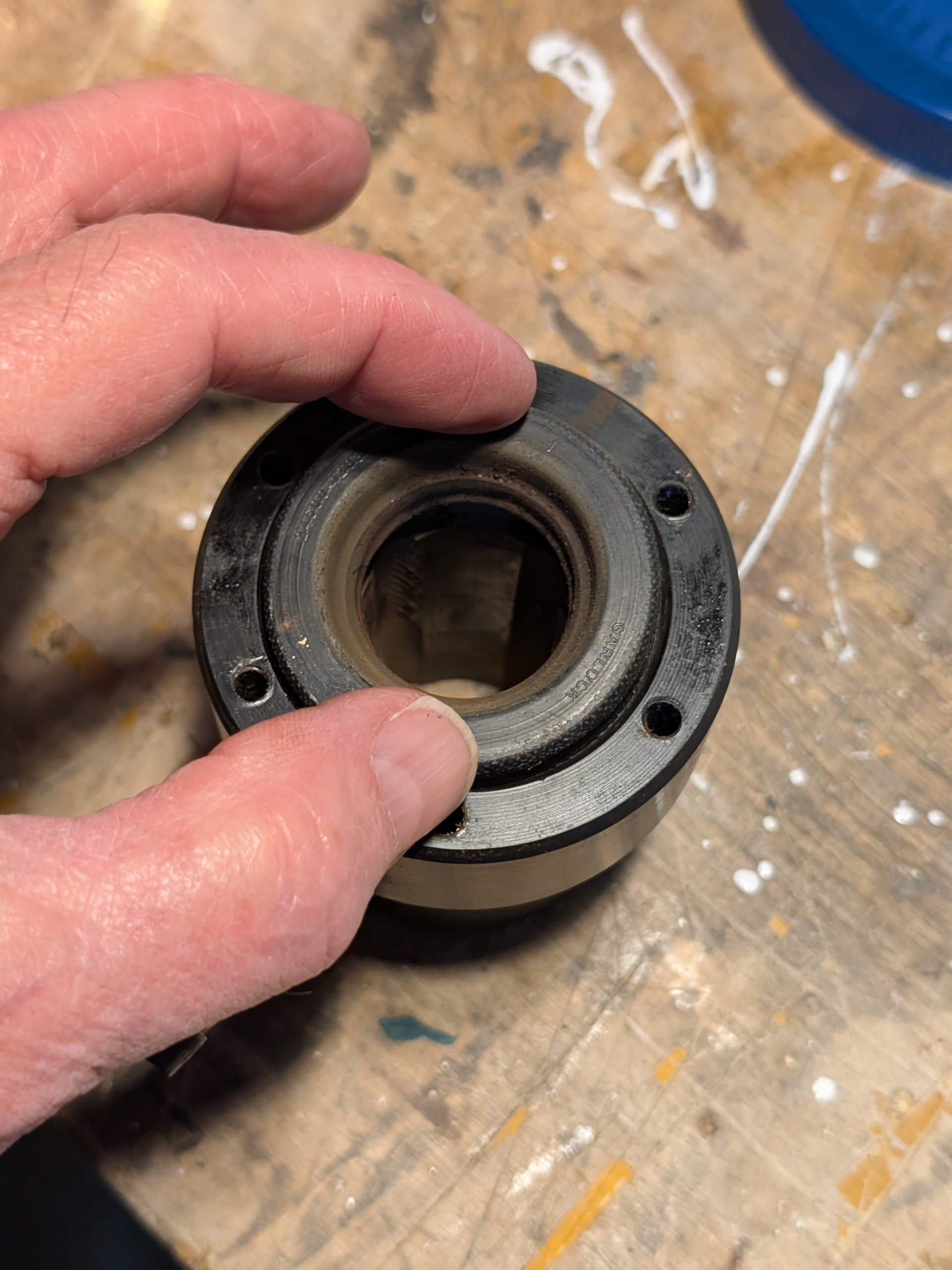

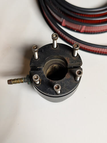

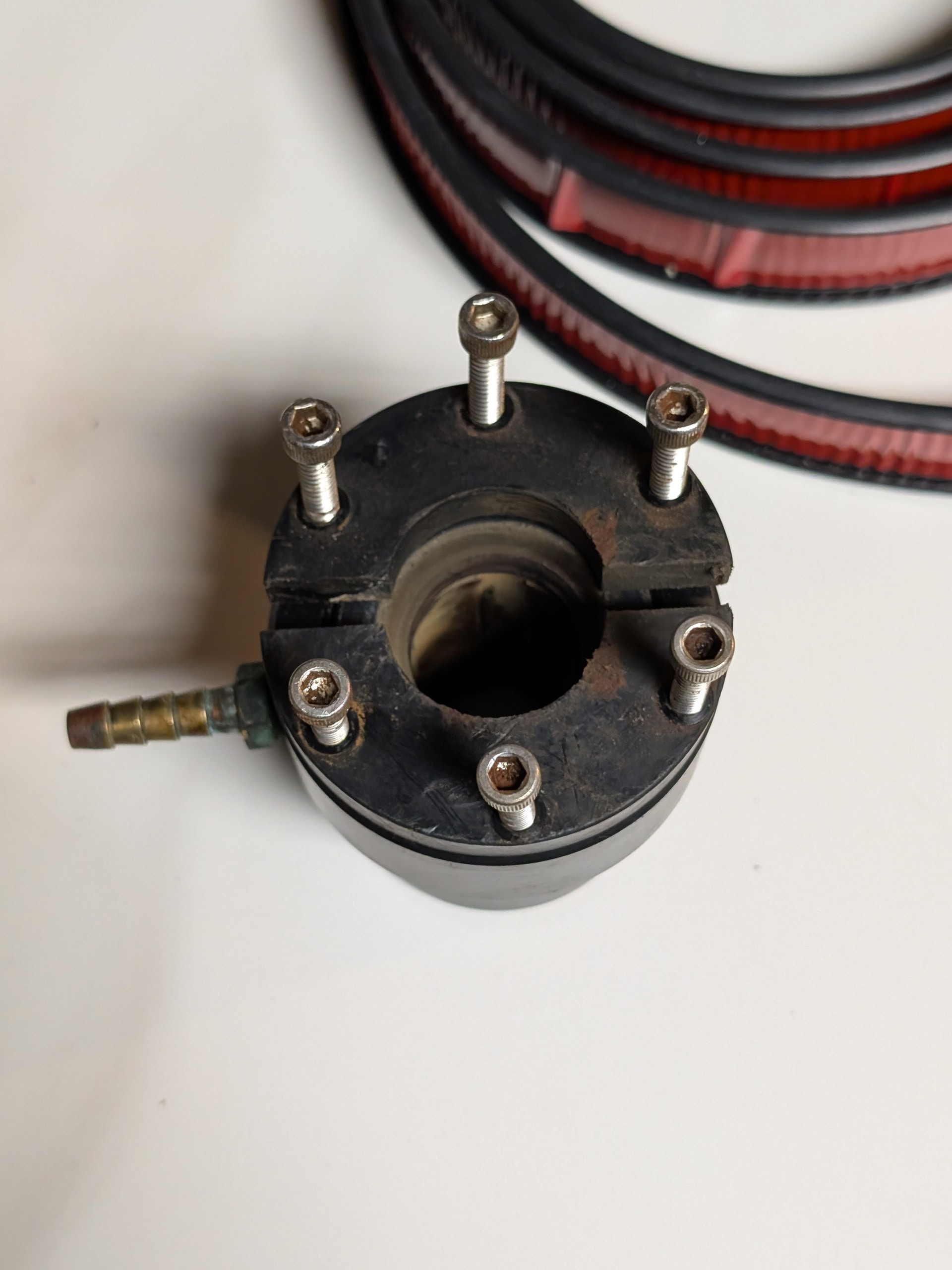

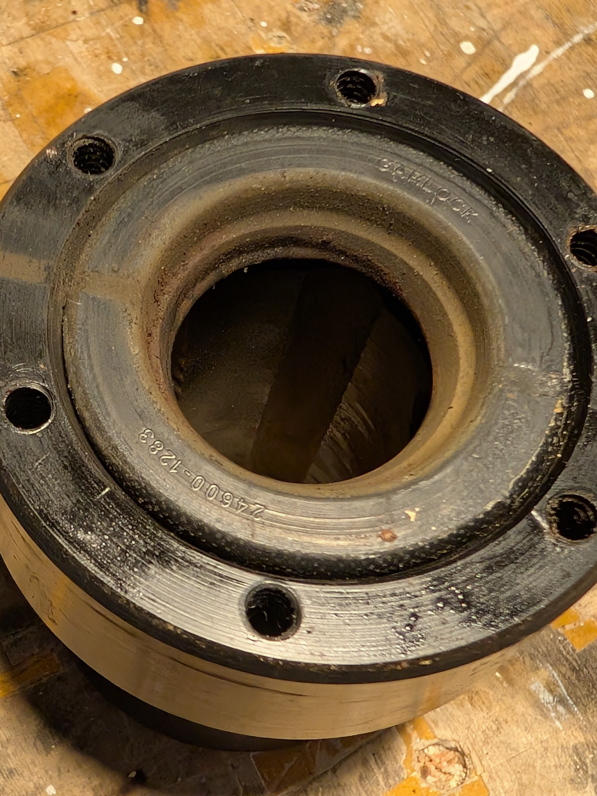

Anyway. Since I had the lasdrop out I thought I would post a little gallery of lasdrop seal photos so interested parties can see its component parts on the bench and for the record. I also took some pics of me extracting the lip seal from the housing so the curious could see how that works.
