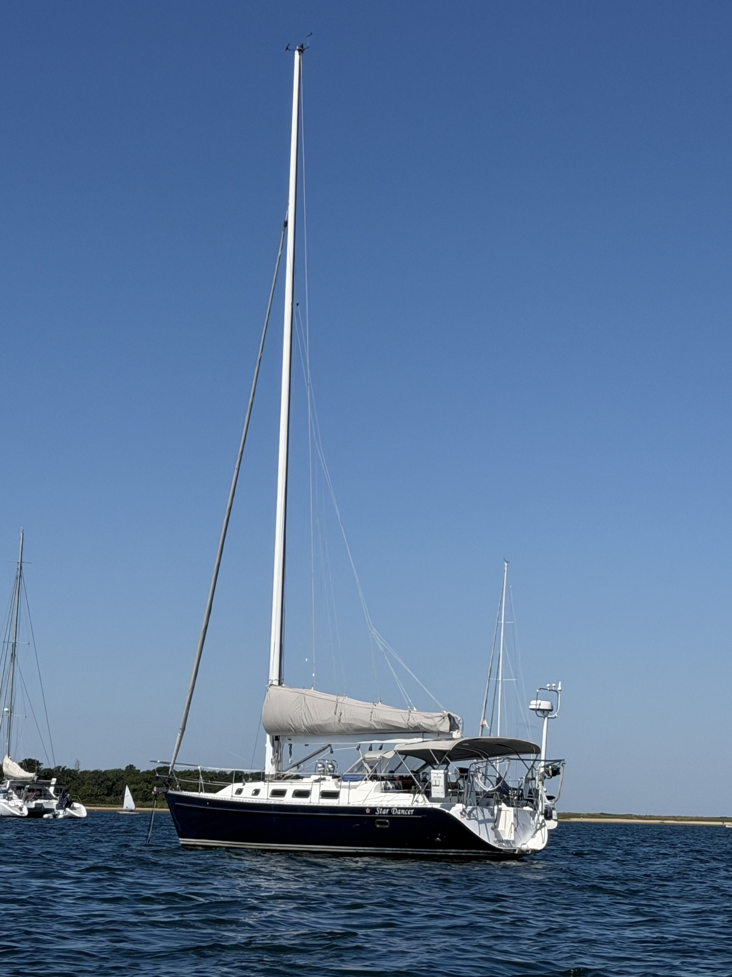

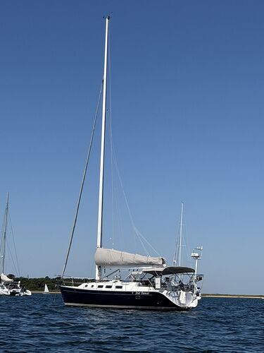

Hi Will, I did buy my 40/40 from Mass Maritime but it was not the 40/40 that they had for w few years, which if I remwmber right was named “North Star”.
My boat is hull #10 - Star Dancer
She is in great shape considering shes 31 years old.
Good looking boat. Great stack pack. Who made it? Where is she moored and was the furler rigged when you bought?
Thanks :slight_smile:
I keep her on Point Judith salt pond. The stack pack was made by Quantum and the furler was installed 10 years ago. Its a Harken. Works wonderfully. Theres times when i wish i had a camber spar but the convenience of the furler makes it such that the easiness of it all outweighs the performance. Without any exaggeration, I can douse all sails and have the stack pack zipped up closed in about 5 minutes.
