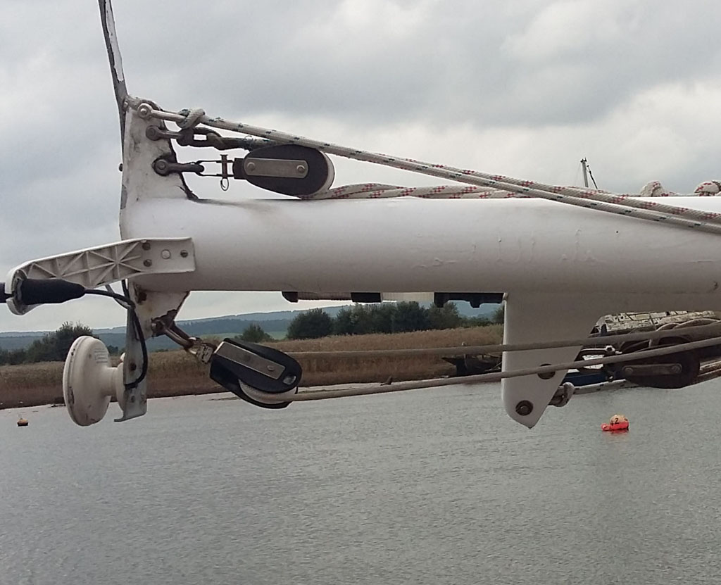

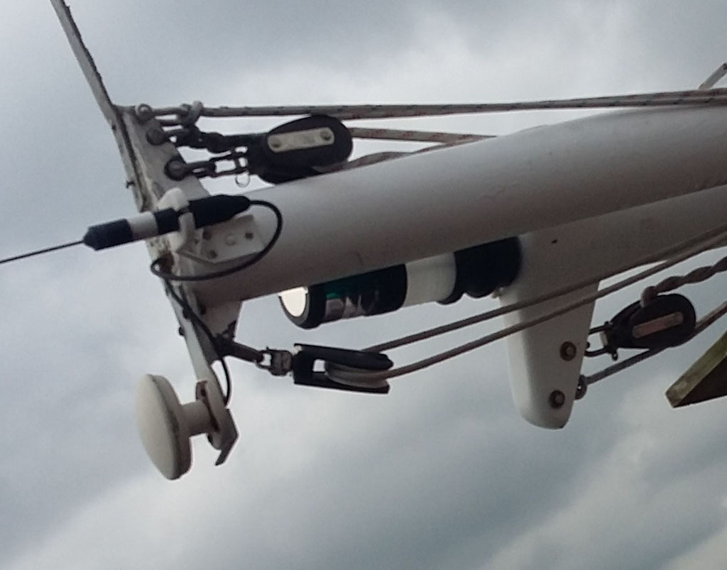

I must apologise. The boatyard wanted to move the boat as soon as they reopened on 3 January and I was pressed to get the masts rigged so they could be stepped while the crane was in the yard. In the rush I completely forgot to take photos. Here’s two taken when the boat arrived in the yard.
The crack in mine was on the other side (sorry) in line with the bottom edge of the crane and running straight around the circumference. (Note that the 30 doesn’t have a swivel in the crane)
You can see the moulded crane on the mainmast pretty clearly, pointing downwards.

The mainmast crane moulding is laminated about 7-8mm thick. I don’t know if it is carbon fibre or glass - it’s protected by a white flow coat. I think the mast was made by Carbospars, but I think they have ceased trading.
