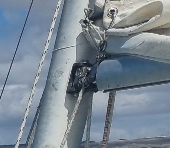

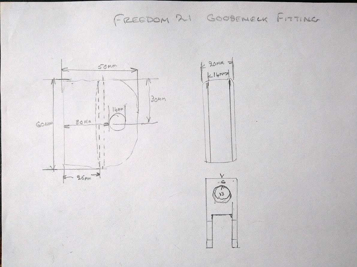

Hi, I also have a UK build F21 and my gooseneck looks identical to yours. I’m afraid the picture below is the best I can find at the moment. I also found the following sketch in the paperwork though which could suggest it was remade at some point.

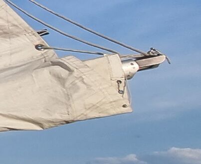

Interestingly the end of my boom doesn’t look the same as the others on this thread:
