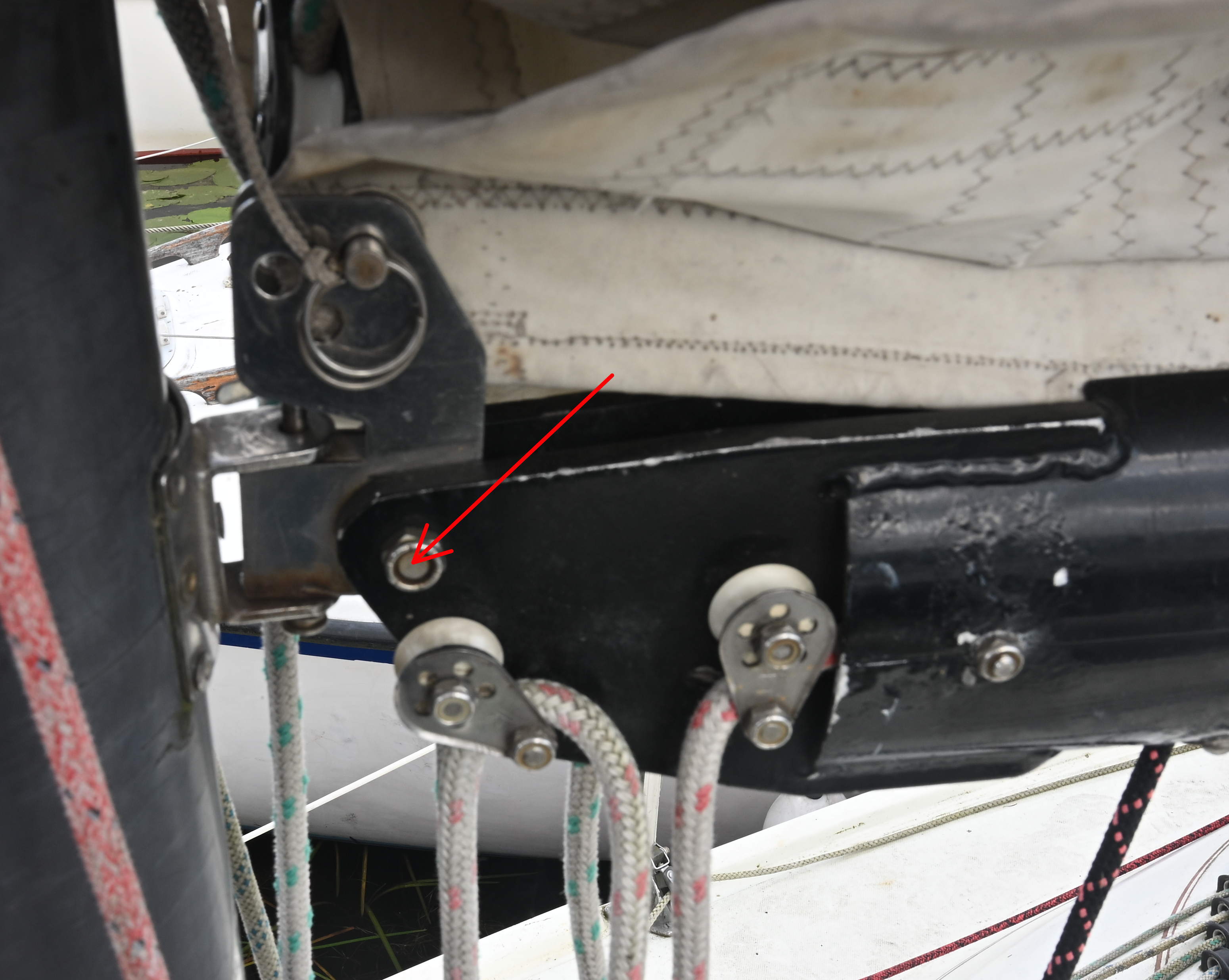

A closeup of the boom attachment showing where measurements were taken from.

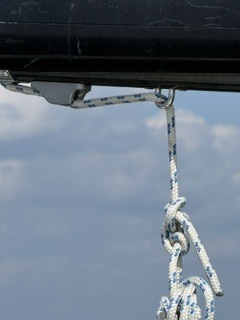

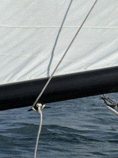

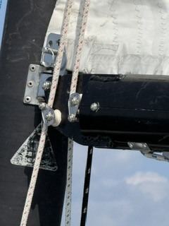

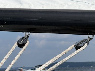

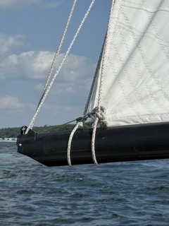

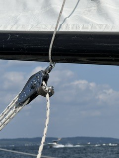

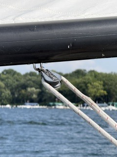

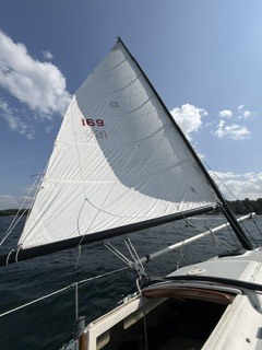

I sent 7 reply emails with boom detailed pictures attached but got some error messages. Did you get any of them and how many email replies did you get?

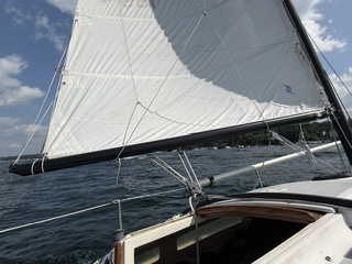

I can see the 9 images of the boom under sail that you sent over 2 replies 3 days ago. Very helpful, thank you. Are those the ones you mean?
I sent six email replies to your post with pictures attached. So you are missing a bunch and I did get error messages regarding too many replies. Do you have Apple devices? I could try a shared album if I had your email address or cell phone number.

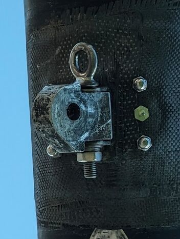

My F25 boom to mast attachment looks identical, except that I have a carbon fibre mast.

Thank you for confirming. That’s reassuring, but noted you have the original carbon set up.
If you happen to have a picture of you’re goose neck/mast fitting, it would be helpful for me to compare
