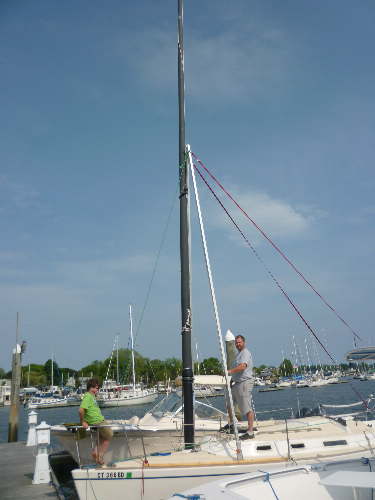

For my F25 a made a 20 foot A-frame out or 1 3/4" sq aluminum. After unscrewing the L bracket at the base, and disconnecting all the wires, I make sure the mast loose at the deck level. With my boom vang pulleys and an old halyard attached above the center of gravity on the mast (tied down to the goosneck to prevent slipping up) and at the top of the A-frame, I am able to lift the mast up through the deck hole. In order to lift the base through the deck hole the L bracket has to be removed. Then it is just a matter of lowering the mast and laying it on the bow and stern pulpits.

Our local yacht club has a mast hoist for member use. Ask around and see if any of your local clubs or marinas have one. If you can find one the price is right, and you don’t have to make and store an A frame hoist.
The F25 mast is quite light, and two people can easily raise and lower the mast. One person to manage the mast, and one to raise and lower on the hoist winch.
