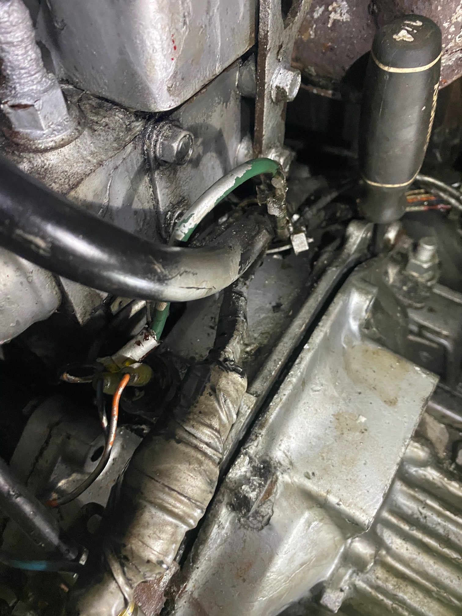

The Yanmar KM2P-1 Kanzaki transmission on my Freedom 36 needs service. I have watched numerous YouTube Videos and read manuals and I have made progress.
I have a Yanmar 3gmf30f and the Kanzaki transmission).
The Shift cable has been removed and is clear.
Misc Wires have been removed and all is clear.
The Shaft plate fully clear and I have the room I need to slide it back/off.
All the bolts holding the Transmission have been removed and I can rotate/turn the transmission a little to confirm nothing is holding it.
I am able to separate the Transmission from the Engine by about 1/16 of an inch and have used a couple of screwdrivers (see attached photo) to try and get the transmission to slide off. From how it looks in the videos/docs it should just slide off the engine gear/sprocket.
BUT- it does NOT slide off as I had hoped. I have stopped trying to widge/force it off and instead thought I would ask here.
Does anyone have any tips ? Am I missing something or need to take something else off ? I plan to bring it to Mack Boring in NJ when I get it off…
Thanks in advance for any guidance/help/magic tips.
Regards, Michael

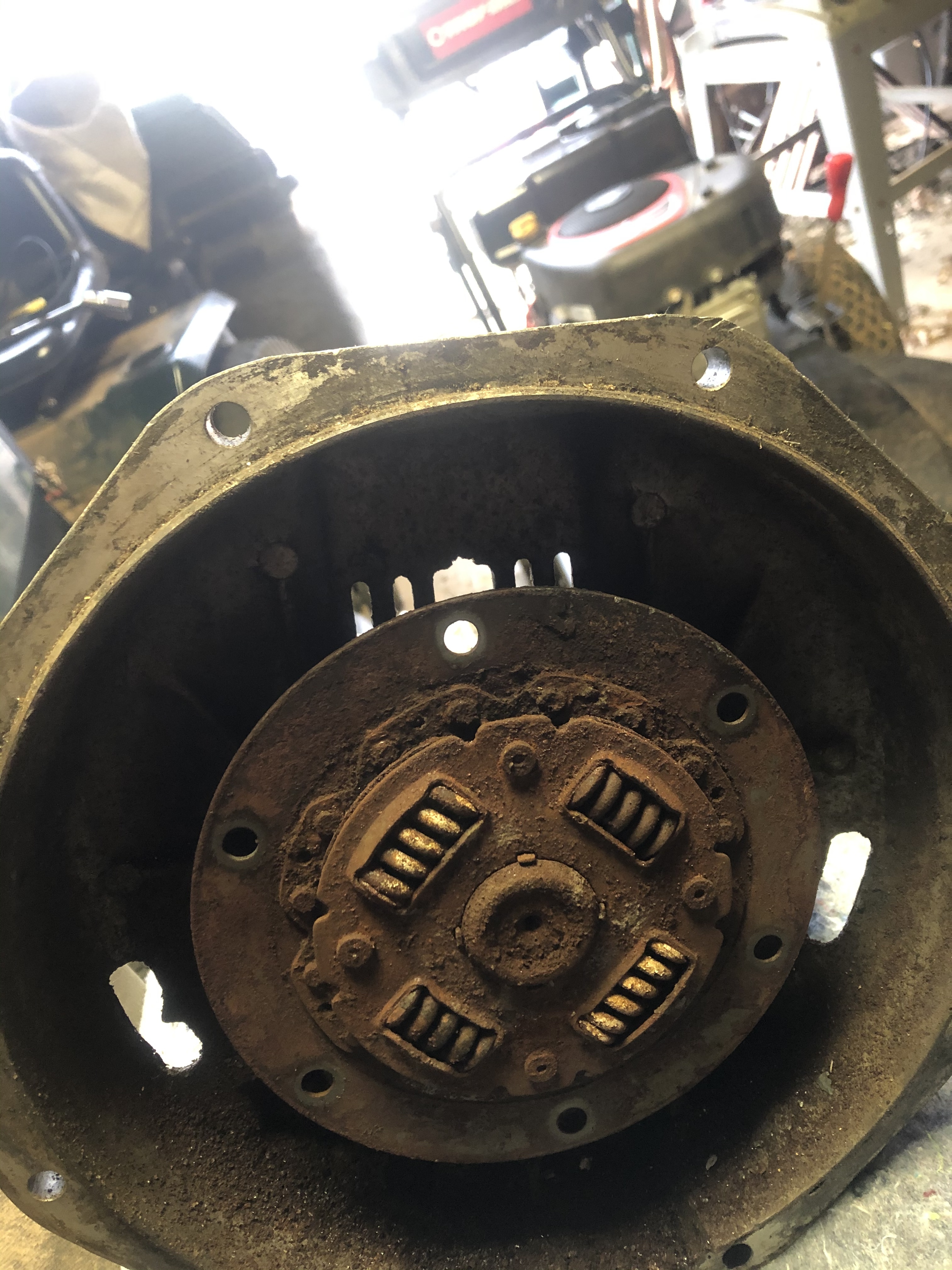

I am facing the same issue with my transmission and engine, Michael. There are no additional bolts of fasteners to remove. What you are faced with is the transmission input shaft that is stuck (rusted) to the drive disk. I have not spent a lot of time trying the free the shaft. I have sprayed penetrating oil thru the gap, hoping to loosen the shaft from the engine. No luck yet. I am also interested in finding out how others may have tackled this problem.

Found this suggestion online.
" knock out a few spokes of the vent. Then you can get a number 12 socket in and unbolt the drive plate from the bell housing. I think there’s six bolts. You’ll need to turn the engine to line up each bolt with the hole you’ve made in the bell housing. Then the trannie will pop right out with some gentle persuasion. Then you’ve got a drive plate stuck on the spline. Some WD40 and a pipe should free it from the spline but my mechanic said 50% of drive plates break before they’re unfrozen."
I will go this route to remove the drive plate and transmission at the same time. Then I can tackle the separation of transmission and drive plate.

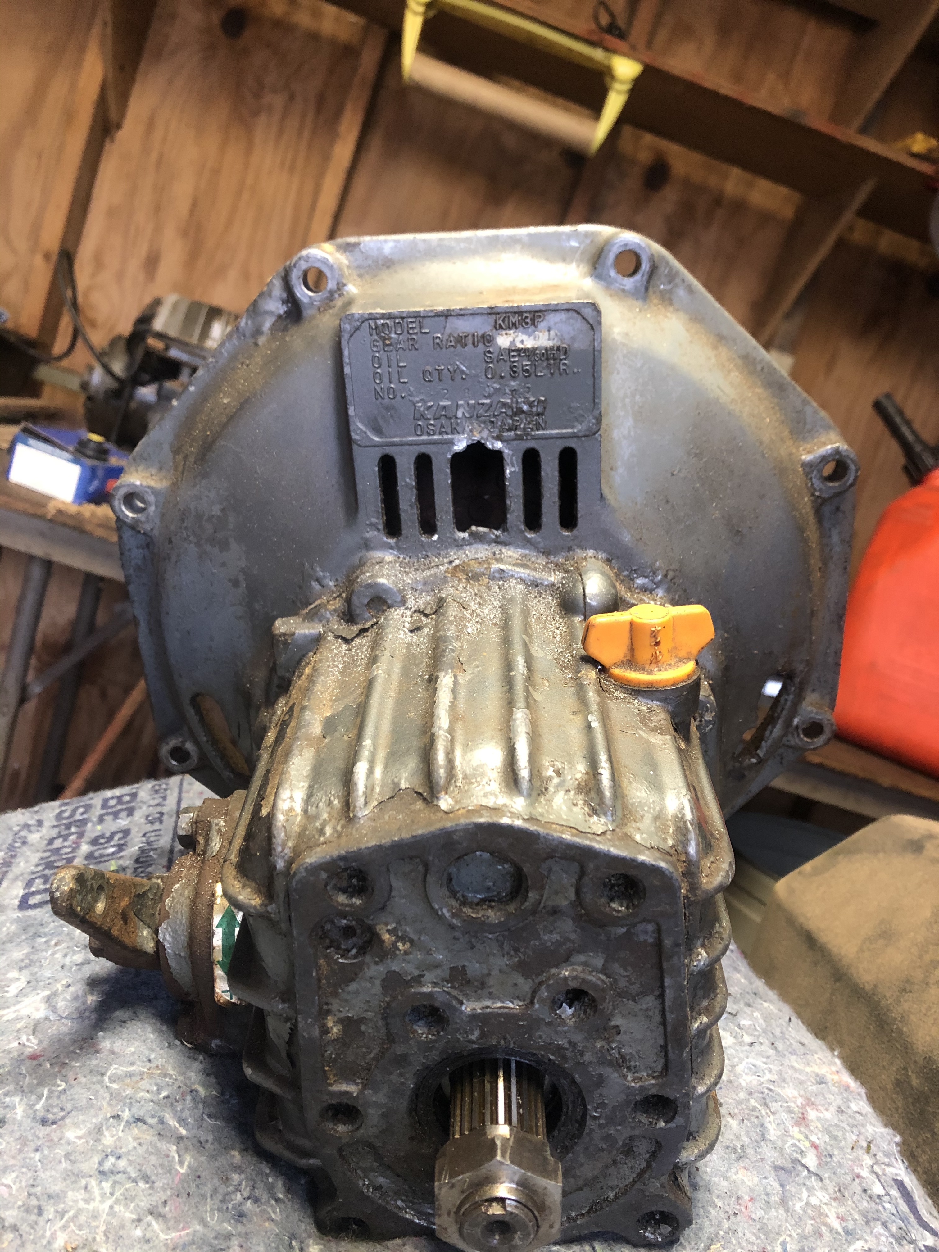

Success.
Success !
Thanks to everyone who posted.
I knocked out the teeth and was able to remove the transmission exactly like the pictures above. The tranmission rod was fused into the Damper Plate and would never have come off…
