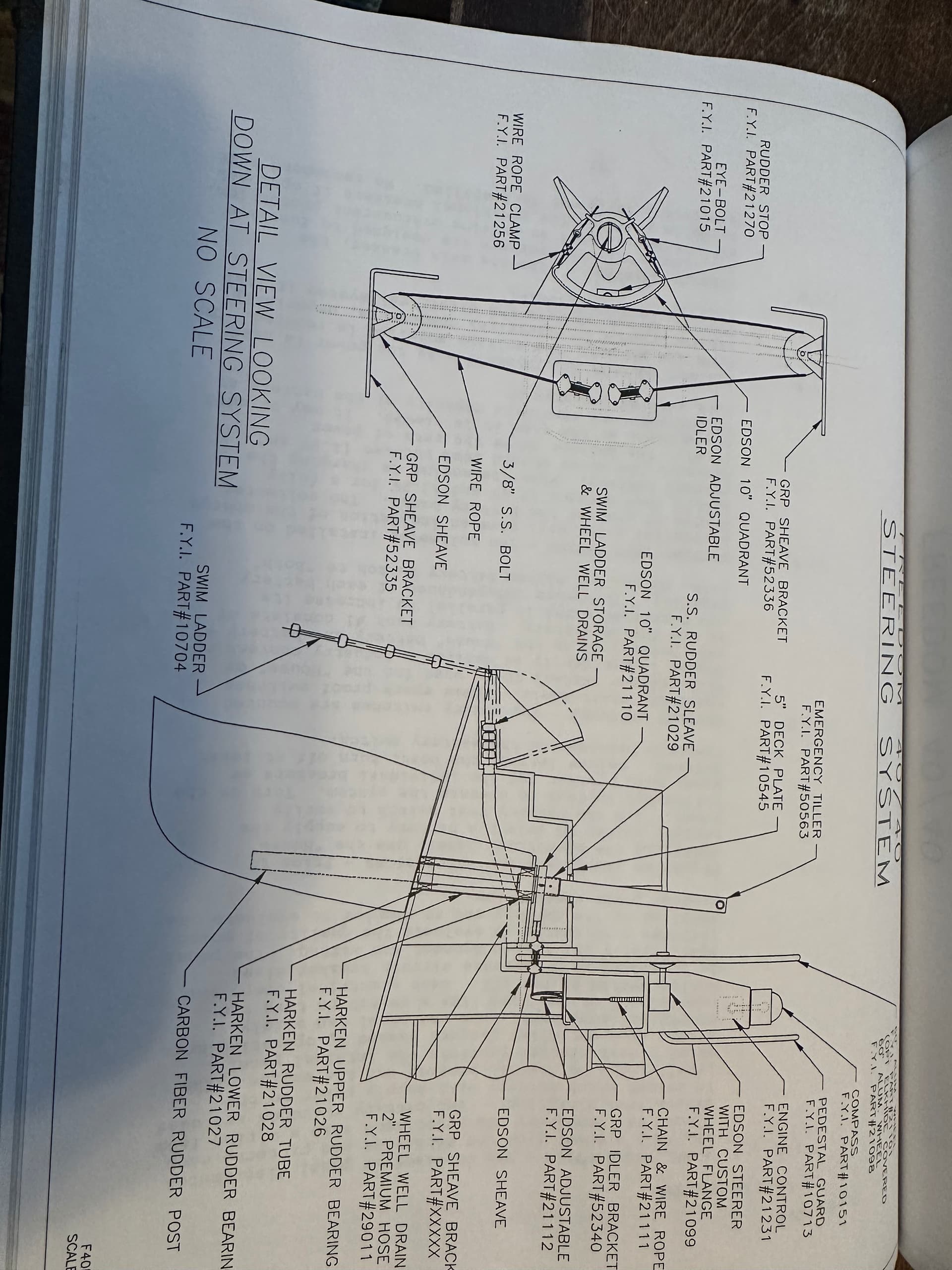

When I hauled my 40/40 this fall I noticed that my rudder had been giving the boat a belly scratch. I have been going through how this can be adjusted by looking at the drawings in the manual and am not sure how one would address this problem.

There are supposed to be 2 screws with rollers that are drilled into the rudderstock that ride along the bearing. These may have worked themselves out, and allowed it to ride up.
Ahh ok. Do i have to drop the rudder to get eyes on where the screws need to be? I must admit that i have not gone down into the lazorette yet. Its great motivation to go on a diet.
Yes, you do have to drop the rudder. I’m in South Africa, getting my new boat ready to sail back to the US, so I don’t have access to my rudder photos. Sorry!
