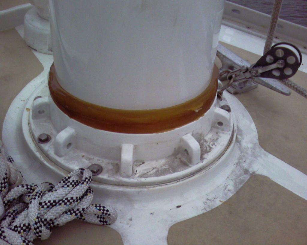

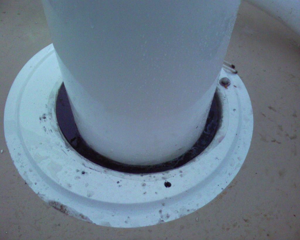

In stead of a mast collar of fabric, you could also use Spartite or similar unbranded liquid two part poly urethane resins. Here’s my solution to a watertight seal at the deck:
I have a Spartite mast collar and it still leaks. Hence the fabric collar too.
Geoff,
Perhaps that is because Spartite is a bit softer (Durometer Shore 50-60A) than the PU I used (Durometer Shore 90A) and gets compressed by the sideways forces on the mast and gets torn away from the deck edge on the opposite side.
I also made the mast wedges of the same durometer PU rubber, to prevent movement of the mast:
