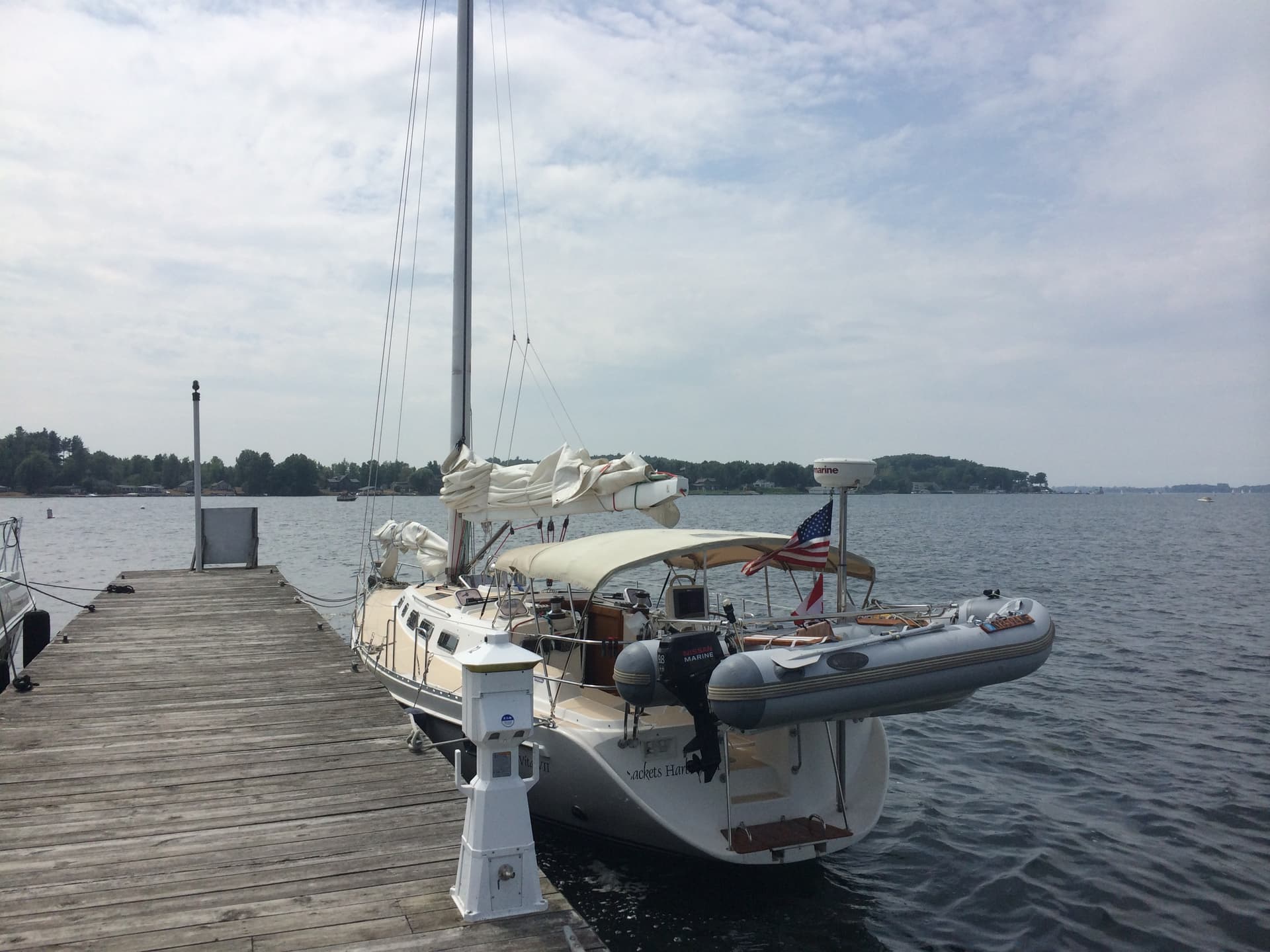

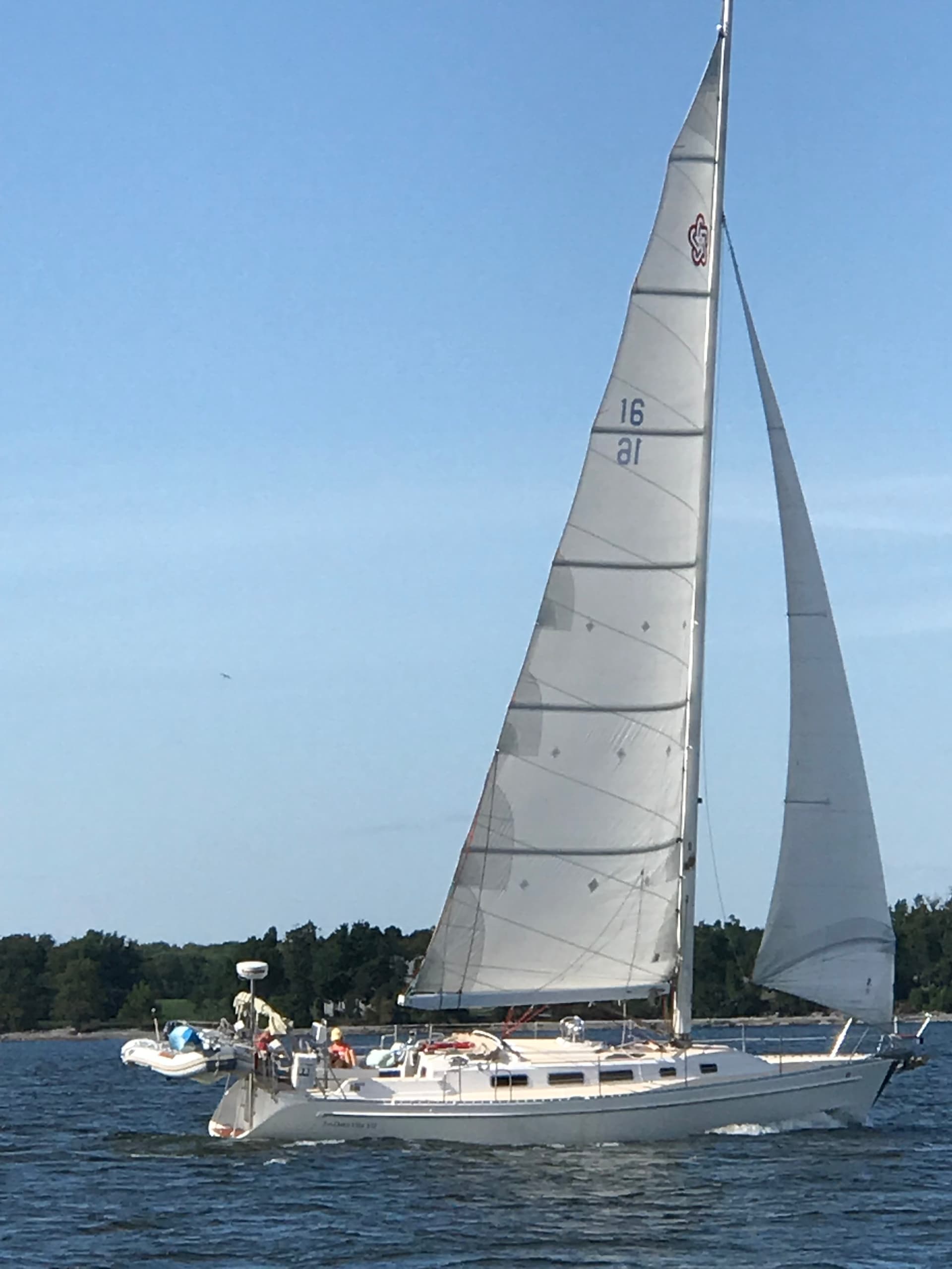

The first change I made when I bought my F 40/40 20 years ago was to add Kato davits. Towing a dinghy is miserable, especially if the weather gets foul or when you’re trying to dock in a tight spot. What do you do in a storm if the dinghy is filling up with water? Risk your life to save a piece of rubber? Do you really want to mount the engine on your rail and have to lower it onto the dinghy every time you want to use it? No matter where you mount the dinghy on board, it will always be in the way and it will be a pain in the neck to launch and retrieve.
Davits are very easy to operate. I find it very convenient to keep my 9.8 hp engine on my 12 foot RIB. I have a power sail winch which I use to raise the dinghy’s stern with the engine, although it is not hard to pull it up by hand. A 5 hp engine is not much lighter than a 9.8. 3hp is very light. Raising and lowering the boat onto the davits is quite easy and it keeps the boat completely out of the way when sailing or motoring.
I have found that rigid fiberglass bottom boats are the best to get. They are much more stable than inflatable soft bottom boats. There is a big difference between a 10 foot and a 12 foot dinghy, but if 12’ is too big for your boat, 10’ is a good tradeoff.
I bought one from WestMarine 20 years ago and just replaced it this year with the same exact model. It was on sale for $2000 and I could not pass it up.
Hypalon is probably best especially if you’re in a southern climate, but PVC can work quite well and his less expensive. Things to look for is what kind of storage compartments might there be? The seating arrangements vary but it is not hard to add a seat. If you’re towing, make sure you have gold rings, attached the right spot on the dinghy otherwise it is easily swamped when towing.

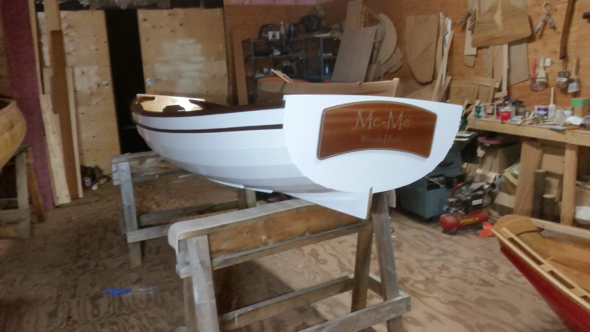

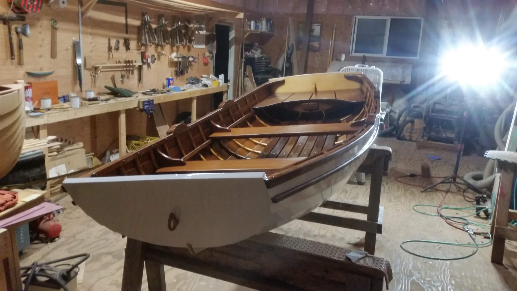

You have raised several good points. The only thing that still puzzles me though is the prevalence of ribs. I have used them recreationally and commercially and the one problem is if your motor fails, they are not great to row as a rule. A 12 foot Herreshoff sailing pram could be rowed or sailed if the motor were to fail. Other than weight savings and cost, I haven’t been convinced that a rib wouldn’t strand me on a beach or leave me drifting
What a gorgeous pram! A treasure. And, nice workshop.
Having said that, my 12’ RIB has served me well for 18 years, until I replaced it this year because of leaky tubes for $2,000 on sale at West Marine. I could probably buy 15 RIBs for the cost of your gorgeous boat. Although my RIB is a solid boat that is easy to row, I would choose your pram over my RIB any day.
I pay for an extra 4’ at my marina because of how the RIB on davits extends the length of my F 40/40 is a 10% surcharge. It is a cost to keep in mind.
Lol not my tender though I wish it was. Have been contemplating getting one built though. I would never tire of looking at it
